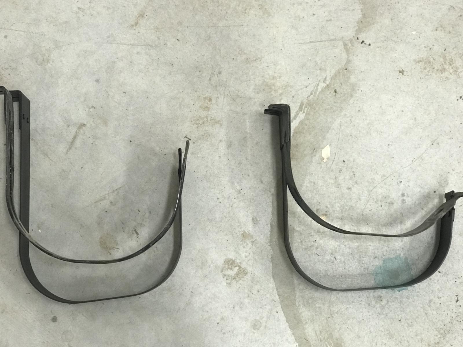

I was wrong earlier, the worst part was getting the front strap in the frame... WOW that was a PITA. I ended up taking a lot of its preformed arc out to make it work. Then it went easy and reshaped itself as I tightened it.

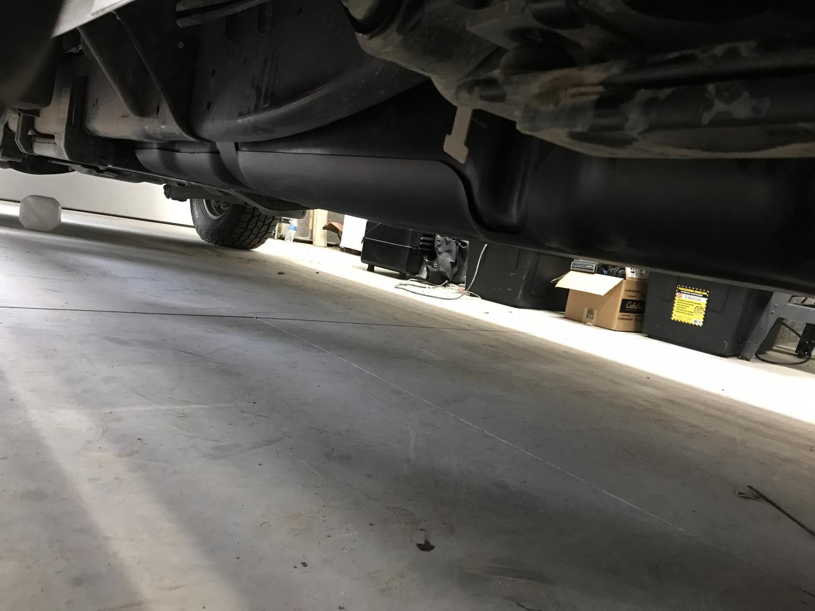

Pics to follow... but my initial measurements are that I lost 3" of ground clearance. I have the skid plate too. The bottom is very flat unlike the stock tank. It's not the lowest thing on the truck. The exhaust is lower, as are the running boards. Looking at the truck I was surprised it measured out to 3", I did notice that the left side was a little lower than the right as I just parked and didn't give the air suspension time to adjust... maybe it will bring the drivers side up a touch more.

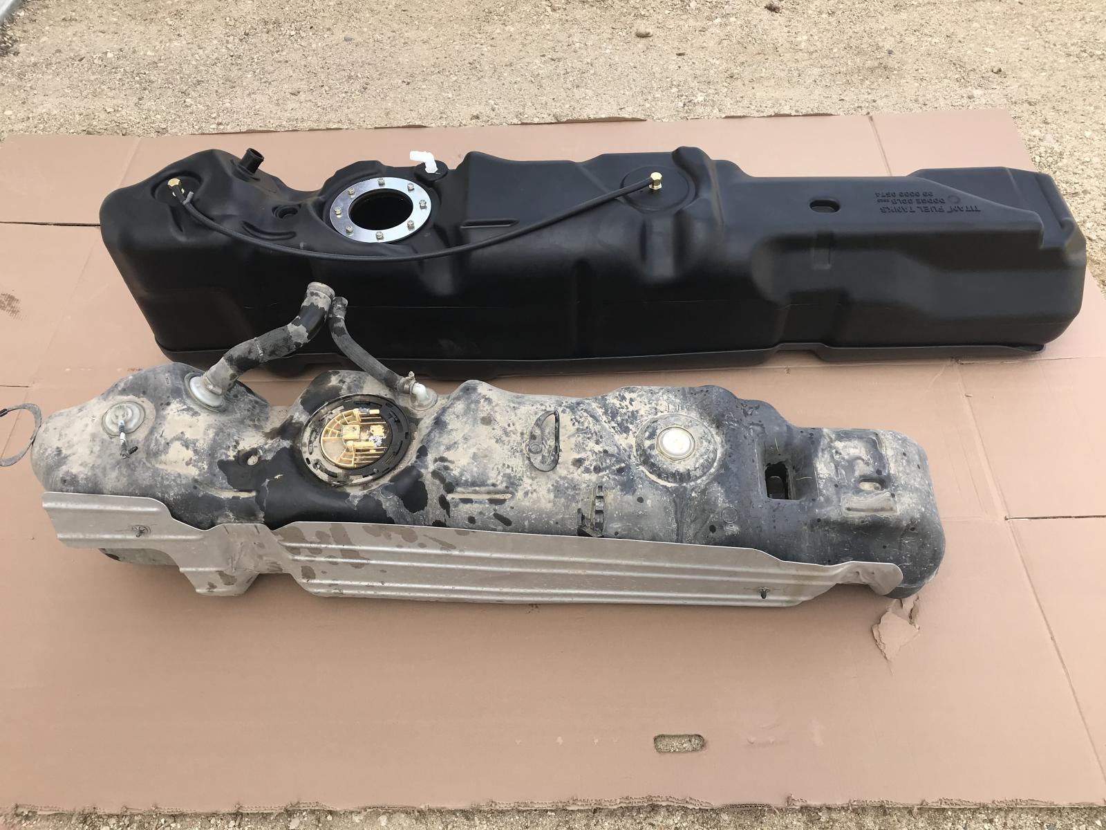

I put 5 gallons in the truck and drove to the local fill station, 1.1 miles. It took 48.375 gallons until it clicked, and then another 3.192 until it was at the filler neck. So I have just over 56 gallons in the truck. I'll take it!
I did fill in 5 gallon increments and monitor tank %age. The sender reads 100% with 45 gallons of fuel in the tank. It reads 50% at about 20 gallons in the tank so it is "top heavy". I should have looked to see how hard it would be to add a longer arm to the OEM float but I didn't.

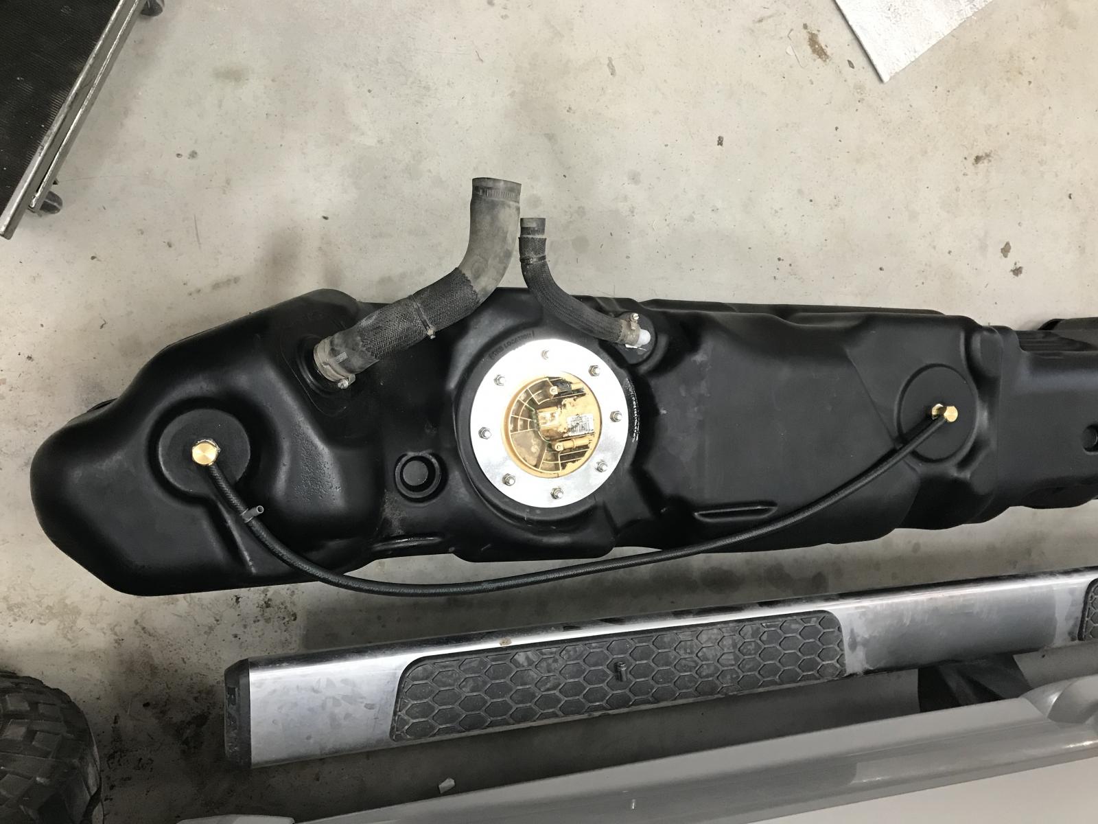

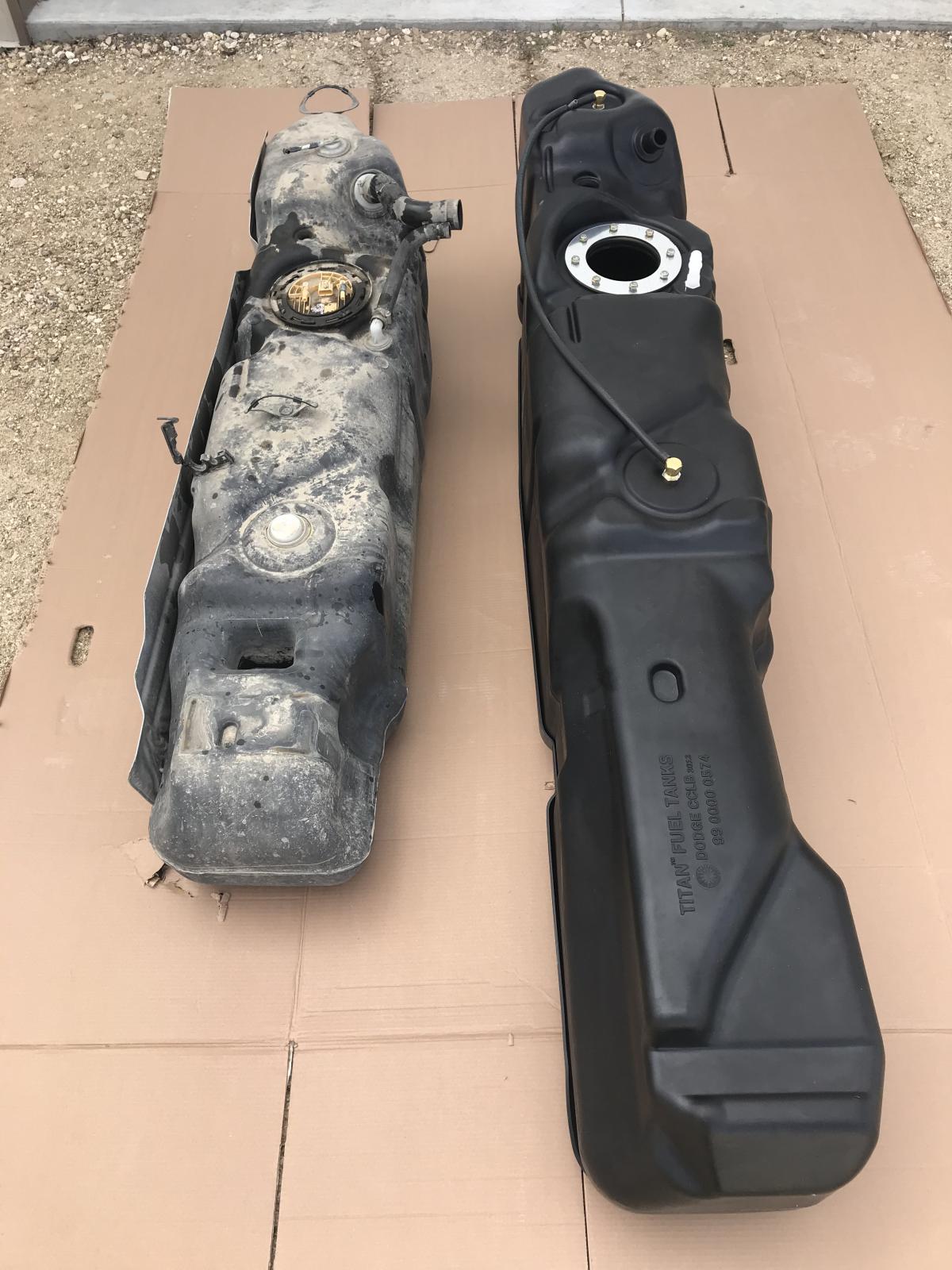

Here are some pics.
