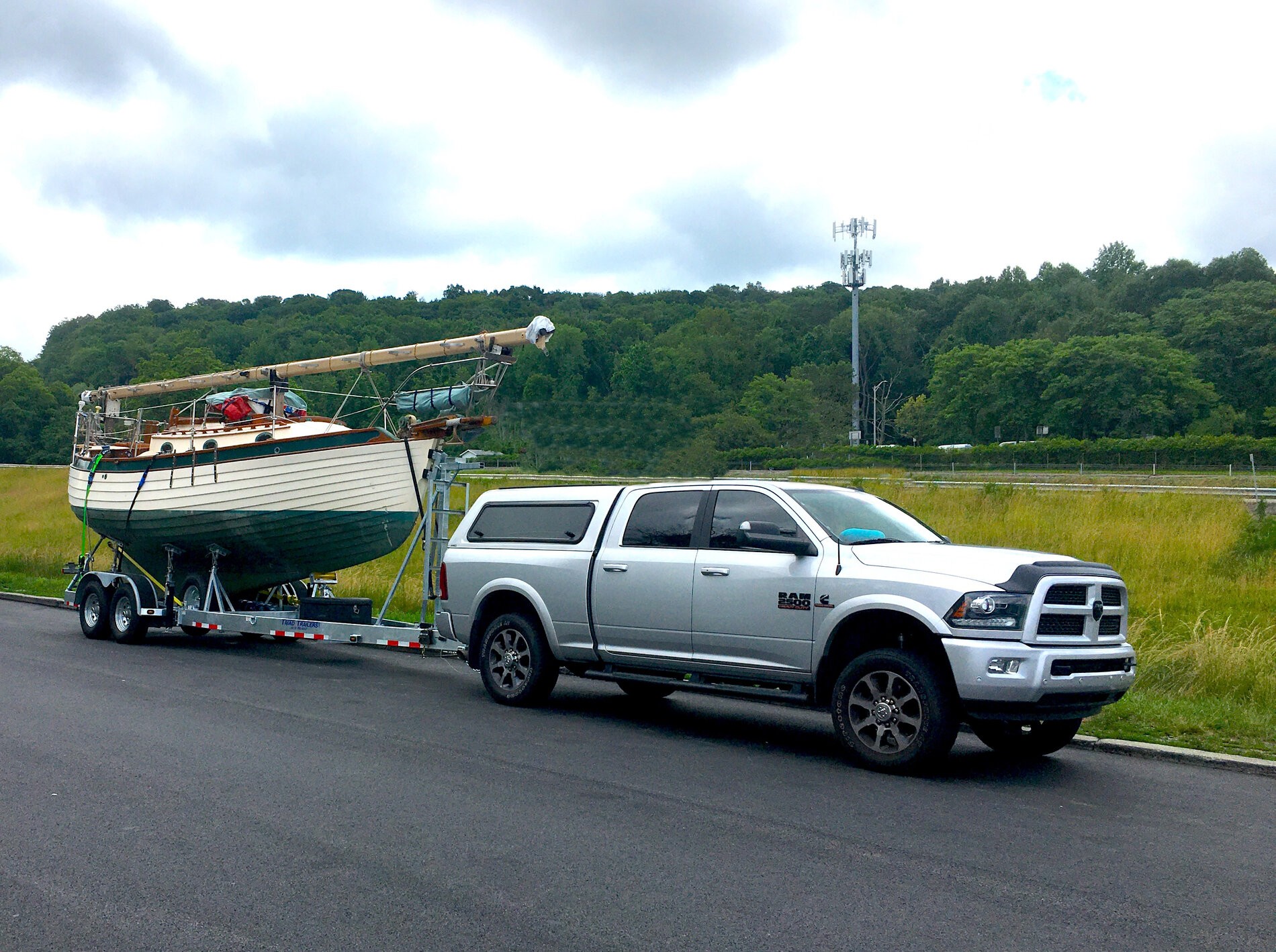

It has been close to two weeks on the road with the new 2017 -2500 and all is going exceedingly well.
I am astounded at the smooth, quiet ride and am even more impressed now that we are towing "The Load!"
As you all predicted, the difference between by '97 5 speed stick and the new 2017 with the 6 speed auto is like night and day. We hooked up to the boat and trailer and off we went---like a shot. I was doing 50 mph before the rig straightened out on the road. 60 to 70 is no problem and the HILLS are non-existent!
I am running about 950 lb tongue weight with the Blue OX weight distrib set up set to 9 links. I started with 8 then moved up to 9. The steering was a bot light at 8 links and 9 was a noticeable improvement in steering. Even my wife noticed the difference. Tomorrow and see how that feels.
The trip out from AZ to Mass----no trailer or tow---we averaged an astounding 22.4 mpg.
The tow is another matter however----so far we average only 10.2. The log book from my 97 is back in AZ so I can not compare the two until I get home.
I was hoping for at least 13/14.
Now I do realize that I am pulling 13,000 lbs and the truck pulls the load so effortlessly I should not complain but on the same run with the 97 I was seeing 12/13 and, truth be told that 97 was working hard on the hills. I reailize now that a 6 or 7 speed would have made a big difference or maybe even a Gear vendors Splitter---which I was seriously thinking about until the truck got totaled.
My technique for towing is as you all suggested---turn on Tow/Haul and let the auto do its thing. I tried turning off Tow/Haul and locking out 6th gear but that didnt improve things.
Air on or off does not seem to make a difference.
I am curious as to what MPG you all are getting and might have some suggestions to slightly improve things.
I guess I should be grateful for all the power and ease.
Suggestions welcomed.
Eddie

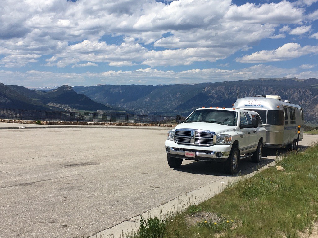

This load is lighter than yours, westbound from Trenton, Texas to Snowflake, AZ, it is uphill, 10.6 mpg. I would say you are fine.
Do you have a front end level kit? If not, you might drop another link on your hitch and pull the rear up a little more.

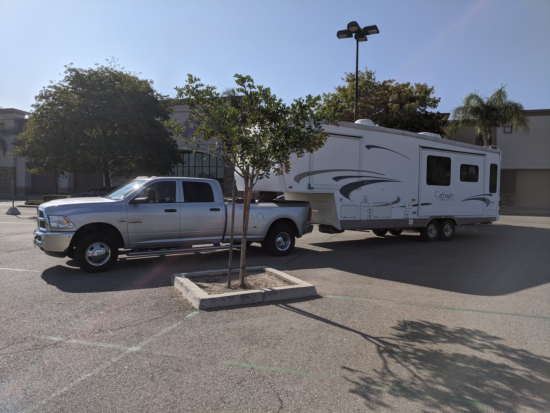

This load is also lighter than yours, 11.71 mpg.

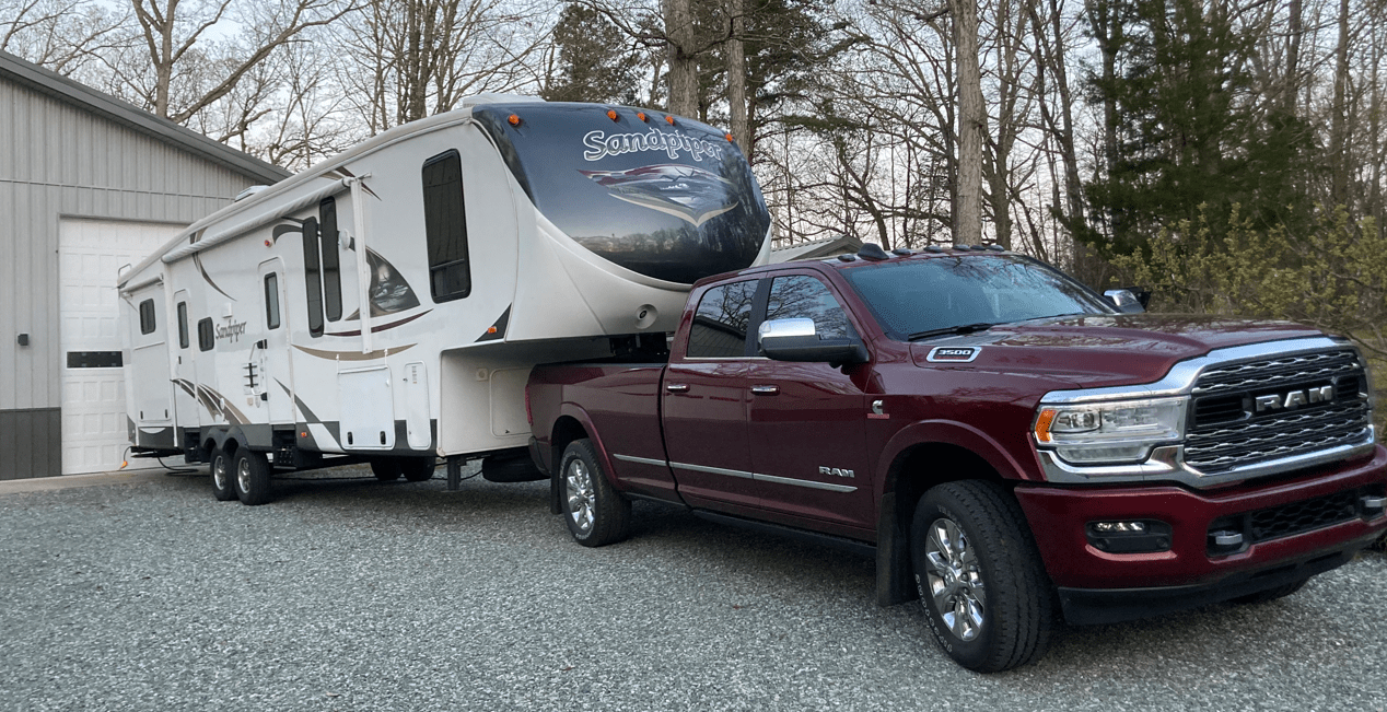

I only pull a 5500 lb travel trailer and average is around 11 calculated depending on terrain and wind.

looks a little nose high, See if you can get the nose a little lower, that will help a lot. and speed.
I think you should work on aerodynamics some. maybe airbags?
you're right in line though.

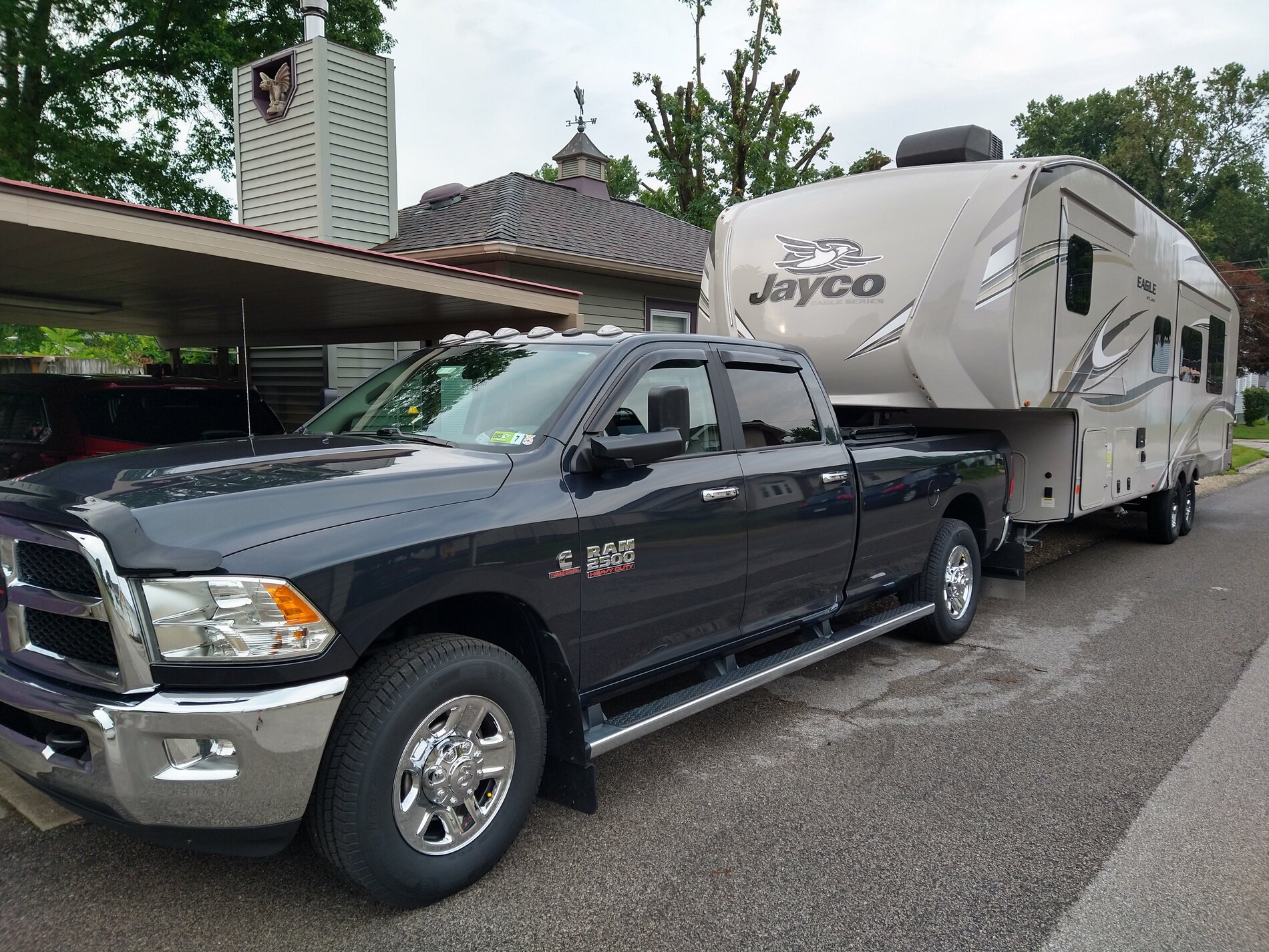

I get 10 - 12mpg pulling this 45' 5er (16k) Worst was 8mpg in WY in wind traveling 75 ish... best was around 12 in TX on 10 (where it was decently flat and I was not going that fast).... With my GN equip trailer and my dump I get around 13ish... DEF is 300mpg worst and usually about 750mpg empty.
