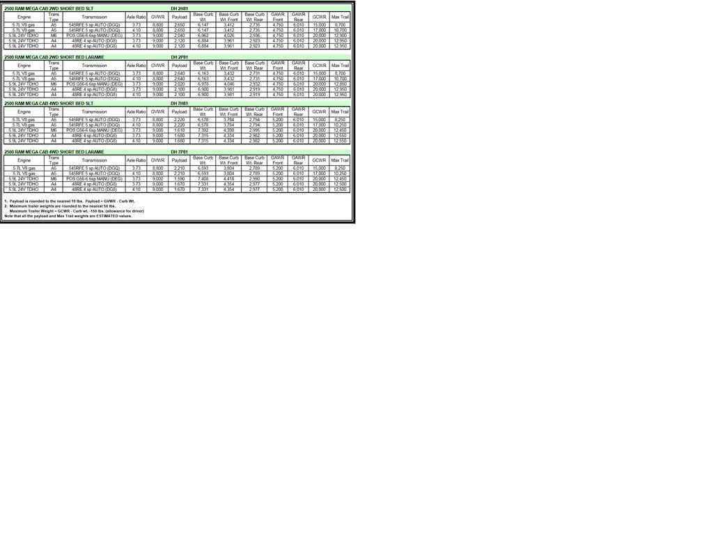

Per my '06 Ram brochure, the 2500 is rated 20k GCW and 12,800 trailer. It shows 3.73 gears as the only option for the 6spd manual.

WKirk, it's there, I just went and looked. Go to the 06 year then truck style then Ram technical information then trailer tow information. Navigation to get where you want to be is tricky. Hope you find it. Let me know, I will try to cut and paste the page if need be.

Once you get to that page scroll down, (there are a bunch of pages) they are all listed: 1500, 2500 and 3500's in every configuration of engine, 2 & 4 wheel drive, long and short bed, trans and dif. There are quite a few pages. The 2500 info is about half way down through all those pages. There are six pages related to the 2500 configurations.

12,400 lbs per trailer life guide. I have the 06 Mega as well (auto) and recall that the pin weight (for a 5th wheel) is rather low though... I am digging around and seeing if I ever downloaded the official towing guide. If I find it I will update this post.
Update: Found more info - payload for the mega was only 1,610lbs for the manual and 1,680 for the auto. Max trailer weight is listed as 12.450lbs

Make up your mind...your first post said quad cab, now it is mega cab...it is heavier so the trailer weight goes down to 12,400, still 20k gcw. Like I said, my info is right out of the Ram Factory 2006 truck brochure, not opinion.
