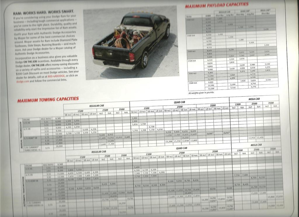

I just looked up the published specs in the 2006 Trailer Life Towing Guide. I have them all the way back to the mid 90's.
For a 2006 2500 Mega Cab 4wd the tow cap. is 12,400 with either manual or auto. Also the gear ratios do not matter. The posted tow cap is the same. On a 3500 there is a difference with manual or auto and gear ratios. It can go from 13,300 to 15,300 depending on the combination. Trailer Life gets there information every year for the manufacture. I just received my booklet for year 2018 a couple of weeks ago. They are a great resource for that info.
Okay, I guess it's time to thank all of you for the help. You have been most patient and informative despite my clumsiness with the terminology and my lack of awareness as to the format of the forum. I have learned that even the "authorities" don't agree. One of the early replies alluded to this.
2500 4WD 5.9L TD 12,400m/a,b/c
a=automatic transmission; b=3.73:1 axle ratio; c=4.10:1 axle ratio; m=manual
transmission. Note:Actual towing capacity may vary (usually by 150 LB or
less, depending on equipment, trim level).

Here is a copy of the tow ratings, the page is larger than my scanner so it is a little blurry. What I find interesting about the specs is that the 3500 was not offered with a manual transmission in '06 or there is a typo.

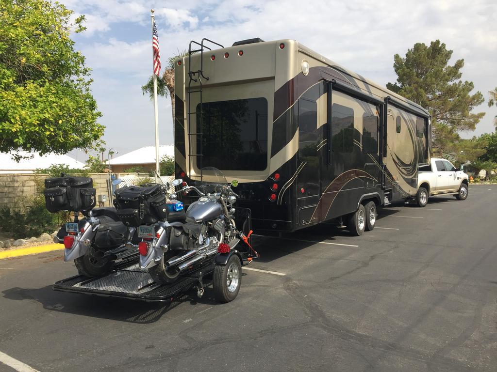

I towed a 19K pound 5th wheel with a similar 2005....5.9, 3500, 6 speed, 3.73, SRW, chipped. The 5.9 is a brute, no surprise here, and it had no problem pulling, or handling in curves or grades...uphill. Downhill was a different story. The first time out, down a loooong 6% grade in AZ, we ran out of brakes....sure the trailer had brakes, but it was asking too much of the Dodge to slow it down, with 19K pounds pushing. We added an exhaust brake and that improved planned slowdowns, like grades....it did nothing for panic stops. Shortly after, we migrated to a single axle Kenworth that had 24" tires. larger brakes... more rubber on the ground, and a 3 stage Jake...towing/stopping/weight problems solved.
Regarding manufacturer stated weight capacity....remember when changing the rear end gearing to a 410, or lower, all that does is change your ability to start easier from a dead stop....it does nothing to increase your load carrying capacity, regardless of all the hype.
Stay with a "reasonable" size RV with a light duty truck....If you want bigger/heavier, go with a MDT/HDT for piece of mind/safety.
