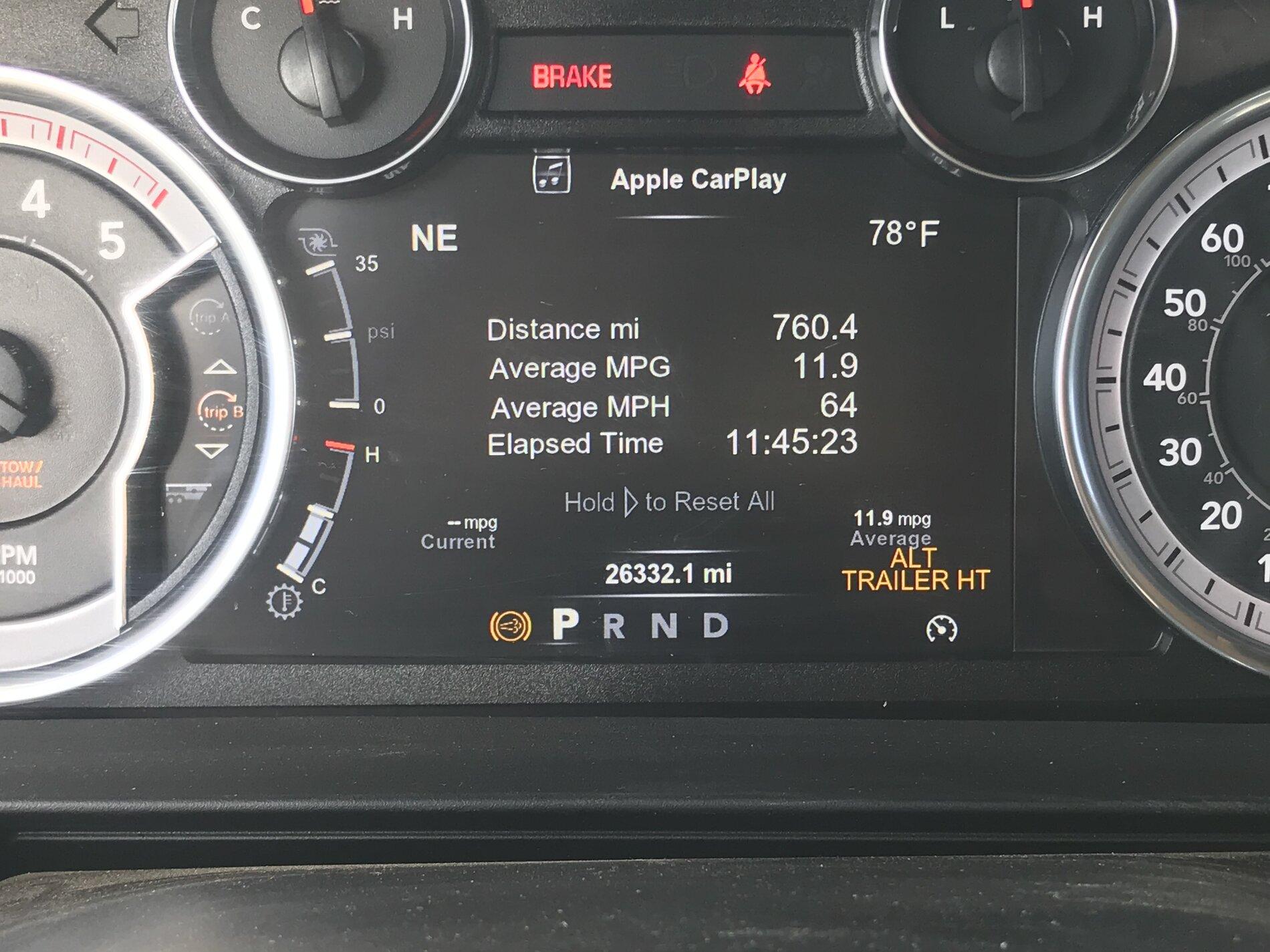

Each Novemberish I do 750 miles in a day with our 16' stock trailer. 1/2 of it has 3 ~1500lb horses in it. Kuna Idaho to Afton Wyoming.
Loaded I am ~17.5K GCW and empty I am ~13K GCW. I've scaled it 3 times and always close with this setup.
I'll run 75 with horses on the interstate and 80 without. 65-70 on the 2 lane highways depending on speed limit and road. A couple of decent pulls in there. The first year with the 05 I ran about 5 mph slower on the interstate (480 of the 750 miles) and got only slightly better mileage. All hand calc'd.
For 2 trips the 2005 got 10.9 and 10.7.
For 2 trips the 2018 got 10.4 and 10.7.
As you can see it's all in the ballpark, and why I don't really complain about the mileage on my 18...aside from under 20mph. I'll even add that the 2005 racked up more miles on those round trips too, so the mileage would be lower using the odo from the 2018.. but only about 2%.
