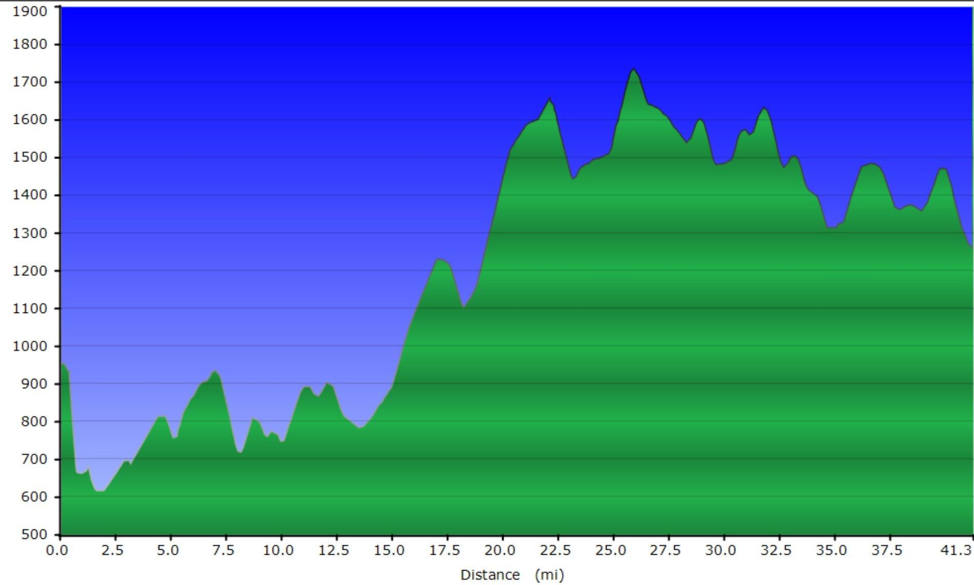

My trailer is not that heavy at 7-8k, but I live in the Ozarks Mts. So not huge pulls, but lots of up and down. I'll paste in a 40 mile stretch of GPS altitude changes below. Anyway, I haul at 77-80mph and get 9.5-10mpg. Which I'm fine with. Much better than the gas 3/4ton I had before my Ram/Cummins, and I could not drive at the same speeds either.
