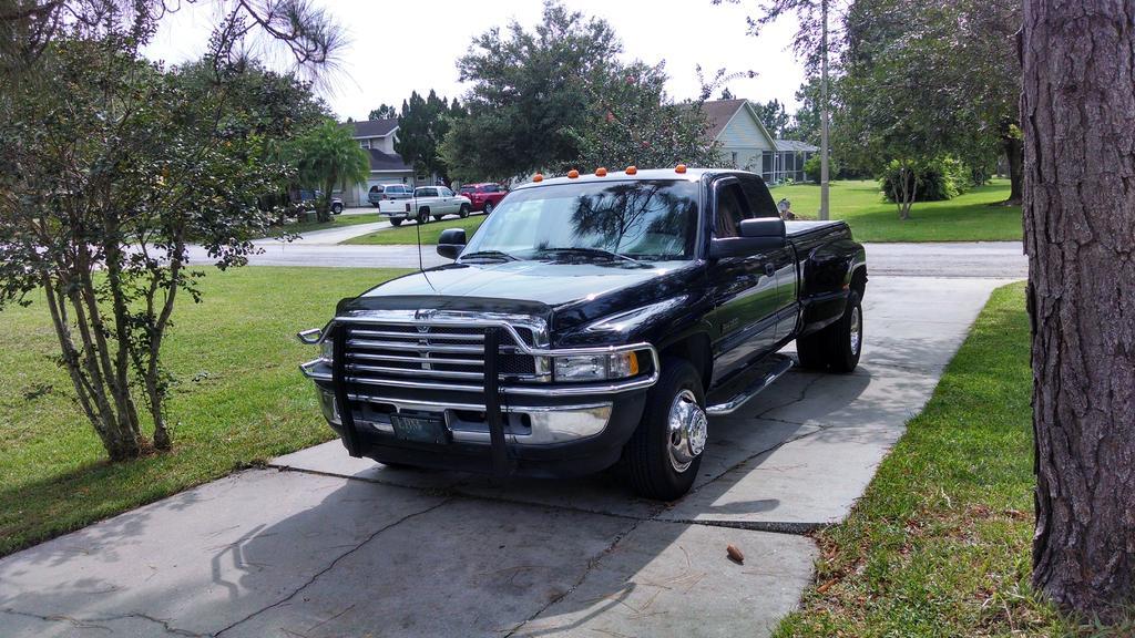

My '95 came with the old style power mirrors which were fine until we got a wider fifth wheel. Back when I added this style of tow mirrors on my 95, I had to buy the 2nd gen manual tow mirrors and also the 3rd gen power tow mirrors and swap the bases so that I could build a set of 2nd gen power/heated tow mirrors. The doors on all of the 2nd gens are all the same, the mirrors will fit provided you order the mirrors with the 2nd gen bases. What may not match up is the electrical. I had to splice my wiring and add a separate circuit for the heat elements. It sure would have been easier to use one of these kits.
