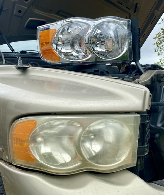

When in 2012 I bought the first set the OEM were nine years old. Somewhat worse than what’s seen above. Dealer replacements were $339/ea at that time.

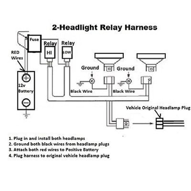

Investigated trying a relay-drive harness with upsized wiring , but it wasn’t possible without modification plus that output voltage was still about right (OEM wiring okay).

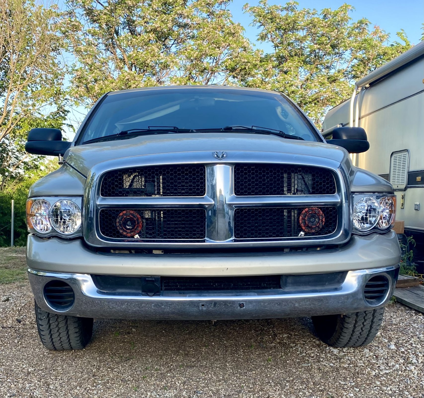

Adding supplemental been on a list a long while. Metro areas have enough street lighting I haven’t yet made it a priority, and that annual miles are extra-low. So, sorta glad I’ve held off as LED has come along to hopefully help remedy that in the future.

Cheap assemblies improves what’s needed as to appearance and OEM-level performance as even Factory isn’t much good. $100 every so often, then, plus new lamps (dim as they age).
