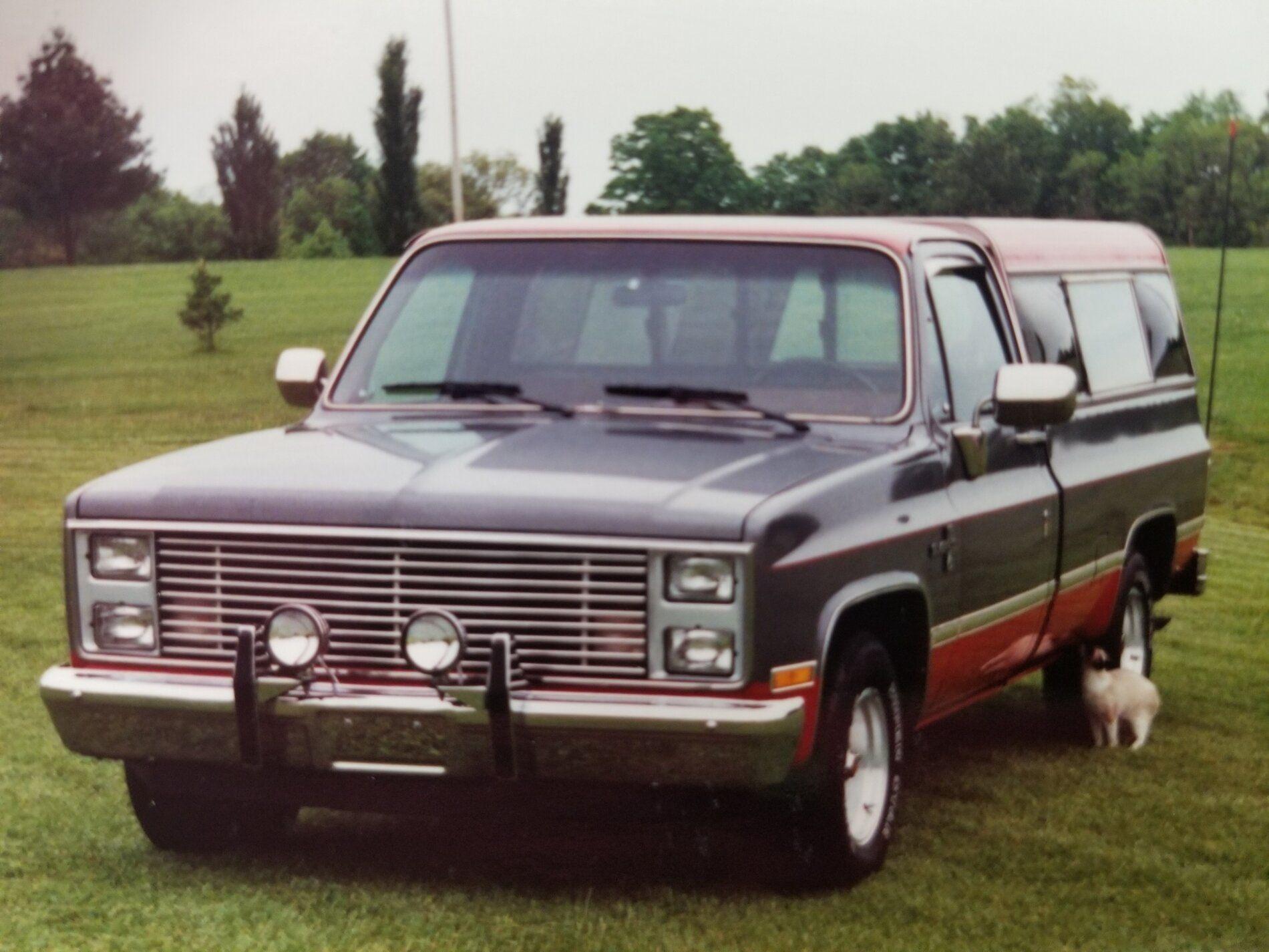

Way back when LED’s were only red and found in Texas Instrument digital watches, I had a set of KC lights mounted on my ‘86 Chevy. Those were some bright dudes, WAY too bright for oncoming traffic, unless I met someone that wouldn’t dim their too bright lights...:mad:
Anyway, I had them wired through a main On/Off switch and then through a 3-way switch which determined if they were on by themselves, with the high beams, or anytime the running lights were on.
