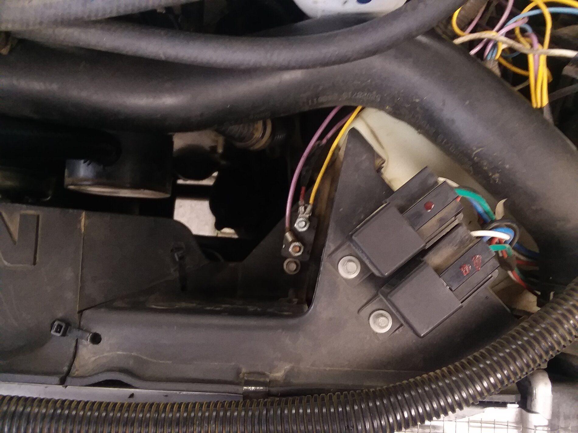

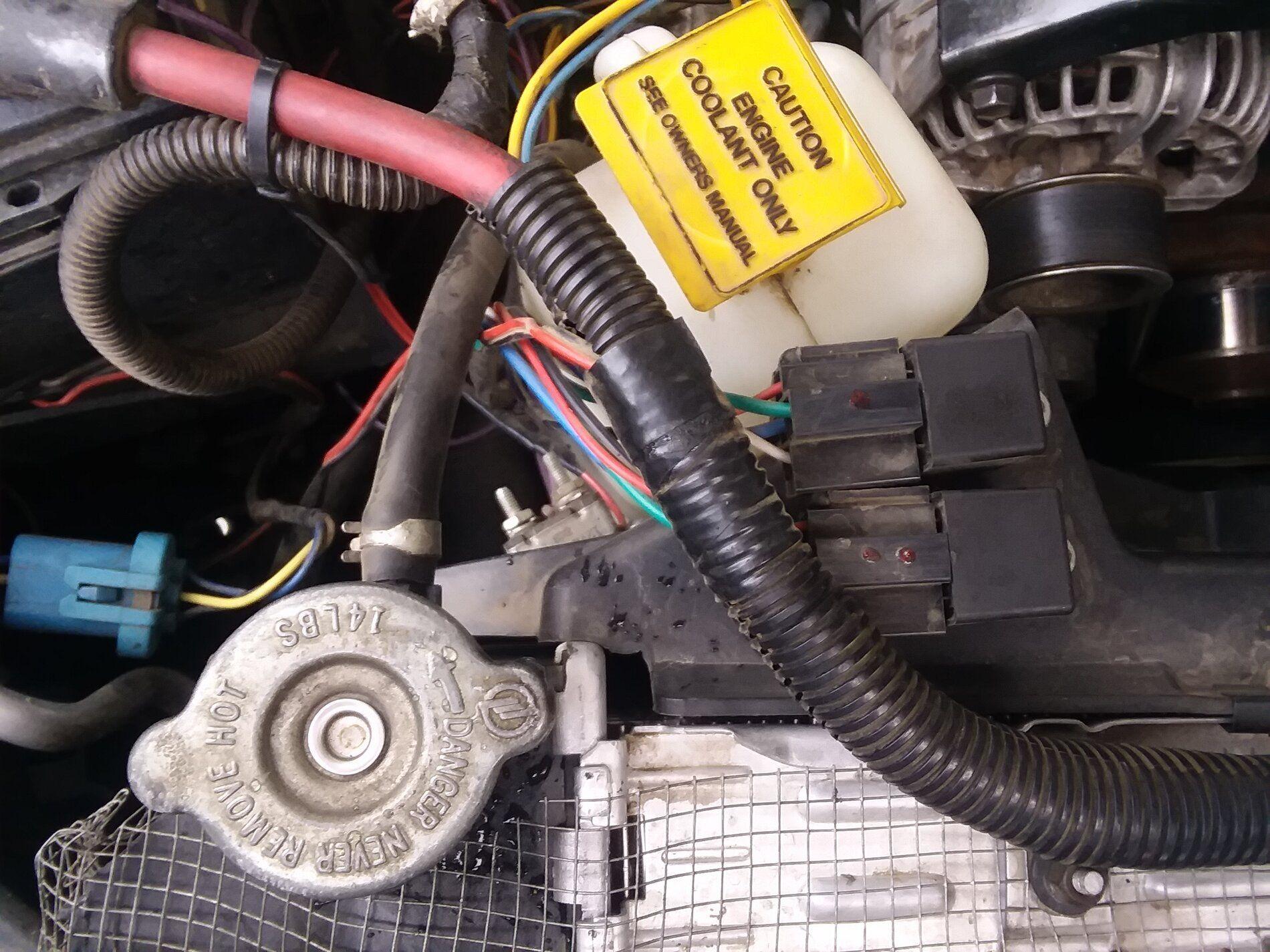

I made my own relays setup and I used four relays (two per side, fused with a cyclic circuit breaker separately). You can see the relays and their respective circuit breakers in the photos. The dots on the relays represent low and high beam. The circuit breakers are mounted on the fan shroud in a protected area below the relays.
Passenger side
Driver side
