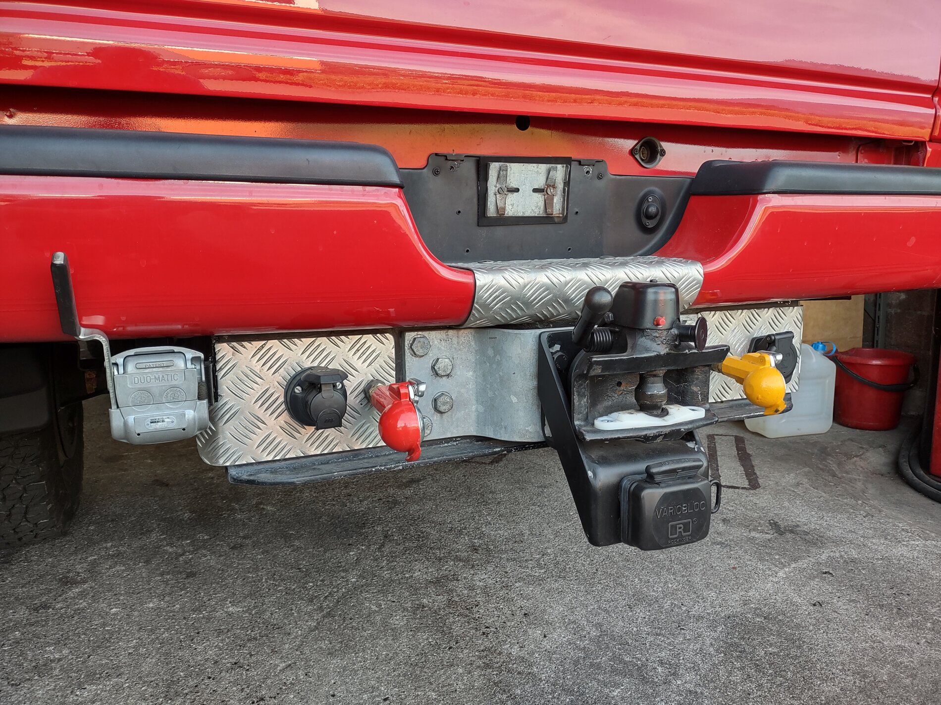

My buddy has the same vehicle and that weight all the time as in Switzerland it is rated for 20'000lbs bumper pull trailers
And yes we have mountains.
So, you should be good.

Pretty normal in Switzerland though, the importer of the vehicle can set the tow rating and has to prove this physically to our DOT.
So the hitch is much different, also the subframe assembly is much much stronger.
The new ones have about 34k bumper pull rating.
We do not have fifth wheel on pickups as that would need a different drivers license and several other legal adjustments that makes them very unattractive.
