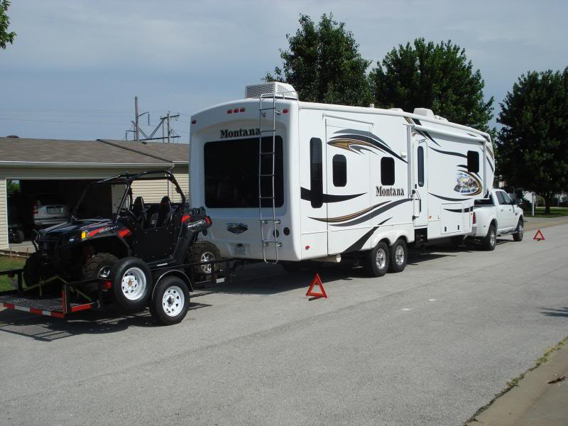

I am going to chime in here. I have been retired for close to 20 years. A old guy. The tow ratings mean nothing when you are talking about 5th's. A 2500 with a 3.42 and it can tow a 17K 5th. OK...... My '12 DRW has a 3.73 and I can run in 6th all day @ 65mpg/1650rpm's, There is no way I would want a 3.42 to tow with, unless it was a bass boat.
A normal 5th loaded properly will have 20-25% of it's total weight on the pin. A 17K 5th @ 20% is 3,400lbs on the pin. Figure fuel, (in my case 96 gal @ 7lb 672 lbs of full fuel) 150-200lb hitch, 2 folks 400lbs, plus tools/stuff and you will probably find you are over gross on either the rear axle GAWR or the truck GVWR.
A 2500/3500 truck will weigh close to 7500/8000lbs. Add folks, fuel, hitch, yes it will pull it, but should you ever be scaled, ????? I am 12,200+ loaded.
I am about 66.5' long, all axles are within the weight limits. Going across Kansas in 100 degree temps and your SRW truck is @ 100% of tire loading, Nope, not for me. I only have to run 55-60psi in the rear duals to carry the weight.
