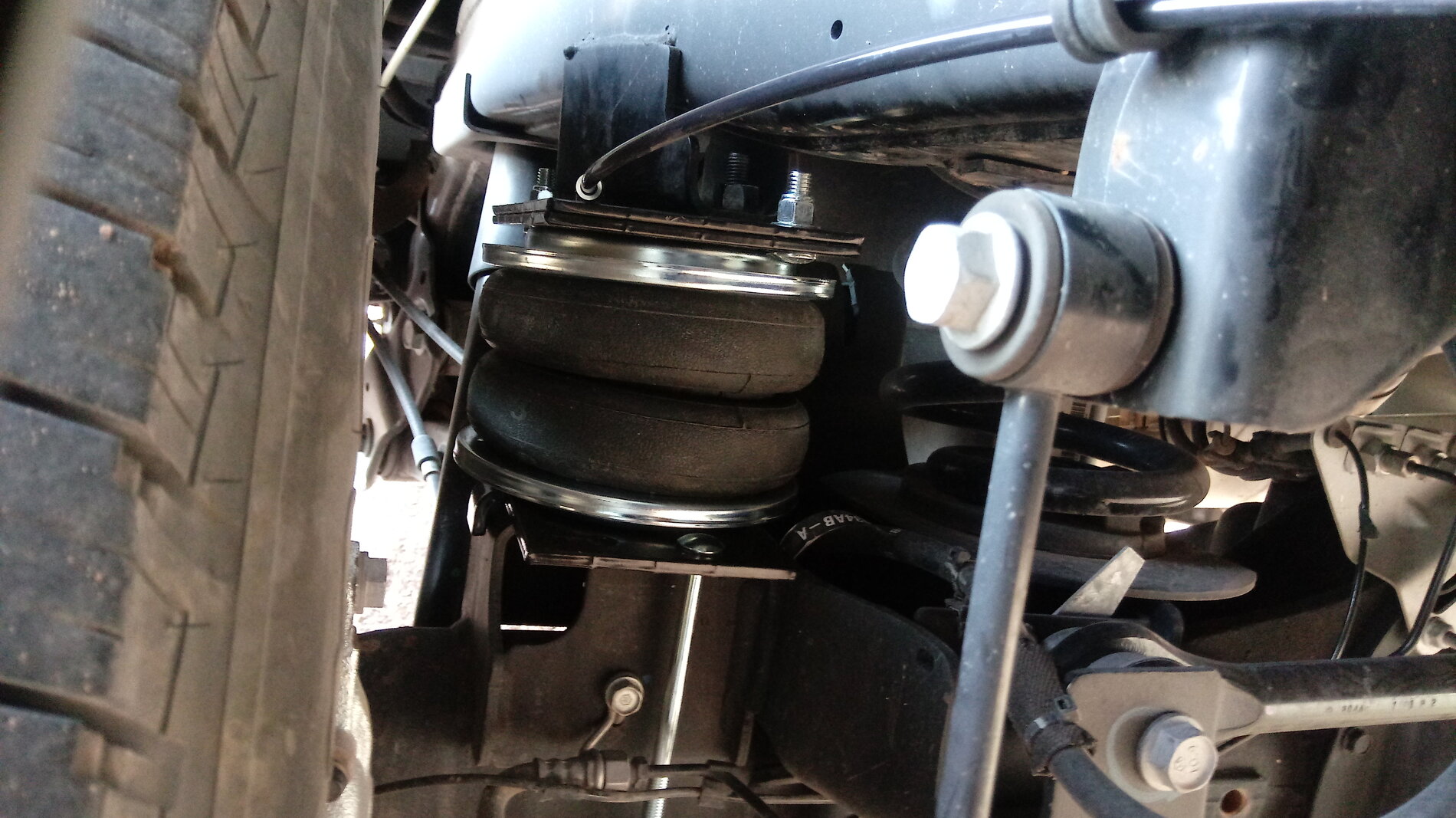

Firestone Air Bags

Nice set of trucks and RV's. 26k is perfect for a 2500, that's my go to weight. It might be an optical illusion, but it seems the rear of the truck is higher than the front. Maybe too much air in the bags? Standin on the corner is cool....
You might be right, I try to keep the truck sitting at the stock Hight. I also let the air out of the bags when we stop for the night and have to manly fill them every day. I need an onboard compressor! This picture I had 50 lbs in the bags, and since I would be driving in the dark, I don't have any issue with the headlights hitting the ground. But at 40 pounds she's level.
You may have to play with the coil springs a little, as they will react a little different than leaf springs, but I have found that you want to allow the OEM springs to compress at least 1-1.5" underload to ensure they have enough weight on them. This will improve ride and handling.
Why do you let the air out at night?
Depending where we stop trying to get the rig somewhat level. I have a level mate pro on the rig so if I am lucky to have a enough space I can usually get is close to level but other times its easier to let some air out. Thanks for the coil spring tip I will do that next time and try it out.
That makes sense, I will also deflate the OEM bags on my truck if it helps with leveling the camper... otherwise I keep the air in the bags as it keeps the bulk of the weight off the metal springs.
