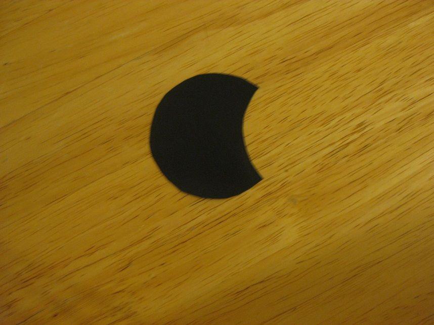

I did this, it hides the TPMS light and the headlight on light. I used 10 Mil Pipe Wrap Tape.
