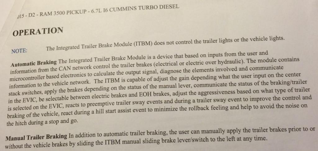

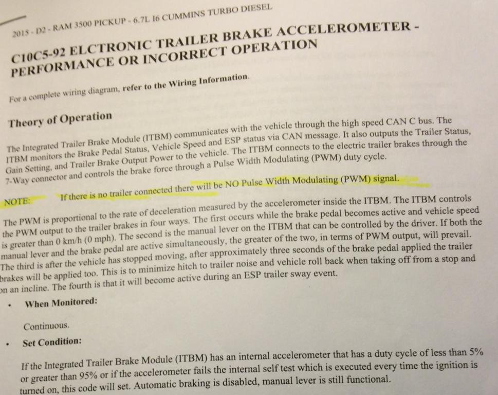

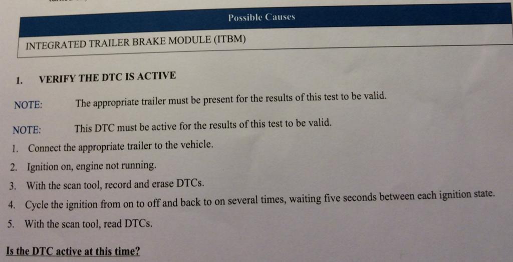

Snoking , if you supply me with an email address I can send you what the dealer gave to me about these brake controllers. They gave me a print out from "Star" their info site that Ram uses for info. -- email address removed -- I have a 2015 Ram 3500. Roger

Reading what Roger sent me. I have to modify something I said above. The brake controller can see a problem, and shutdown and not work, however the manual level still functions to apply the trailer brakes. So if you get good brakes with the manual lever and not the pedal, then the ITBM might be seeing a problem and shutting down as noted in the Star document. SNOKING

Here is the print out that RMaynard is referring to. This is also an experiment in posting files! :confused:
