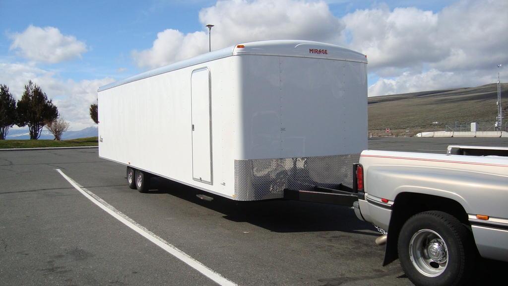

So tell me, since you are the subject matter expert, it seems. What hitch would you recommend for a construction trailer I recently pulled. I encountered cross winds, large trucks passing me, both on the free way and on two lane roads. I had to avoid a moron that cut in front of me and slammed on his brakes in Dallas on the I635 loop. Pretty much the gamut of things the "sway control" purveyors claim the magic hitch will control. Remember, I can't do any cutting, welding or drilling, so the hitch has to be transportable.
Edit; One other thing, the trailer was empty, so it was a big sail in the wind.
