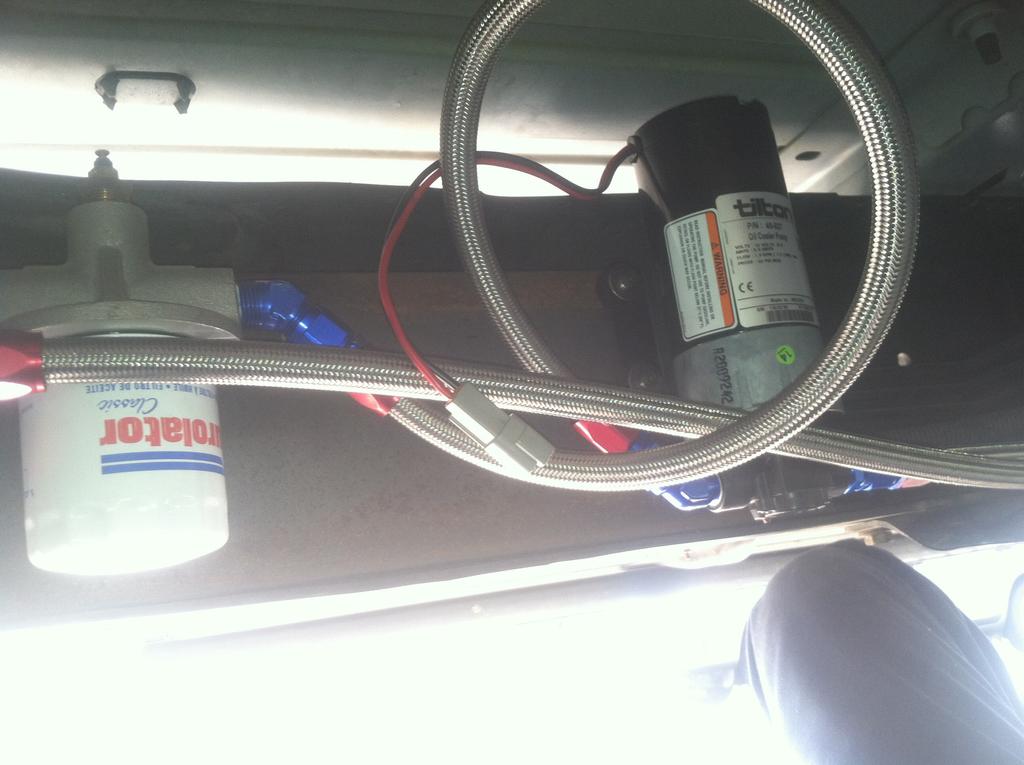

If you (OP) have a manual trans? You might want to concider this, see pics.
That is a nice setup. Can you provide a parts list? How often do you change the filter? Do you have it temp controlled or does it run constantly?
Jeff

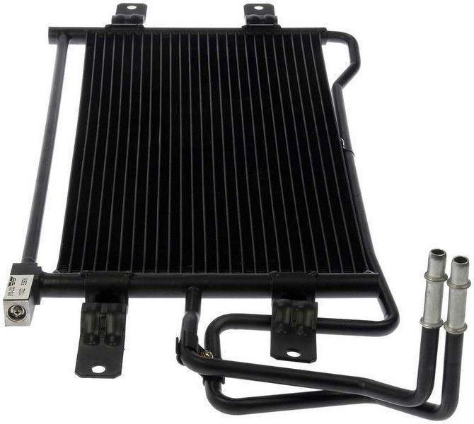

The picture shows most of the parts used, the heat exchanger (cooler) is an OEM cooler for a 3rd gen with an automatic and will fit the 03 thru 09 trucks. The radiators used, are the same for both auto and manual equipped trucks, so it fits on the manual equiped trucks radiator. I acquired the quick disconnects fittings (don't have a part number) and modified them to thread into a 3/8 NPT coupling so it is like an auto equipped truck and can easily replace it if it leaks. The fittings are Russell AN type fittings and the hose is stainless braided from Russell as well, as you can see in the picture. The pump/motor is a Tilton pump that is rated for continuous duty. The filter housing I can't remember, but if you send me a PM I'll look it all up for you. What you don't see, are the coolers I bought from Geno's Garage that are attached to the PTO outlets and tapped them at the bottom to connect the AN fittings.

I keep an eye on temps and turn on the pump when I see it gets close to 170*F, the cooler has a thermo bypass which helps keep it at the proper temperature. It is for an automatic, that pumps oil continuously and the coolers Thermo bypass diverts the oil around the cooler allowing them to warm up to 180*F, then fully closes the bypass. I haven't changed the filter yet but I've only got 1000 miles on the setup. With the pump running my trans runs at around 150* to 180* depending on ambient temps. I'm not the first member to do this on TDR, but I improved on the system.
