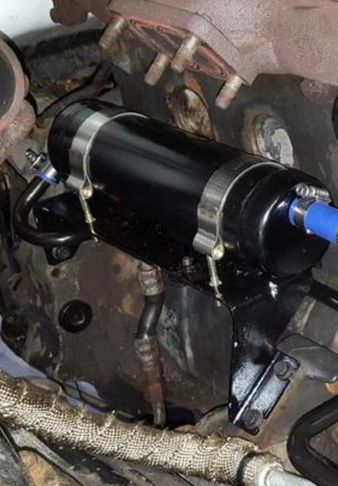

I will need to do a good washdown of the underside and a refill/start/engage to track down the leak, but at a quick glance, it seems to be a special quick disconnect line that comes out of the trans heat exchanger cylinder style "tank" under the exhaust manifold.
I had to replace that heat exchanger a while back when i was doing some major other work and restoration.
I remember trying to find a set of trans lines and that special quick disconnect used there at that heat exchanger but had no luck.

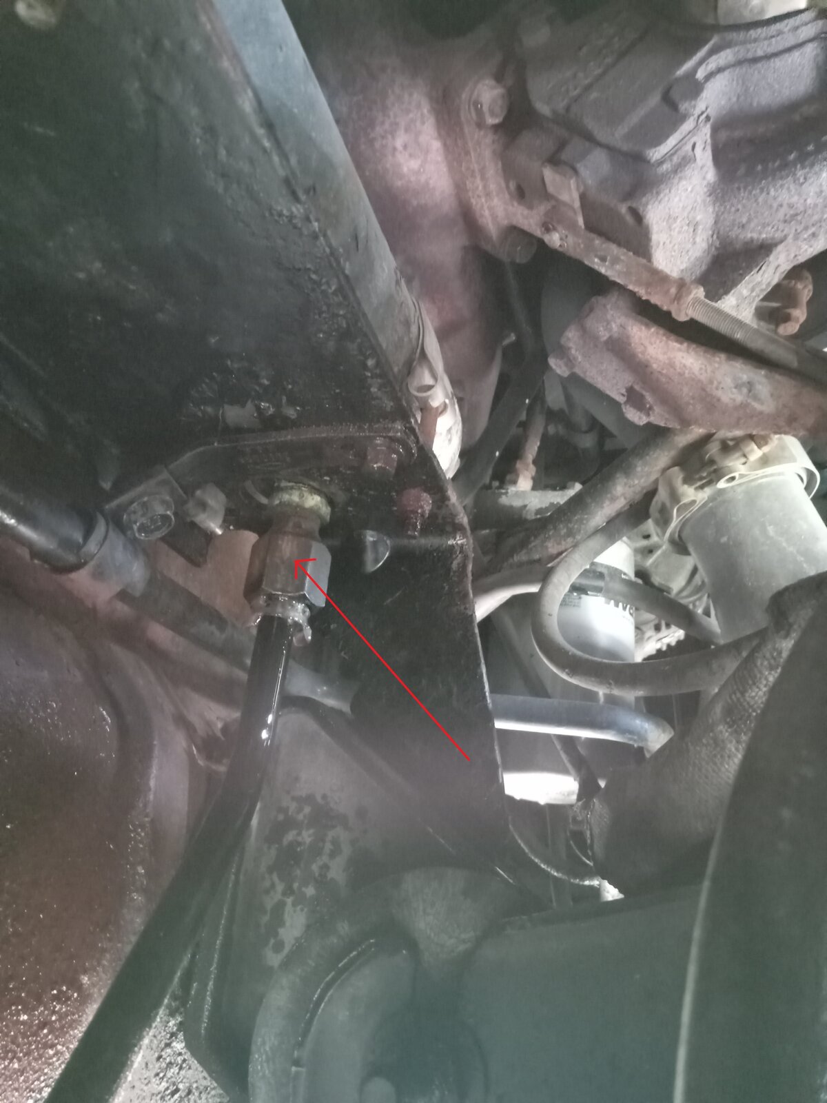

i degreased and refilled fluid....started truck put in drive.
after fluid circulated, trans engaged in drive/reverse ok, and no leaks.
with truck running in park, i ever so gently touched the oil line on the heat exchanger with that darn quick disconnect and wham! high pressure leak!. touched it again...leak gone. what a cheesy connector to place in a hard to access location.

i'm attaching a photo of the subject connector
With more searching (this time using different keywords, and the help of a friend),
I found a exact replacement for the disconnect....it is Dorman part number 800-701.
I really didn't want to cut the line and retrofit a different fitting in there, at least not until the line needed replacement

I hear you! Well, Just installed the connector. Good fit, sealed up nice.
But, from me handling the steel line, now have a new pinhole leak in that steel line. darn.
