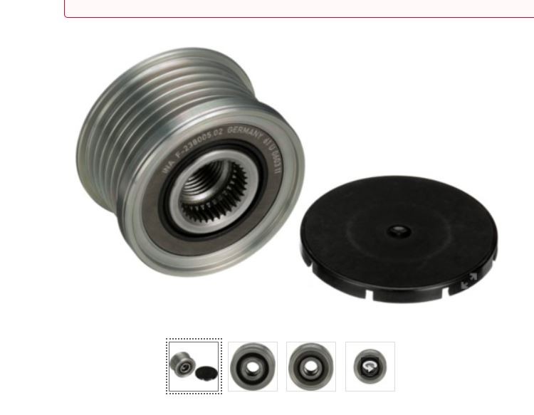

It could be possible that a belt chirp is occurring. IF your alternator uses a decoupler pulley (which I think it does), then the pulley may have failed. My experience has been that when a decoupler pulley fails, it usually locks up - thus behaving like a solid pulley, which COULD cause belt chirp during a firm transmission upshift. If the decoupler pulley is working properly, then there would be no belt chirp.
The photo below shows what an alternator decoupler pulley may look like for a 2013 Ram.
- John

John, I didnt even know of such a thing as a decoupler!! it looks ok but ---? Hopefully that's it cause the noise is on the pass side. As long as things dont escalate !
dan
