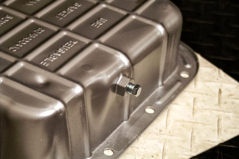

I recently had good service from Cascade Transmissions. Received the Borg Warner solenoid in less than a week along with a new 3-4 accumulator spring. Serviced my 48RE transmission and transfer case the first time at 20K miles, when I purchased the drain plug kit from Geno's and put. I continued to service it every 25K after that. At 45K miles, I started using Amsoil ATF. The drain plug makes it so easy to remove the night before I am going to work on it, and let it drain out. I usually do the same for the transfer case.

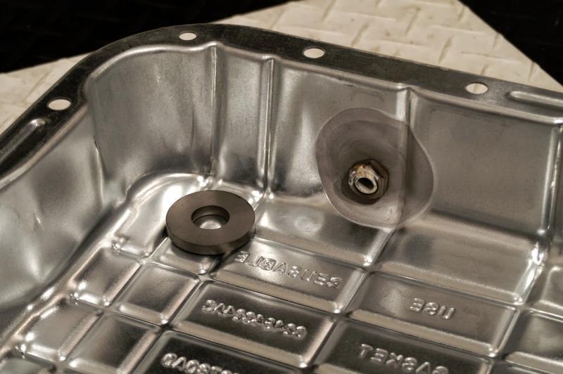

I silver soldered the hollow plug and nut to the transmission pan so nothing will ever get loose. I still support the removal of the 1/8" pipe plug by putting a wrench on the larger hex before attempting to loosen the pipe plug.

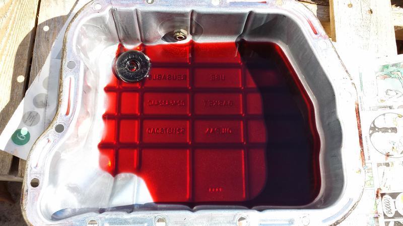

Here's what the inside of my pan looked like at 95K miles. The pan and fluid still looked clean, the magnet had a very slight gray slime on it, and the filter inlet was still quite clean even after towing my PJ 18' tilt and United box trailers. The two times I have serviced it after it had the Amsoil ATF in it, there was much less gray film on everything, and I have not had to wash out the pan. A simple wipe out with a rag and reinstall it! Best of all, when rechecking the band adjustments, they have not changed. I take note of where the adjustment screws are, then using my Snap-On digital tech wrench, I torque the screws to exactly 72 lbs. in of torque. Backing the screws out the proper number of turns, I look at the adjusting screw marks, and they are in exactly the same place! Perfect! No band adjustment change in 50K miles! I am both pleased and amazed!

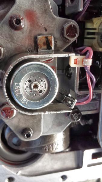

This is a picture of the Borg Warner Solenoid installed in the valve body, replacing the smaller one from Mopar. It fit perfectly, and at the same time I replaced the Mopar pressure transducer. I understand why it a good thing to replace both of these about every 50K miles as I was just beginning to experience what I call "confusion shifting" again. Here's what mine feels like when it does this. When letting off the throttle to coast around the curve on an interstate cloverleaf entrance ramp, slowing down around 23-25mph, then pushing on the throttle for moderate acceleration, the transmission can't decide which gear it should choose. It downshifts to from fourth to second, then down to first for a brief moment, then finally lands back in second and accelerates normally after that. I travel that entrance ramp every morning going to work and it becomes obvious when it occurs. When it begins to act up like this, I now know what is wrong, and now how to remedy it.
This solenoid/transducer change seemed to provide much more positive shifting from 1st to 2nd, and 2nd to third. With the same amount of throttle for normal acceleration as if accelerating in traffic, the vehicle tends to accelerate a bit quicker. The shift points in relation to the vehicle speed seems to be much more consistent than before. 1st to 2nd on level ground (truck only) occurs about 15mph, and 2nd to 3rd occurs at 26-27mph. When very lightly accelerating, as if going down a slight incline, you will hear the engine change tone when it upshifts, but now it changes gears so smoothly, you never feel the upshifts.
