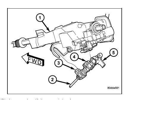

Does anyone have a picture which shows how to adjust this cable under the steering column? I have had the cover off 3 or 4 times to do it, but all the parts are plastic and I'm deathly afraid of breaking some little clippy thing. I just need to tighten the cable which has loosened over time leading to trans and indicator being out of whack...

I can't get the picture to copy. The number 3 they are referring to is the cable release tab. If you can slide under the truck, you don't have to raise it. Chock the wheels in case you move the detent out of park. Sorry I can't get the picture on. The release tab is the white plastic piece with the cable running into it.
ADJUSTMENTS - GEARSHIFT CABLE
Gearshift Adjustment Procedure
1. Shift transmission into PARK.
2. Release cable adjuster lock tab (3) (underneath the
steering column) to unlock cable.
3. Raise vehicle.
4. Disengage the cable eyelet from the transmission
manual shift lever.
5. Verify transmission shift lever is in PARK detent by
moving lever fully rearward. Last rearward detent is
PARK position.
6. Verify positive engagement of transmission park
lock by attempting to rotate propeller shaft. Shaft
will not rotate when park lock is engaged.
7. Snap the cable eyelet onto the transmission manual
shift lever.
8. Lower vehicle.
9. Lock shift cable by pressing cable adjuster lock tab (3) downward until it snaps into place.
10. Check engine starting. Engine should start only in PARK and NEUTRAL.
