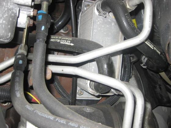

On my truck the forward water line was metal. I think at some point mid-year of '06 they changed to the all rubber water line. That all rubber line does not shake, rattle and roll at idle like the metal one does. :)

This is a photo showing the updated rubber line on 2006.
