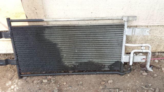

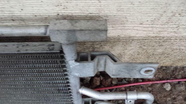

Ok just got the installation done cleaned the disconnects with wd-40 and took some bolt cutters and cut the cooler to get it out of the way . Fiddled with the disconnects a bit but came apart with little effort. Had a bit of buildup on the radiator so I gunked it and hosed it off with some pressure. From my research don't buy the aftermarket look-a-like they don't fit well you have to emery paper the tubing down as the OD is oversize. If I had the time I would have liked to done a Derale but time would not permit. I noticed the mounting brackets changed the old one had more od a extruded piece and the new one which I didn't take a pic of was flimsier. here's a pic
