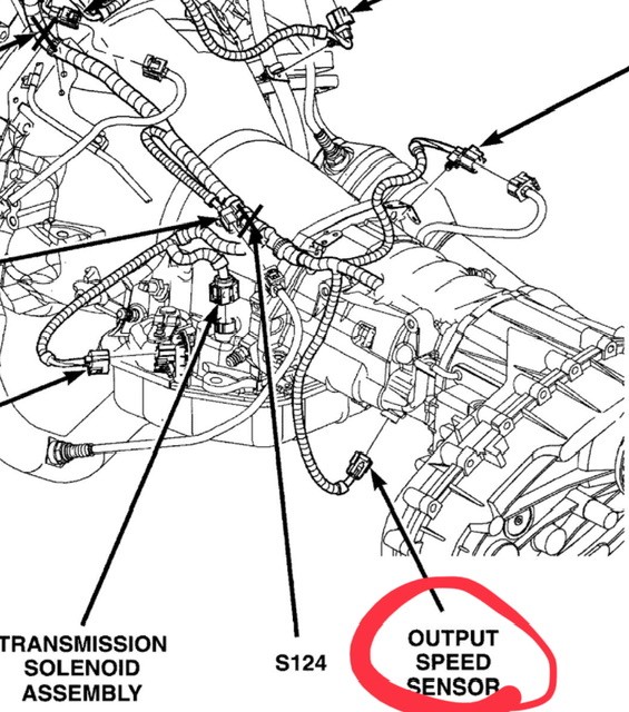

I have a 2001 2500 which is giving me problems at speeds around 35 to 40 and 50 to 55 mph shifting.
I have rerouted my alternator wire around to the front of the radiator to the right side of the the battery when I done this that stopped it for a while. Then it started again so I changed the TPS and got a new one from Rock Auto (Walker Product) and reset the new 1 with the ignition on and the motor not running but am still having problems with the shifting at those speeds. A few years back I added a Rev Max towing valve body and a larger fluid pan adding 1 gal. more of fluid. I did not have problems with the shifting then but I am wondering about the fluid pan as they did not give me an extension tube for the deeper pan. Don't know what to think although it does seem like the TPS. Any one ever have a problem like this or know what it might be ?
Remove, clean, and inspect the speed sensor in the rear of the transmission on the driver side. The tip is magnetic and may be covered with shavings.
I am assuming I will have to drain the transmission at least part way if not all the fluid ?
No, shouldn't have to. I don't recall losing any fluid when I replaced mine.
Well the sensor was dirty and I did have about 4 oz or so of fluid pour out. The transmission shifts better but still between 45 to 50 mph it still gets erratic like it can't make up its mind

Its been a while since you replied and I have not been on this site for a while too but I just wanted to let you know I put in a new sensor and all my problems went away
