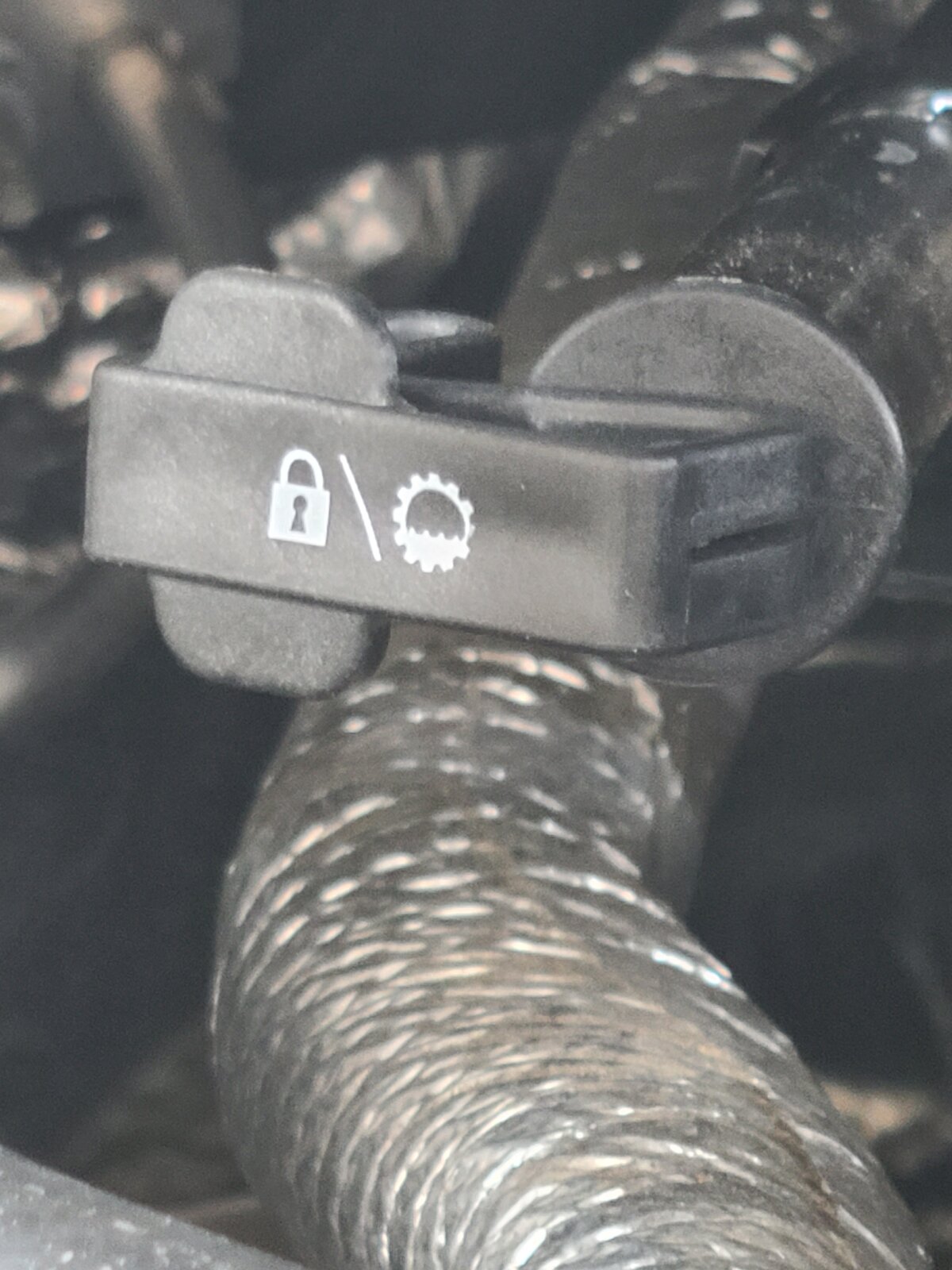

Had the the trans dipstick done last week. I told them I wanted my old dipstick back after the repair,and they said ok. Went to pick my truck up, and they said Chrysler has a memo out saying under no circumstances will the customer be able to retain the old dipstick. I was pissed. They gave me a copy of it, and also instructions on how to check the oil. When I got home I checked what had been replaced, and noted that the new dipstick is the same length as the old one (44"), but it has a locking type handle. I'm happy with it.
Is there a part# on this new locking dipstick??
That sounds like they figured out the final solution by now.
There's nothing on the entire length of the dipstick, including no oil type info or anything. It has 2 holes for the low level, an 2 more for the high level. That's it. I also know they did not remove or replace the actual tube that the dipstick fits in. Here's what it looks like under the hood. I just got back yesterday from a 1,000 mile trip.
Glad they fixed it. The initial repairs included dipsticks that were not long enough to check fluid levels.
