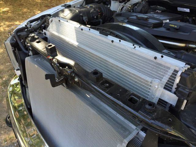

I know you said your not a cooling systems expert, but by chance do you have access to any engineers who might have any insight on the effect of installing a mesh window screen on front of the radiators/coolers to keep out bugs and pebbles?
I've searched the web and can only find a lot of opinions but no real world testing. It seems obvious that putting anything in front of the radiators must affect cooling capacity, but maybe a window screen is insignificant except under the most extreme conditions.
Thanks in advance,
John L.
According to my contact in Cooling Systems, a window screen would not be insignificant. It would increase the airflow restriction through the cooling system, resulting in somewhat higher temps.
I know that a window screen doesn't seem like much (of a restriction), but try holding one out the window while driving down the road and you'll see that it does cause a significant drag. I would also point out that with a screen, you'd still get plugged up with bugs and debris (they'd just be stuck on the screen, rather than in the radiator, etc.). Of course, it's probably easier to remove (and clean) a screen than the radiator!
So bottom line, my contact says if you live in an area with an extreme bug problem, you'd have to weigh the benefits of a screen (and easier cleaning) against having slightly higher operating temps. But in general, he would not recommend adding a screen.
I've run window screen on every Cummins I've owned and never experienced any higher temperatures on anything. Bugs clean off easily with a brush instead of slowly clogging up everything inside where it's very hard to clean.
Geno's even sells a kit called a condenser guard that makes it easy to install a screen.
I've also used aluminum window screen on every truck I've owned as well and have never had a heat problem. It wouldn't make the truck run hotter, it could just cause the fan to kick in a little sooner, that's all. Now granted, I haven't towed heavy in temps like you southerners do, tops for me is 37 degrees C/100 degrees F this summer and had no problems climbing 6-8% grades towing a 30' RV with the deck on the truck that you see in my signature picture, NOT aerodynamic!. I also have the bumper slot totally blocked with a 24" light bar, and still no heat problems.
Put the screen on.
