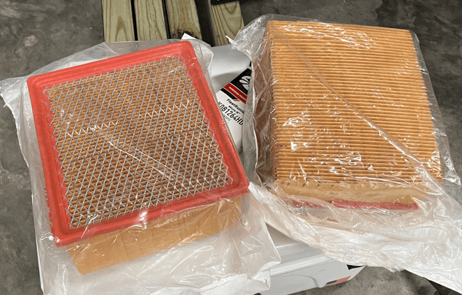

There are definitely filters that increase regen frequency, even the wrong OEM filter has been known to increase regen frequency. You did use the orange filter, correct?
With the soot in your tailpipe you clearly have a DPF issue, which is likely what’s causing all this.
Yes, the oem orange rimmed filter that came on the truck, I took it off originally at 1,500 miles and put the cai on.

For the 19+ trucks be sure to use the 53034051AB filter.
I wanted to confirm before I asked...
I have 2 of these filters I mistakenly purchased when I still had my 04.. Didn't realize they were the wrong one until I put tried to put one in and it didn't fit (04 truck).. My question is what is the lifespan on a air filter.. I've had these since 2018 and was going to swap one in but don't need to risk any damage if they are "old"... They have been in my cabinet with the other oils and filters for my vehicles as I always keep oil and filters on hand for everything so as not to have to find one when I need it.
If they have been kept dry they should be fine.
But I wouldn't keep them any longer, the foam and the glue holding them together deteriorates just by aging.
There was a thread here at the forum about that topic but a long time ago.
Shelf life of filters is limited, one wouldn't believe that.
Well.. looks like the pkg data from Mopar was 07/05/2018... so that'd make them 5y old... Not sure what the shelf life is, Id assume I am ok to use at least one.. maybe give the other away because I wont hit the next interval soon at my current drive / usage rate. They have been stored in my shop not exposed to sunlight etc...

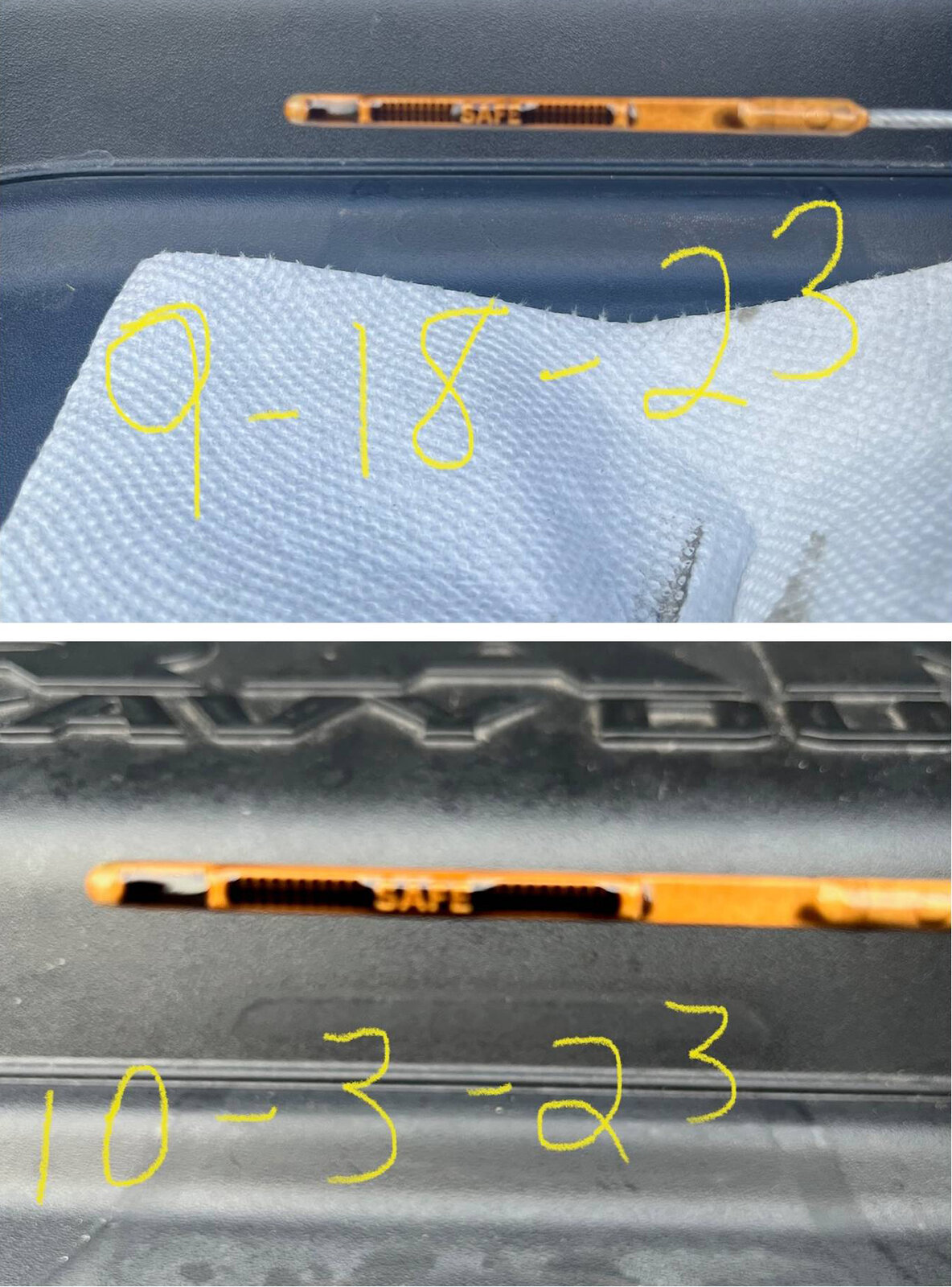

**UPDATE**
After becoming completely dissatisfied with the service by any of my local dealers I made the decision to take the truck to an independent heavy truck shop. I sat with the service manager and the lead tech and went over every bit of the data that I have been gathering. Both agreed that there is clearly an issue with the truck and were willing to dig in.
Every temp sensor in the doc dpf scr was ohmed out, the pm sensor was cleaned and the differential pressure sensors were tested along with the tubing for the sensors being checked for plugging. I drove it for a couple weeks continuing to monitor the regen frequency and oil level. NO CHANGE. I took it back provided the data I collected during the test and they went back to work.
After more testing, and multiple stationary regens while monitoring the performance it was determined that the dpf was over 70% restricted. They recommended replacing the doc/dpf assembly and an oil change. I gave them the go ahead.
The truck was returned to me after the replacement, huge performance change, noticeably more power, and after a few days I noticed the fuel mileage up from the 12.5mpg before to 15mpg after. It went over 450 miles without going into regen.
The oil level issue was confirmed to be a symptom of the frequent regens, as the level has not risen at all in 862 miles since the dpf replacement.

Hopefully it goes well with Stellantis, and hopefully your issue is fixed and the DPF was the issue and not something with the engine causing the DPF to plug.
I believe all is well, the tech told me this is a very common problem not just with the ram trucks, but also with the 6.7 in school buses. Any extra idle time or light load makes them soot up and clog the dpf.
He says Cummins sets all these up to run on the rich side with the intent of building heat in the doc and dpf, to mitigate sooting. However when lightly loaded or idling it makes it worse, creating more soot.
