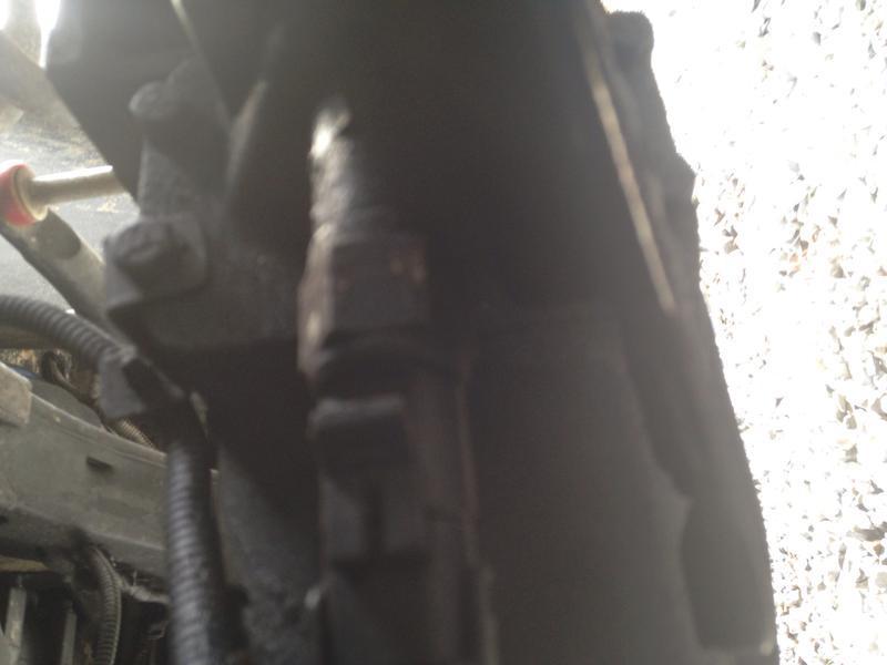

Hi, the last light I need to turn off is my 4wd light, it flashes intermittently in 2wd. 4wd engages perfectly and shifts into 2wd fine. The mechanic I had the truck at for almost 2 wks to turn off brake/abs light didn't correct this, just wanted to wash my hands of that guy. Trying to figure this out,I took what looks to be a sensor out and it looked clean, what else could cause this, do I need to replace the sensor?
Sorry the picture didn't turn out as well as I'd liked it, but it's the sensor to the left of the vacuum lines on the axle

I would just unplug it and test drive it to see if it flickers! If it does not I would remove the switch and plug it back in and tie it back and test drive again.
Switch is 19.09 at NAPAONLINE.
http://www.napaonline.com/Catalog/C...Indicator-Lamp-Switch/_/R-ECHFWD25_0306281797
Good Luck. Chris
Thanks! What a no brainer, embarrassed I didn't think of that! Going to run it this evening and see if it goes out with it unplugged.
