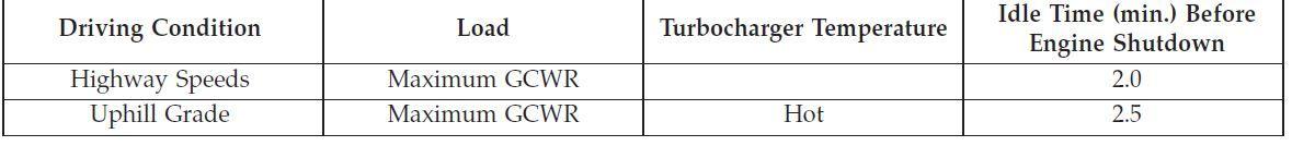

I've read that fossil oil max temp should be <250 deg.; full synth oil max <300 deg. to prevent varnish from forming. After a hot day towing trip, at idle, my EGT's don't cool below 350 deg or so. My recent switch to Valvoline Premium 5-40 full synth helps me a lot in Winter & maybe holds up better at the turbo during Summer RV towing. Never saw any actual test results on mechanical equipment components, but I'm sure oil manuf. have them, eh.

To the OP, I think you're worried about nothing. My EGT's are between 3 and 4 hundred degrees by the time I coast through my neighborhood and get it in the garage. Never had an issue.
"...never had an issue." in how many miles/hours? That would help quantify your experience. Thanks.

As the Turbo is water cooled there is no harm if shut of with 500°.
Modern Turbos in general are not that sissies anymore then grampies old blower.
