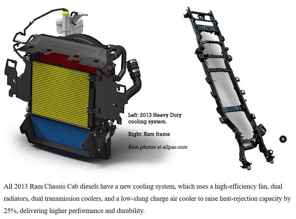

As I said, the dual radiator was dropped after 2 years. It was only in pickups from 2013-2014.
As far as your dual radiator, got a pic? The stuff I'm reading says you should have the same cooling setup as the pickup, which is a single radiator.
Just need to be sure you're reading info for your truck.
No, the C&C's don't have more cooling capacity and radiator configuration will have minimal impact on turbo cooldown times.
I don't have my truck right now to confirm how many radiators it has and I'm only going by what I read. The banner associated with this listed 2013 to 2017 Cab & Chassis.
Also, the turbo is water cooled and if there are any improvements in the engine cooling system, seems there should be improvement in the turbo cooling as well.
I'd be interested to see if you have the Y pipe and dual hoses when you get back to your truck.
John, Got my truck back today and it has a single radiator. Last year, while researching the tech info on the truck, I found the info about the dual radiators on the Cummins website. It's not there anymore, but it wasn't current last year. It's tough to get good info when credible sites have it wrong. So, you were right.
