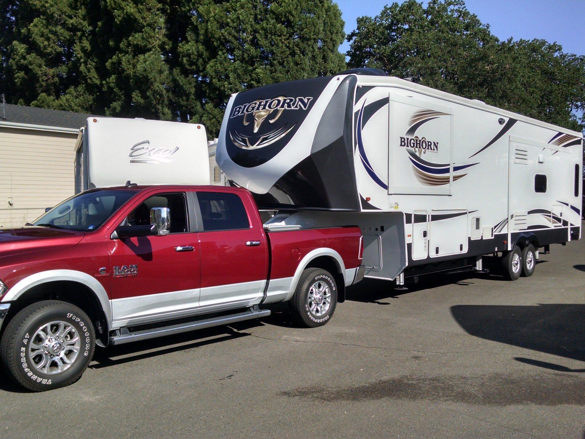

This last round trip to Arizona with our 8K bumper pull TT, I ran without TH a lot to allow the transmission to shift to 6th without having to go over 65 like in TH. Got better mileage that way. At 60 MPH in 5th the 8K trailer got about the same mileage as the 16K 5th wheel.
You got the same mileage towing 8k vs 16k?
I kind of understand that, and even though I have never towed that heavy consistently with my truck to get some facts but I believe it.
My mileage drops from about 22 to about 14-15 pulling my 7x12 enclosed, which only weighs about 3klbs, and I feel thats a significant drop in MPG, but at the same time I think my mileage would be around 14-15 pulling up to 7k lbs. Its a weird concept to think about the way I do.
16K 5th wheel sits up close to the truck cab. The TT is way behind the truck and bikes of mounted on the BakFlip bed cover. TT has squared off flap back and 5th wheel has a rear cap.

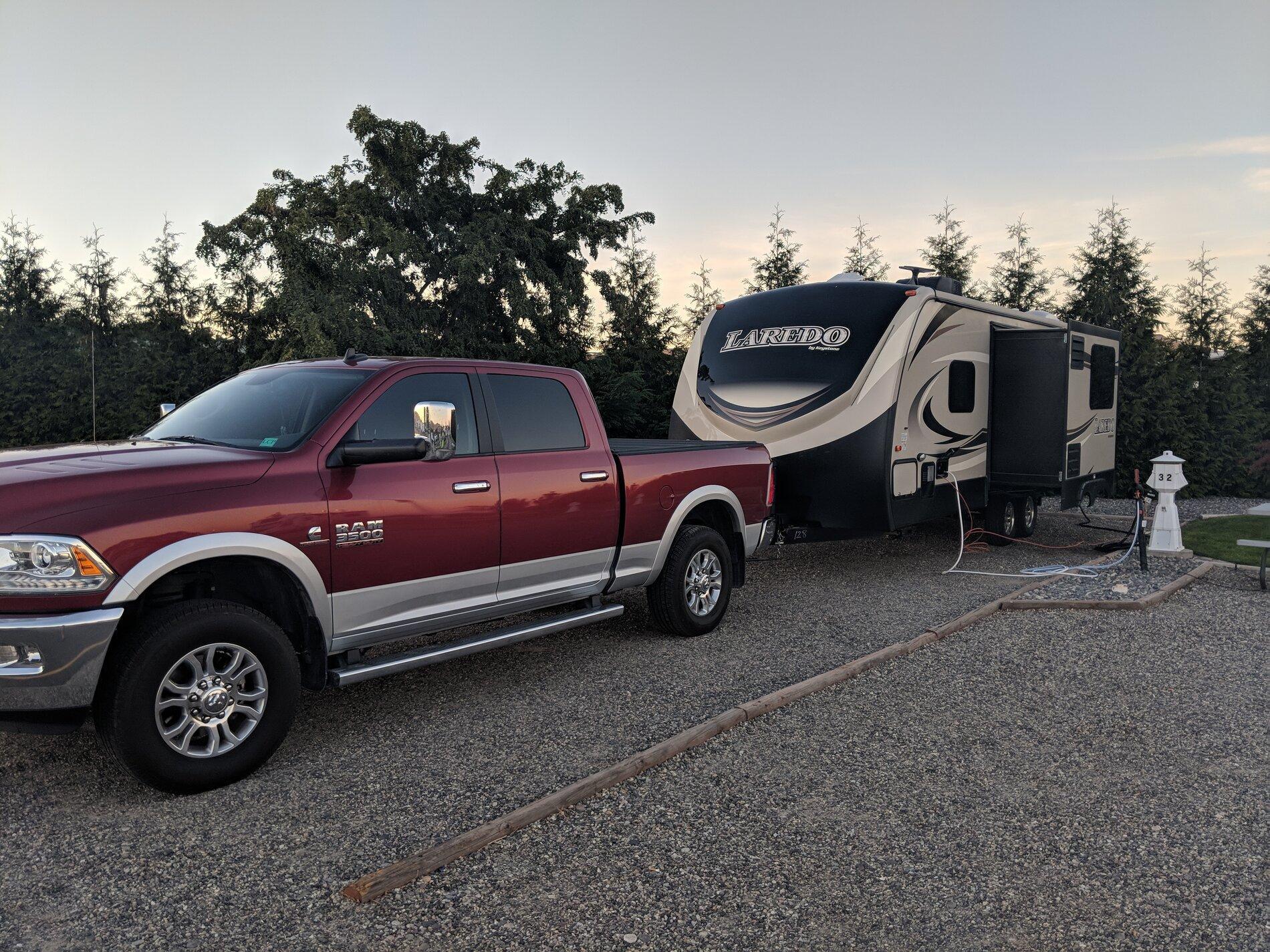

I get about the same fuel mileage towing my 20 ft enclosed car hauler with 5KLb tractor as with my 21Klb 5th wheel. The car hauler has square front with ~14ft open space between the back of the cab to the face of the trailer and 5er has nice aerodynamic frint only a few feet behind the cab, even though much taller.
At least in my case, aerodynamics TRUMPS weight affecting fuel mileage.

I get almost the exact same mileage towing a 11K 26' Toy Hauler, 9K 30' TT, or 10K 5th wheel.
I think if my truck struggled to tow the 16K trailer I might see more of a difference, it does not struggle! So towing in the same gear (5th gear) and speed there is very little difference. Getting into 6th with the little trailer as I noted, does improve mileage. We will be off to Arizona in 5 weeks, so another chance to test theories. Taking the higher elevation route down through the middle of Nevada.
I don't feel any real difference with the 3 effort wise, but then again that translates to the same milage. No struggles, 6th above 65 until the grades hit.
