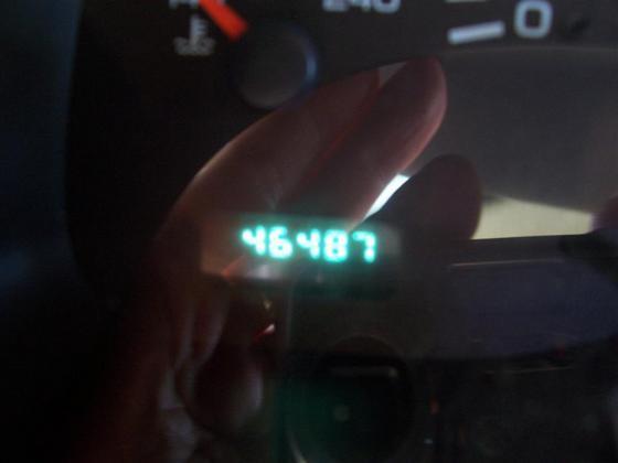

I took delivery of my 2002 3500 ETH/DEE dually in August 2001 and sold it in September 2010 (when I took delivery of my new truck below) with less than 46,500 miles on the odometer. That's an average of 5166 miles per year.
The 2002 was used only to tow our 5th wheel RV and was garaged at home whenever not in use. Despite the low mileage, it made trips from the Houston area to Arizona, Tennessee, Missouri and all over Texas for RVing trips and rallies. So, yeah, the reported mileage is low, but it's certainly possible depending on how the owner used the truck.
