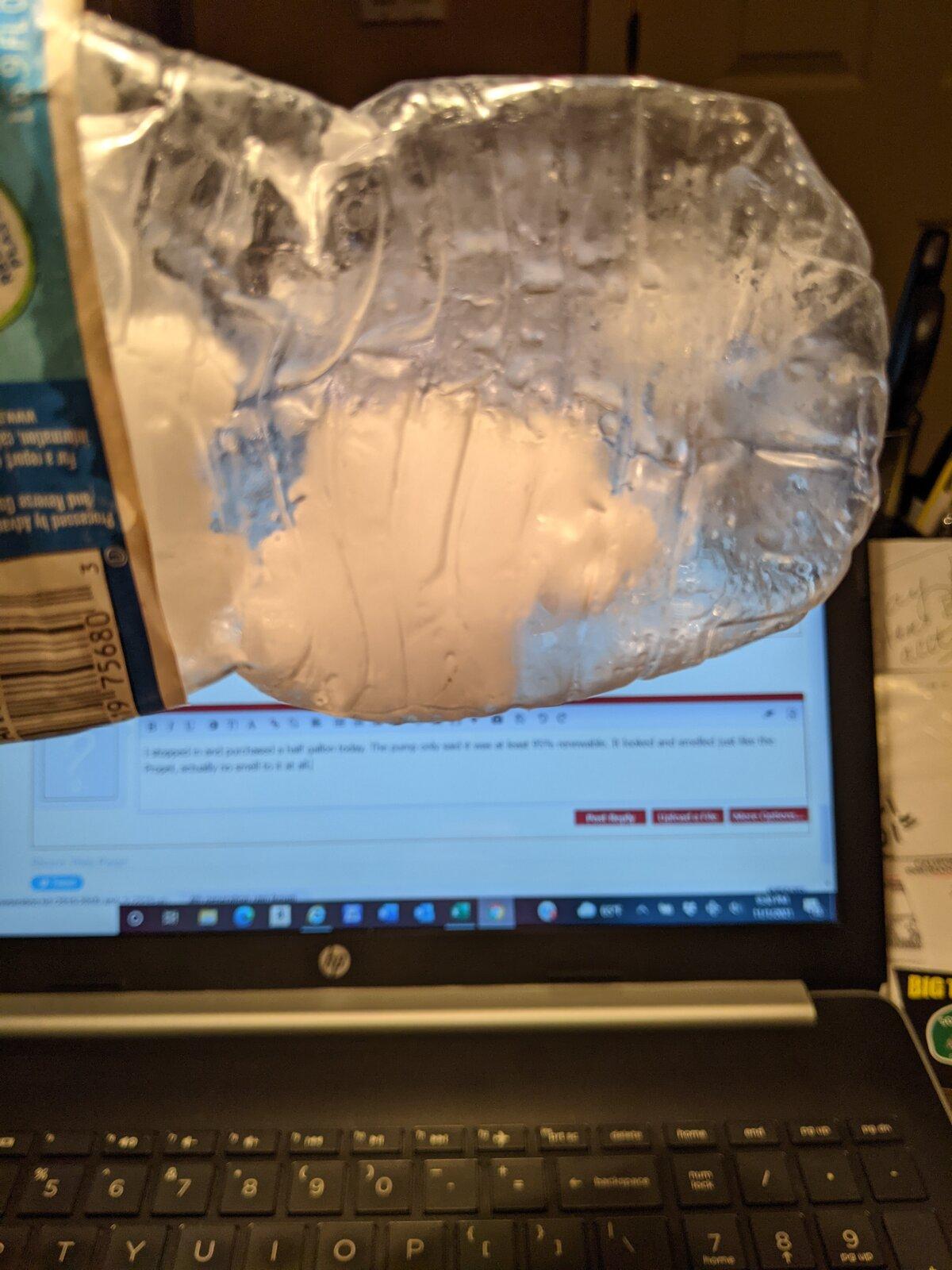

I stopped in and purchased a half gallon today. The pump only said it was at least 95% renewable. Nothing about it meeting any fuel specification like the Propel does. It looked and smelled just like the Propel, actually no smell to it at all which is a plusView attachment 131393 . It didn't do too well in the freezer though. I would not suggest filling up and driving to Tahoe when it's near zero degrees. I think I will still try a tank or two and see what happens. Not a bad price at $4.59 compared to everyone else around.
