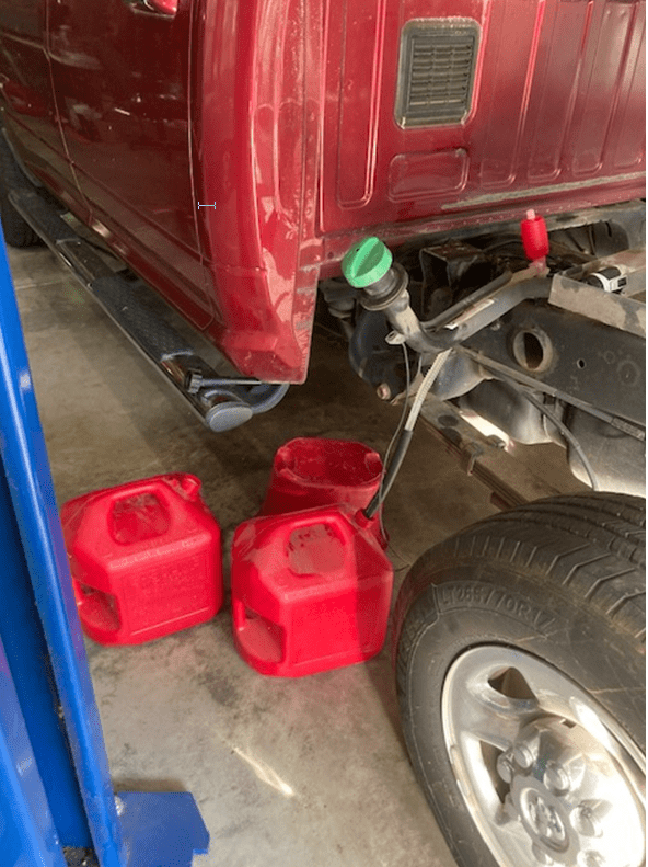

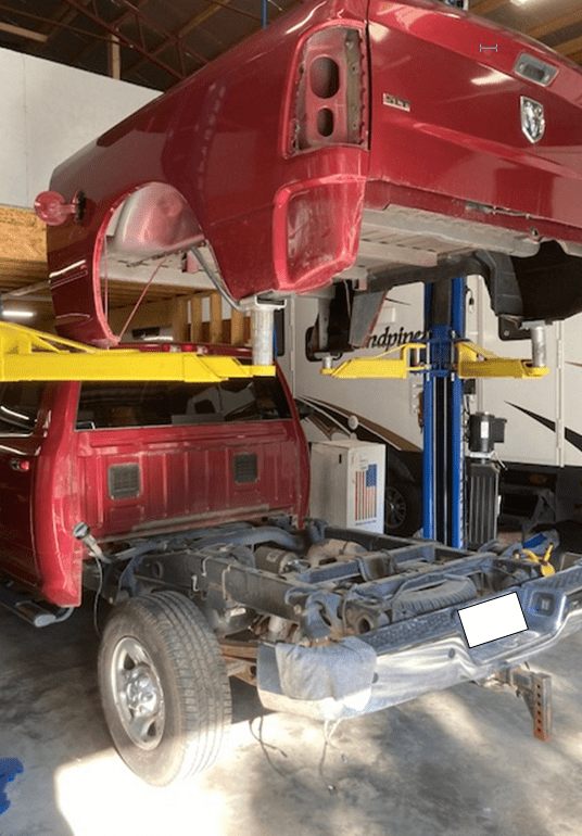

OK, Update,
I have the tank drained, 33 gal (25 was unleaded), I was thinking to pour about a 1/2 gal of diesel in and mop it around, is that unnecessary or just let the residual fuel flash off? Next going to rinse the module with some diesel, clean the pickup screen on the pump and put back together. Then put in about 10gal of diesel, I could not find any Opti-lube XL locally so I ordered some (be here Monday) and picked up some Power Service Diesel Clean (silver bottle) at the AP store which says it has cleaning and lubricity components, figured it says endorsed by Cummins so there's that, I thought Id double down on it and start flushing out the system.
Step 1, Remove fuel filter and drain, blow line with air with drain line open and finish drain supply side, (replace filter with on of the two filters coming from Geno's today) Geno's is THE BEST!
Step 2, Remove FCA and inspect.
EDIT [ there is nothing in my service manual about removing the FCA other than "it is not serviceable" I know guys remove them, I assume I will not have a surprise of parts flying out when I pull it.]
Step 3 Loosen CP3 to fuel rail supply line and let drain (gravity) tighten
Step 4 Cycle KEY ON... and let lift pump push fresh diesel, with the return line at the tank in a waste tank. (probably 2 gal or so)
Step 5 Try to start???
I welcome any ideas of STEP 1.2 or 3.2 etc... Not sure which lines I can remove to blow with air but this is where I'm at today.
