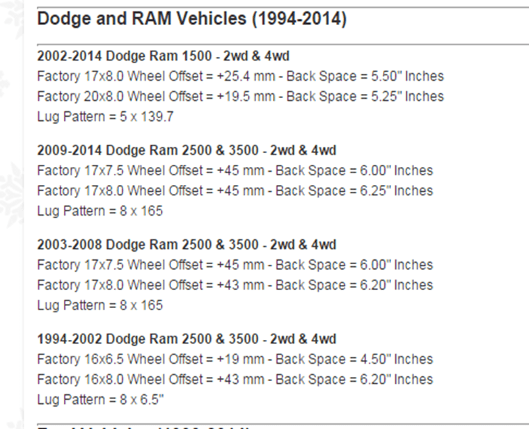

Looking for new rims for my 2004 Dodge 2500 4X4. Like the look of the factory rims. My question is, am able to find lot of near new 18 inch rims, will they work and fit on my truck? Have heard that up to 2018 is considered fourth generation and after that is fifth generation. What 17 inch rims, from what generation or what years truck, will work on my third generation 2004.

2003-2009.

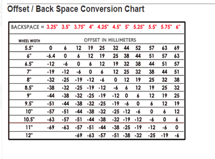

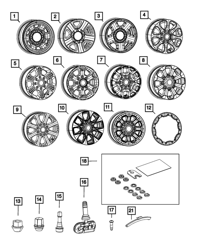

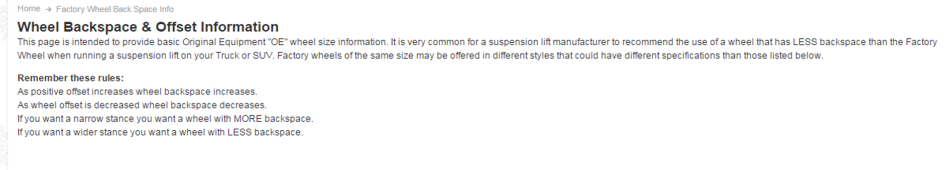

Does anybody know the offset of the newer 18" steel wheels ? I'm interested in upgrading to these from my OE 17x7.5 steel wheels, but wanting to mount larger tires am concerned that the offset will be same as newer 18" aluminum wheels resulting in everything moving approximately 1/2" closer to center of truck. I also have Spyntec hubs so I need a wheel with larger center bore. I've attached a good graphic of the current Mopar truck wheel offerings which easily distinguishes between different center bore sizes. First three would support spinfree kits I think.
