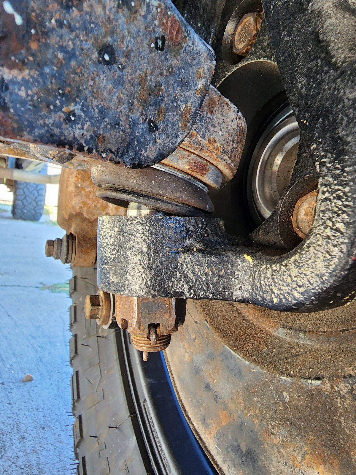

But I would almost bet on the stabilizer bar links. Disconnect them and hang it up for a test ride. Their bushings look toast I the picture you provided.
You'll get it beat into submission! Hopefully that will happen before you raise the white flag of defeat! It's always like that, two steps forward, three or more back! Hang in there. :D
Yes it absolutely does, as only one side of the vehicle moves the stabilizer bar works against that move. And a bad bushing leads to a clonk.
Give it a try, it is so easy to rule that cause out.
I had that more then once before I upgrade to aftermarket links.
