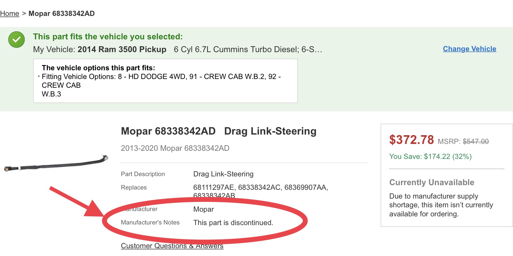

Are you able to verify the part status of the drag link? This online Mopar parts supplier shows it as being discontinued.
Thanks!
John L.
John, there are 700 in depot stock and 1,300 in dealer inventory. That price is very good as dealer net is $327. Perhaps that is why they are not taking orders.
