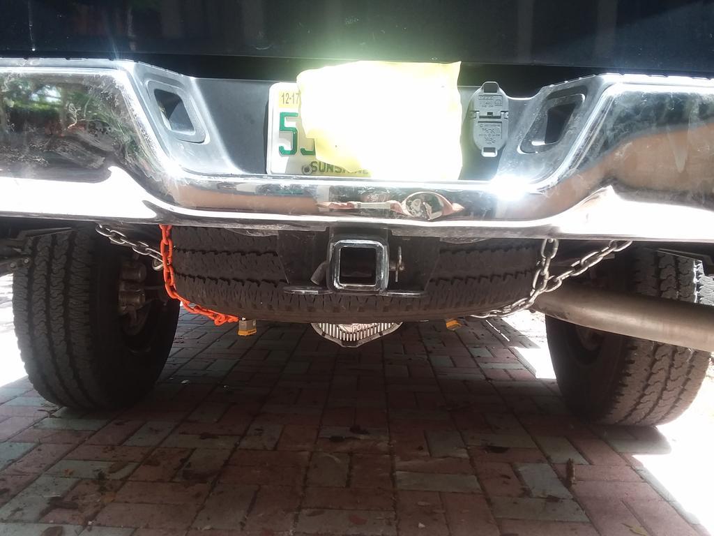

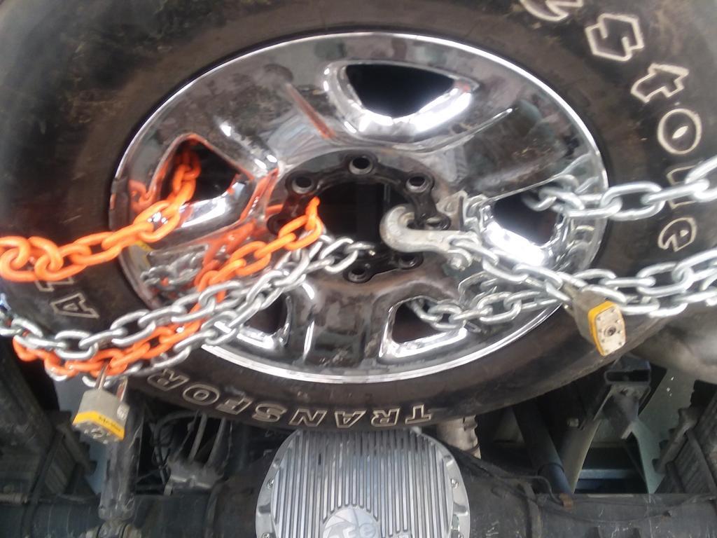

Got tired of the spare taking up space in the bed. Thought about getting a wilco mount for the hitch receiver.
Instead decided to do what many recommended on here.
Edit: had concerns about the wilco mount blocking the view of my tailgate-mounted camera.
I have 1/4" chain as a safety, and a padlock, but 1/3 way up I have a stainless shackle hidden. The rotted padlock is just a deterrent lol.

I just used the chains and lock that I had under my back seat. Didn't want to go buy something since I already had overkill tow chains. I just put them to work.
I no longer have a winch. It took about an hour and 3 hernias to get it up there.
