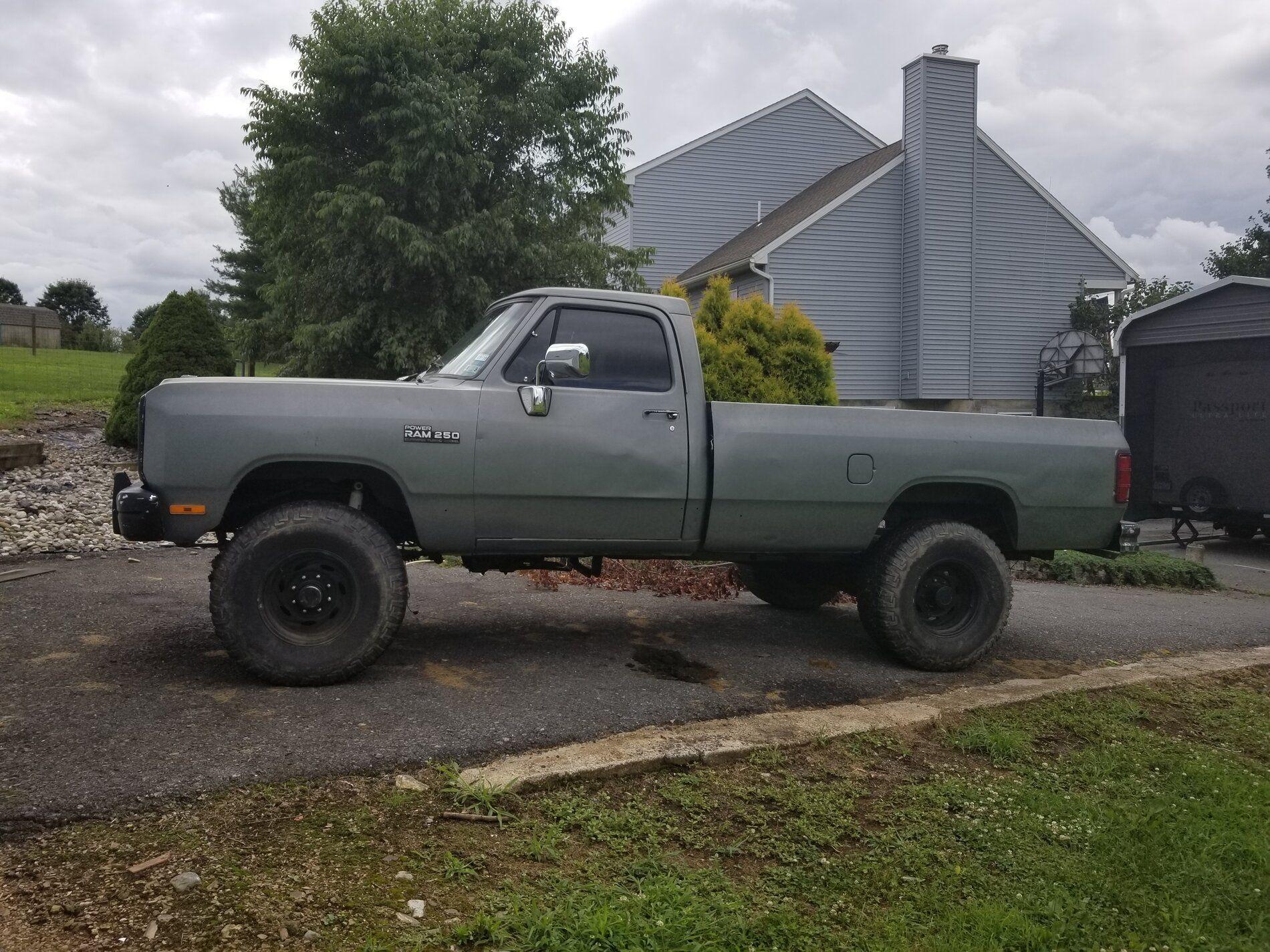

I recently sold my 1953 M37 that I was never going to get around to restoring and used those funds to buy a 1990 W250 to have as a toy. It's not perfect, it's not pretty; but it is a Texas truck with almost zero rust which is hard to find in the mid-Atlantic. Again it's a toy, I wanted something to cruise around in, haul firewood, commute sometimes, etc...its not a daily driver.

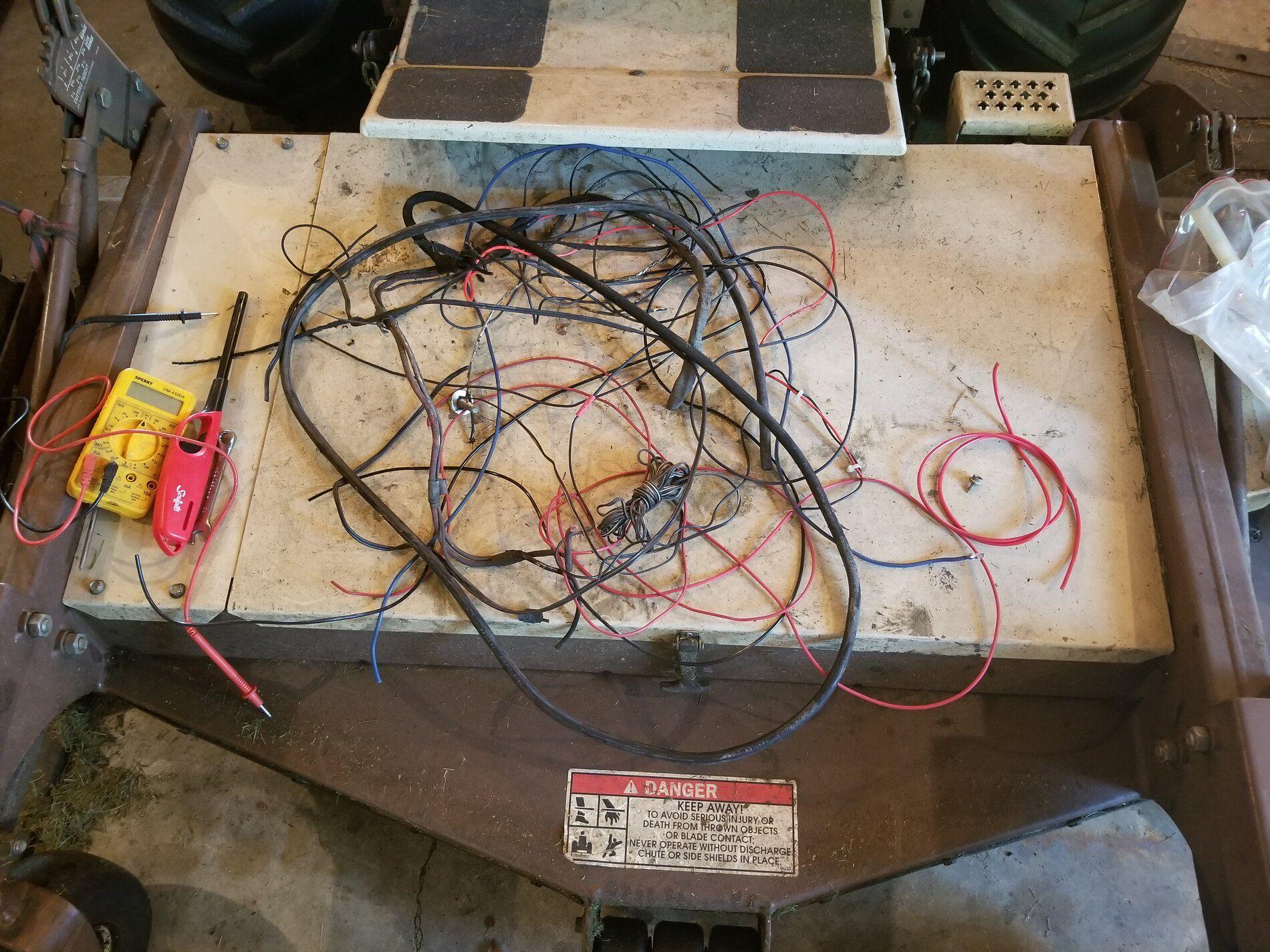

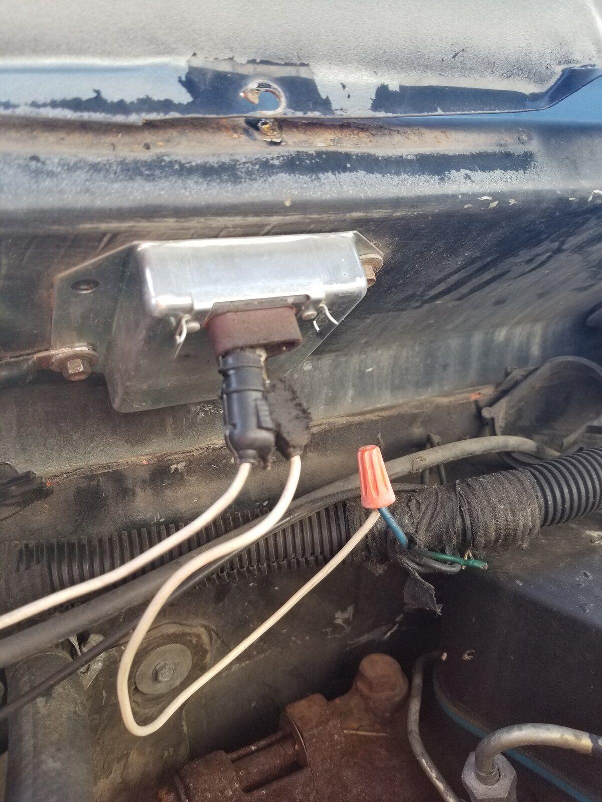

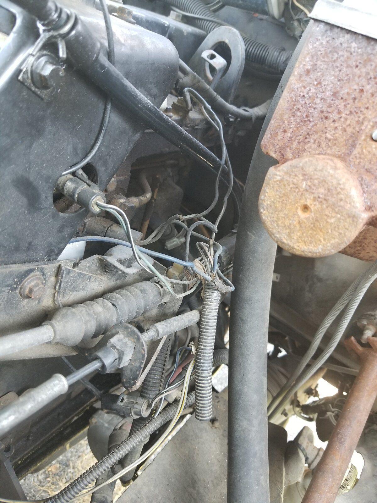

I've spent weeks undoing all the prior owners' modifications, cleaning up wiring mainly. It runs and drives fairly well. Figure I will have it on the road in September...
I may have some questions down the road, one is about the vacuum system, I think mine has low vacuum at the moment which leads to less than stellar brake assist. I may also have some on the wiring harness...previous owners' decided loom wasn't needed, and neither were connectors in places.

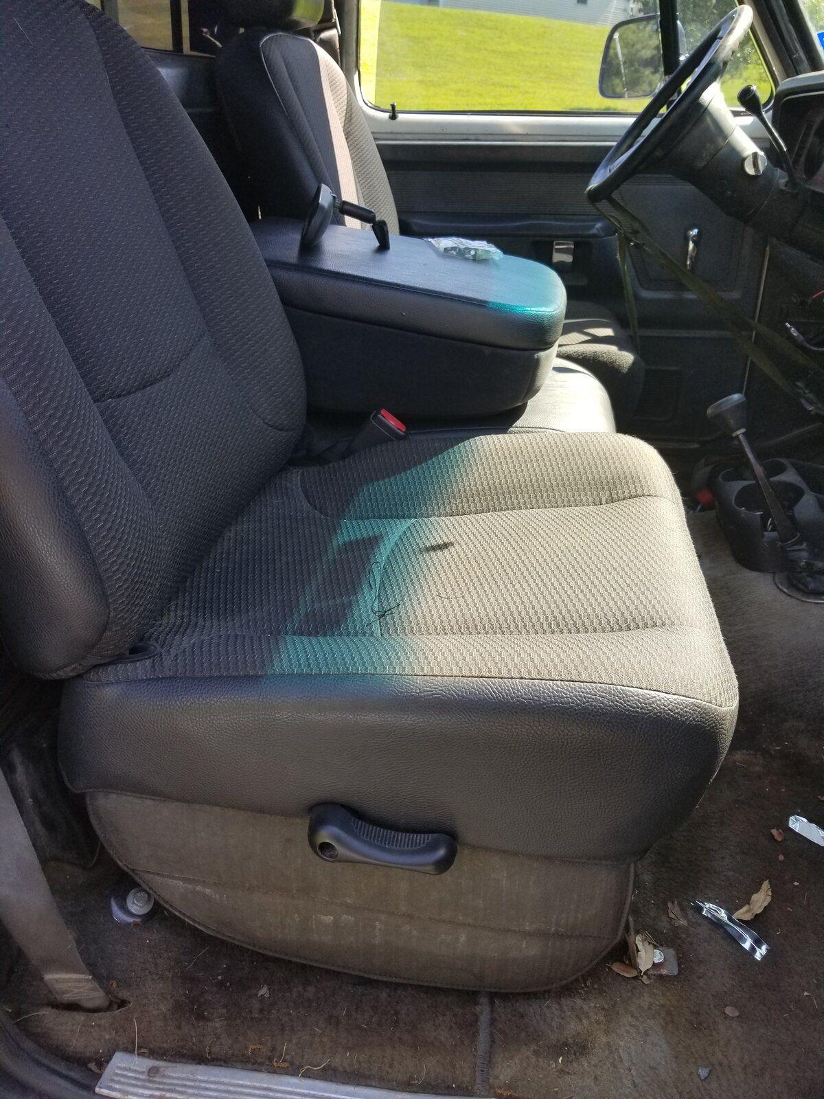

Interior is rough, it was worked hard. I found one small rust hole in the driver's floor from the vent leaking...nothing bad.
I'm planning to gut the interior anyway...go old school - no flooring, no trim, no headliner, etc...I like that feel from the 70s era power wagons.

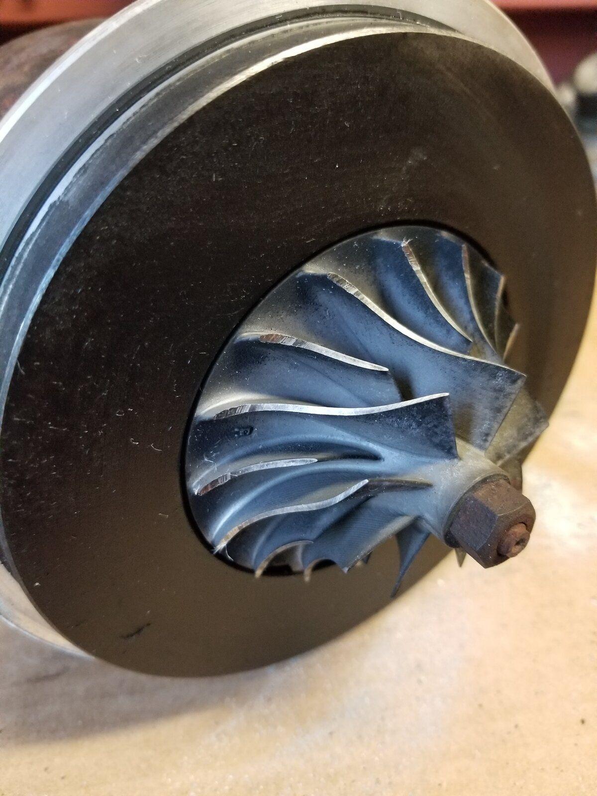

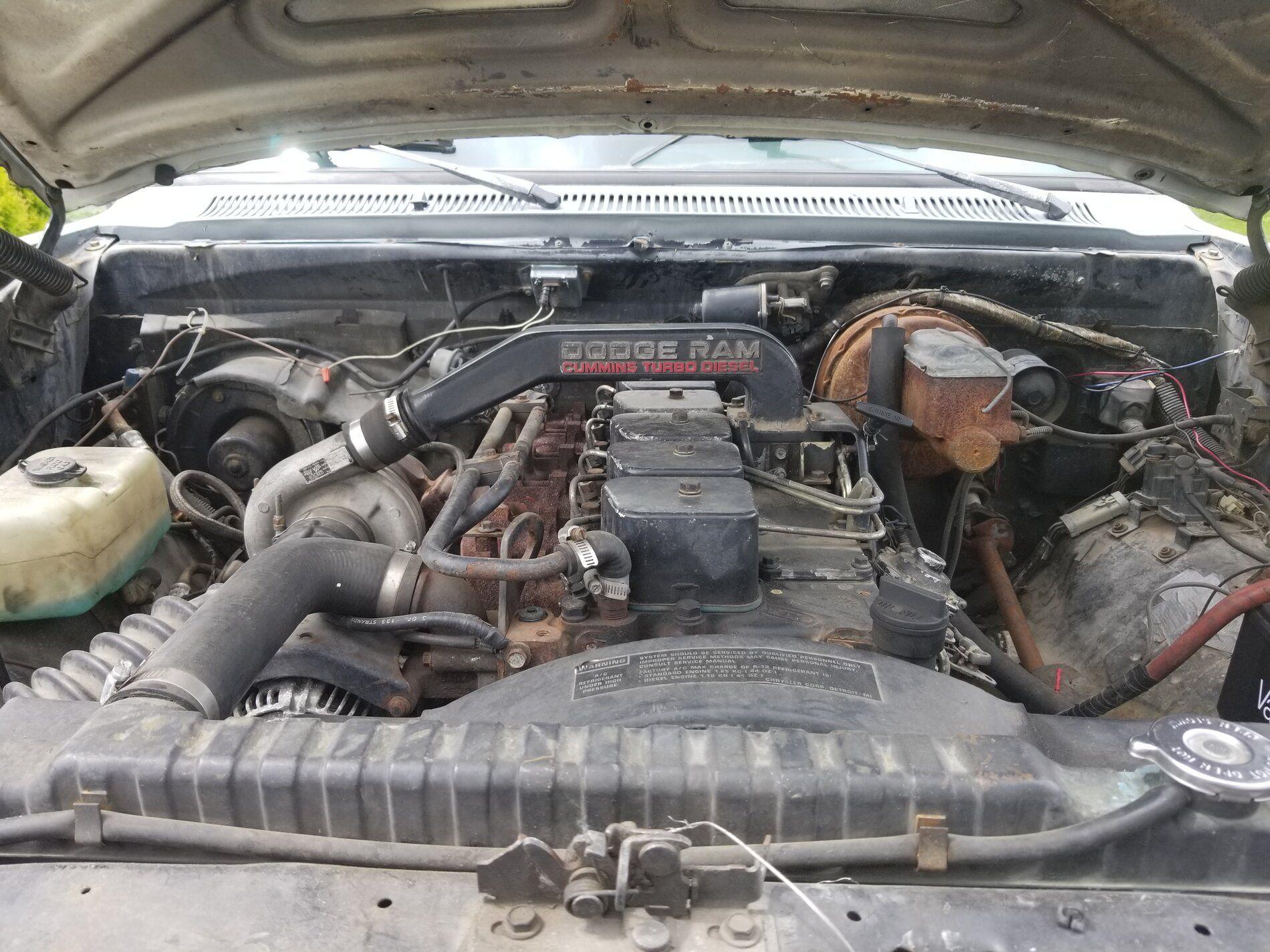

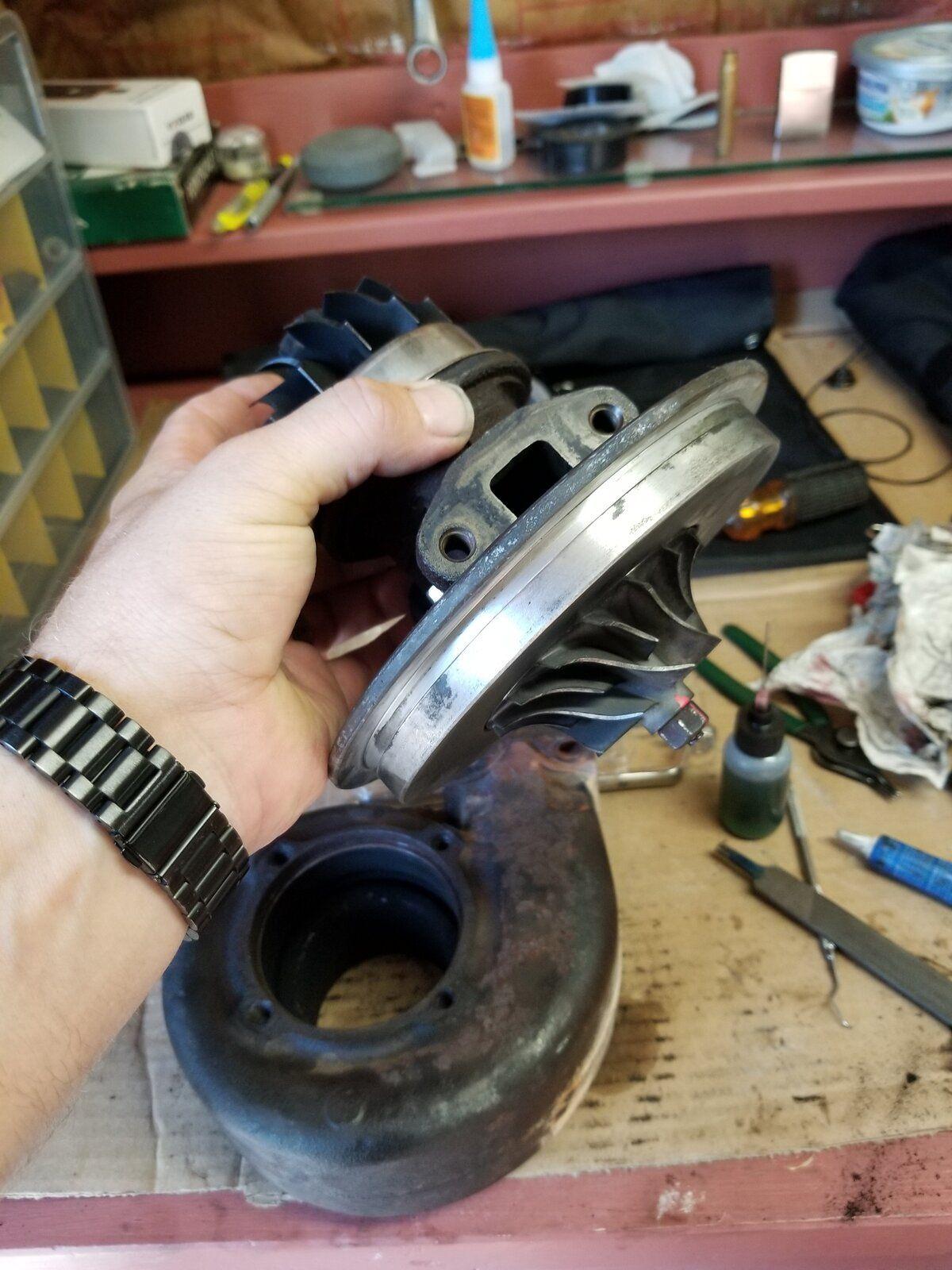

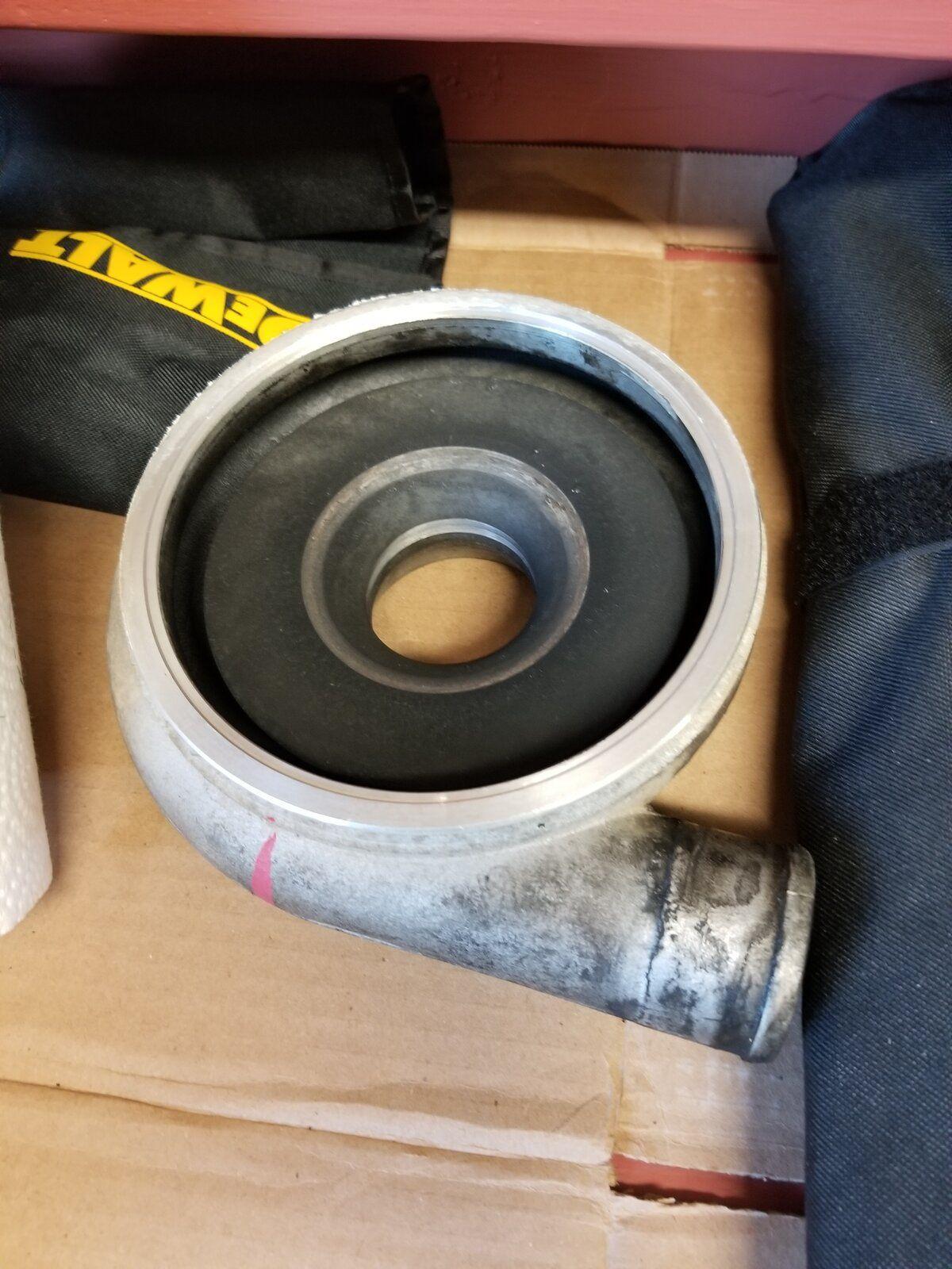

As you can tell from the photos, I rebuilt the turbo...it was in bad shape.
From what I know, the chassis has about 400k miles on it while the engine has around 180k on it...I almost wonder if it was a KDP failure. I think they swapped long blocks, and that's why the turbo looked like it had 400k.

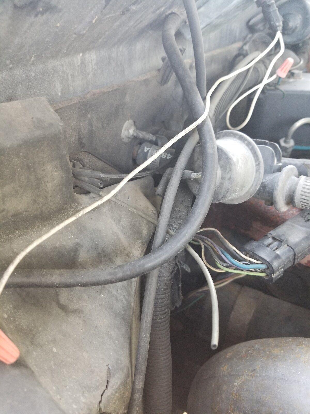

I got to get home an figure out the brakes on this thing (this will be the main thing before it's road worthy)...I'm thinking leak between the pumps and booster or bad pumps. Didn't think about it until just now, but I do have a vacuum gauge I can use to diagnose it.

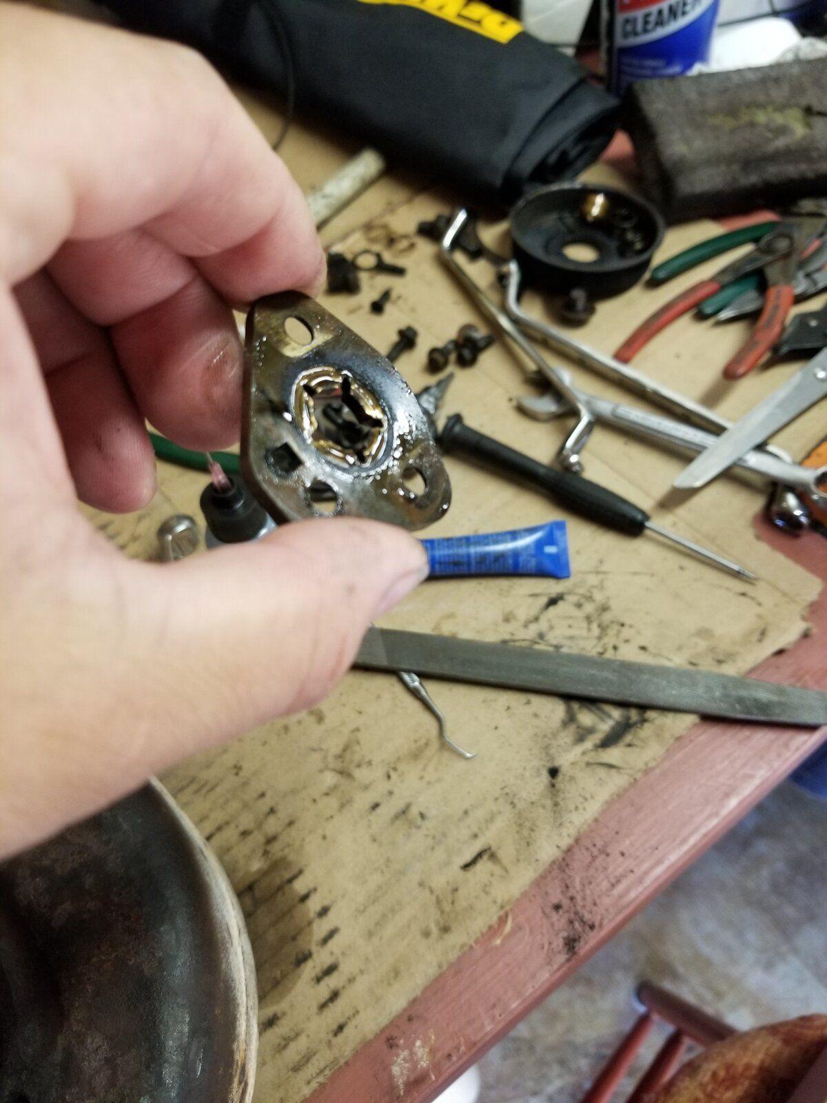

Well, diagnosed the brake issue partially...one of the two vacuum pumps is shot.
With just one hooked up (the other removed from the system), the braking is vastly improved, but now I think that vacuum diaphragm that triggers the brake warning light is on the fritz...since I disconnected that line from the booster to diagnose the vacuum, the brake warning light has been on. That light and the ABS were both on when I first got the truck, the ABS went away when I worked the connector on the ABS module and the brake light went away after I got some vacuum at the booster. Is that a normally open or normally closed diaphragm switch? Since they aren't available, can it simply be removed and jumpered?
For reference, I had a shakey 5 to 10 inches with both pumps after I seal some of the leaks...now I have a solid 25 inches with only one good pump.
I still have less than stellar braking, which may be my use of hydroboost and stock tires for the past twenty years. I'm still think I have to pull the master cylinder and adjust the push rod to be longer because the brake lights stay on sometimes and you can feel the play in the pedal. I probably need to adjust the rear brakes as suggested (they are new, so probably need bedded), and I'm probably going to replace all the rubber hoses since they are probably swelling shut...
How hard are these little diaphragm pump deals to replace? Are they really just four small nuts and a hose? Nothing to fall out or align when installing the new pump?
My 92 only had the engine mounted vac pump inline with the power steering pump. And yes, the light comes on when. Vacuum drops.

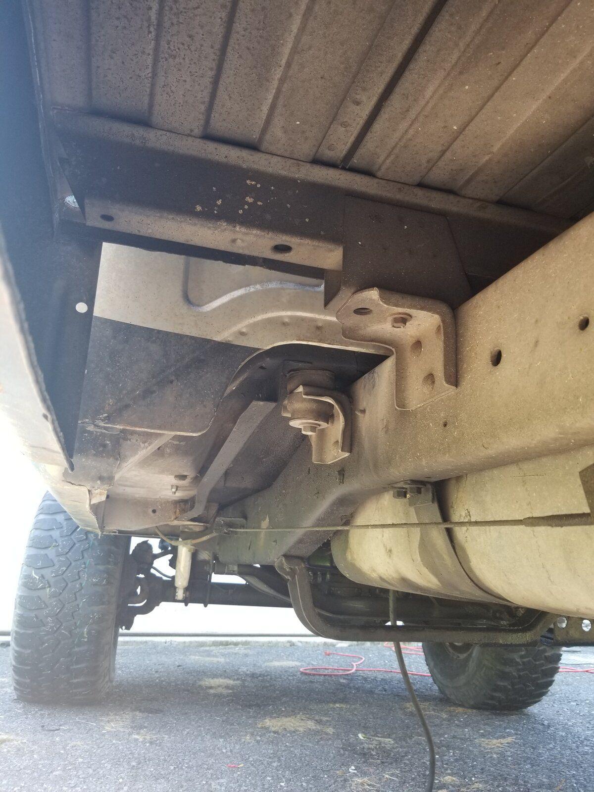

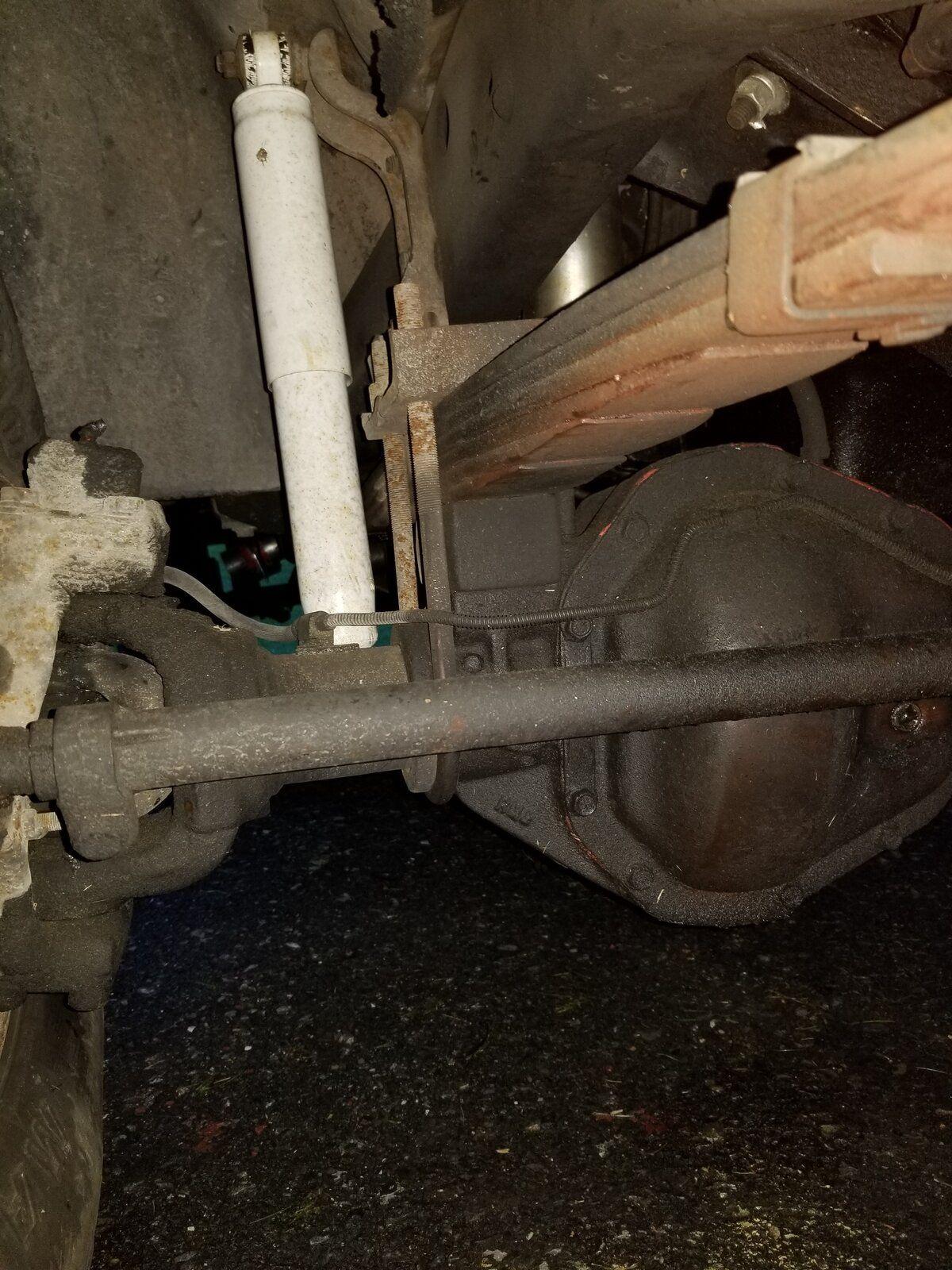

This is the front lift block the prior owners installed. Supposedly OK for inspection, I'm going to check the ubolt torque just to make sure they are tight.
