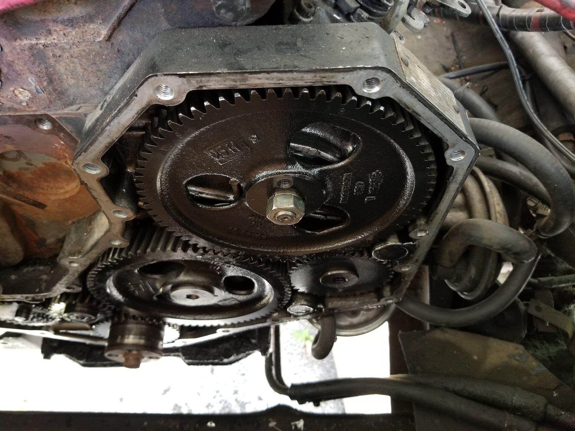

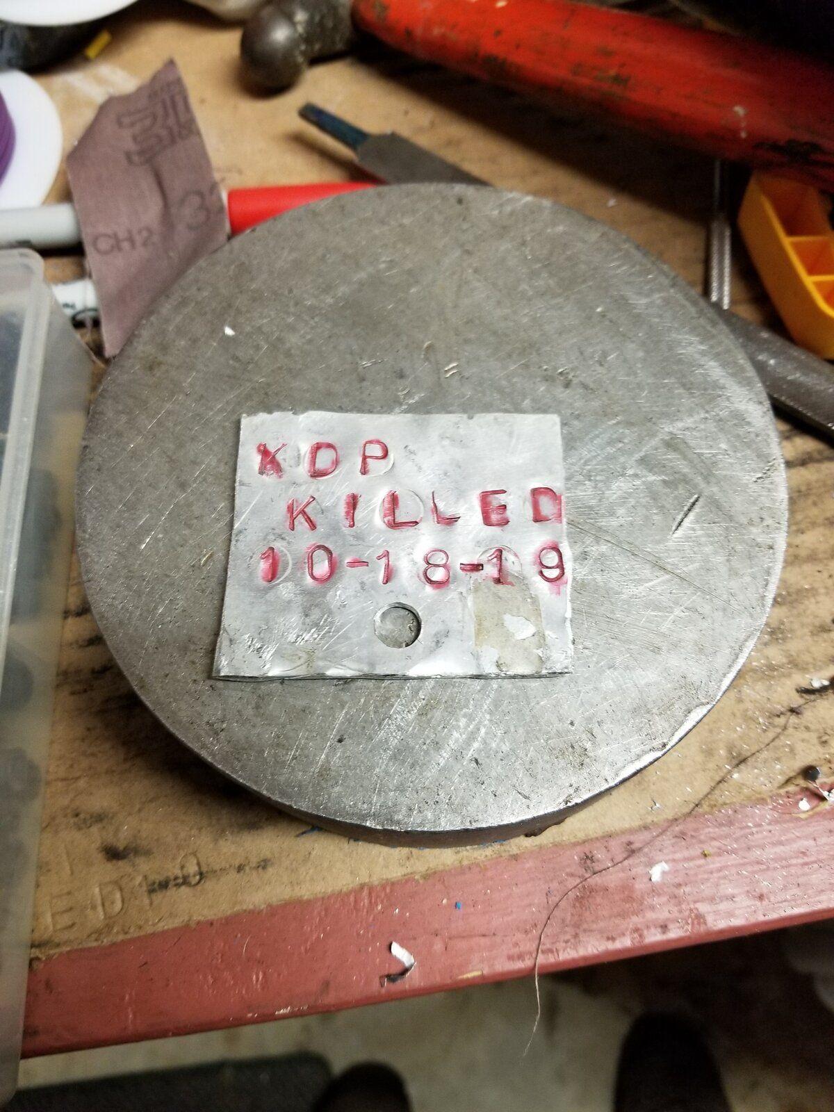

Did the KDP the last couple days...
I bought an injector line bracket from Cummins ($60!!!!). They ran a build sheet on my engine and it had a VIN. I ran the VIN, but it only had four reports, all were from title transfers, and only to 9k miles...the last was 1999 and no miles listed.

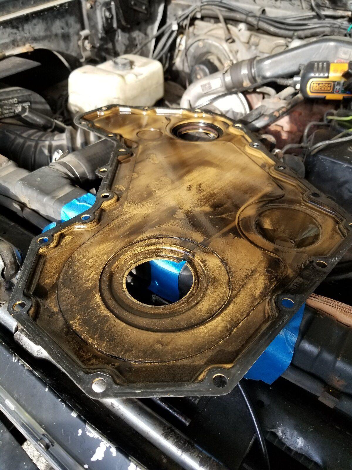

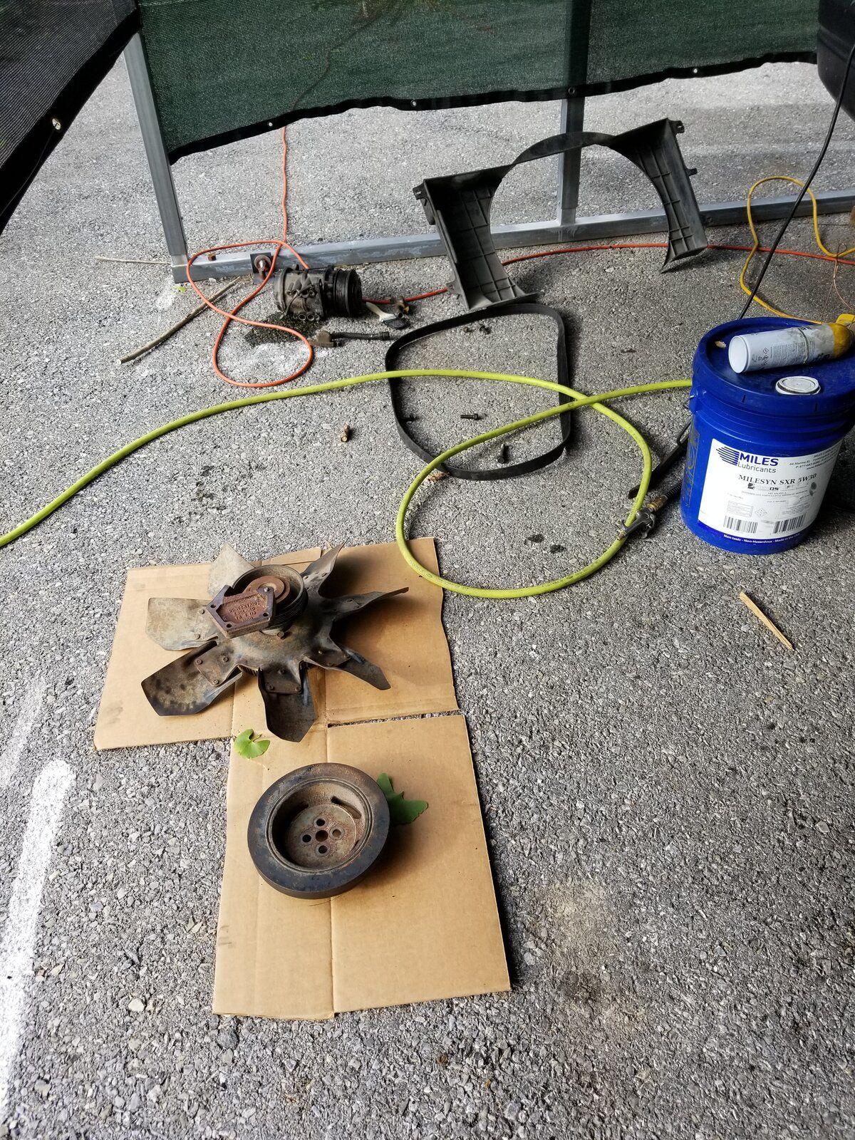

While I had the fan out, I decided to tackle my seeping oil pan...what a nightmare that turned into...started at 930am and finished at 530pm, non-stop.
After loosening EVERY drivetrain support bolt, I figured out the driveline was slid rearward, so upon loosening the trans support from the crossmember, it slid forward enough for me to get the pan in without disturbing the gasket.
I was able to use my hydraulic press and bow the pan back out where it was supposed to be...they must had set it on the pan when swapping engines. I did find out this engine is from a 1990 d350 cab and chassis.

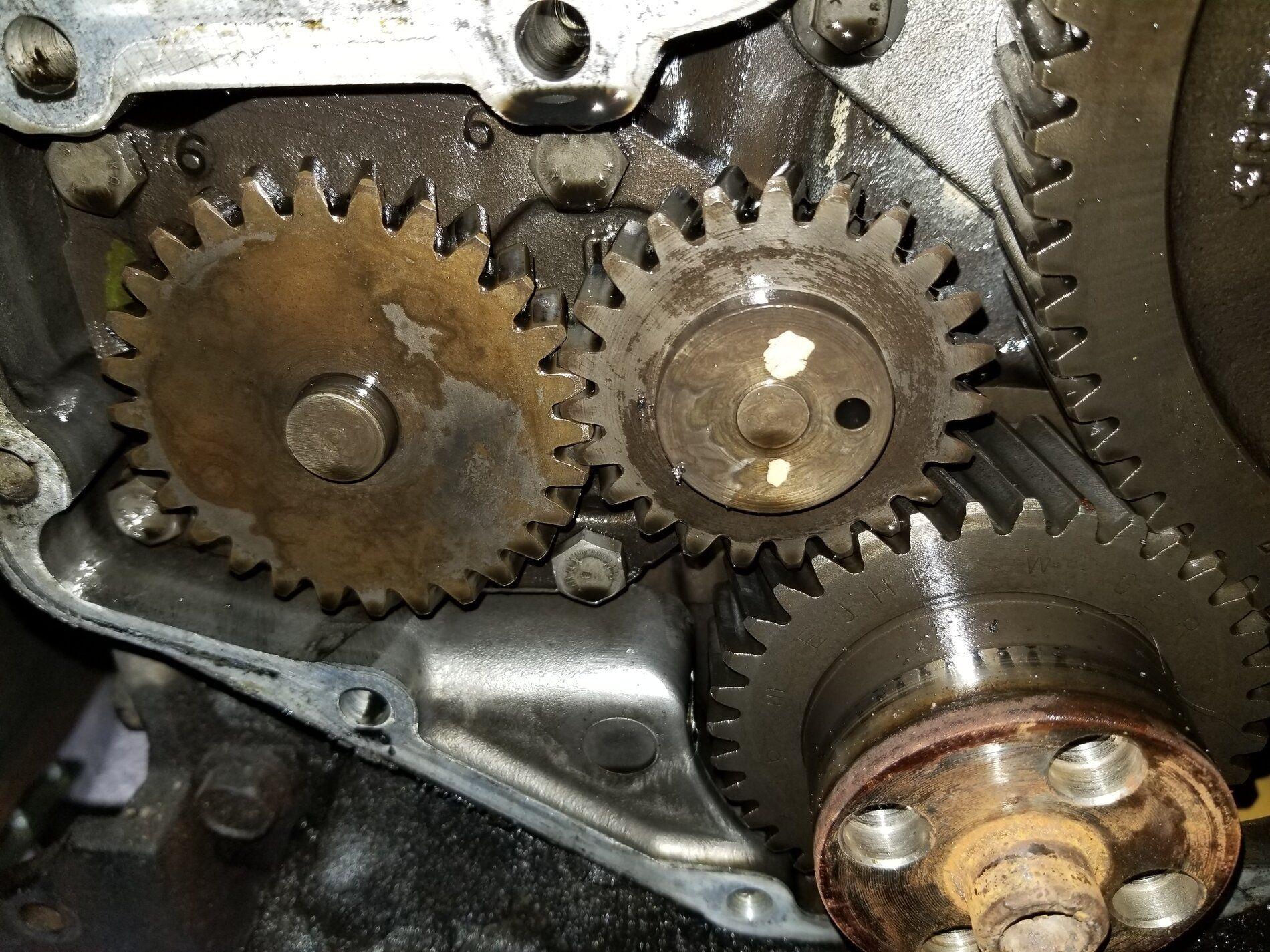

Bores that I could see looked good, only found one piece of something in the oil pan that wasn't supposed to be there...it was a thin tube, about an inch long, obviously worn and it had some knurling. Imagine a piece of brake line with some minor knurling. I racked my brain on engine pieces I have seen before and this was a new-to-me thing.
I would guess it is part of the dipstick tube. Some had a metal adapter that went in the block with a plastic line attached for the tube.

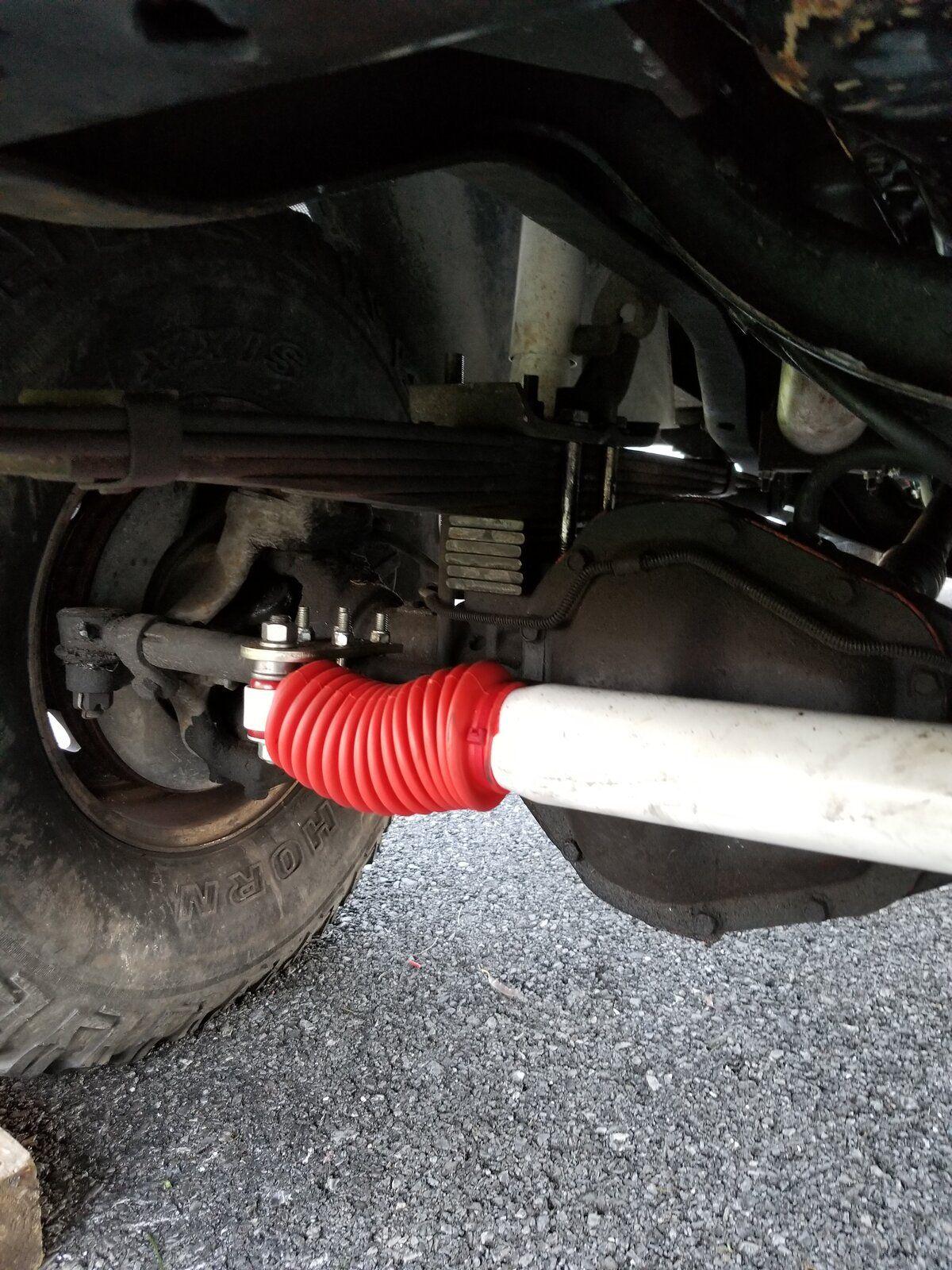

Well, had my helper assist me with the steering. Found the steering box is out of adjustment, maybe a loose drag link joint, and a bad driver's tie road end. None of those showed with the grab and shake, only show movement when turning the steering under load...the drag link may not be bad as it seemed tight when I pulled the drag link from the pitman arm.
I adjusted the steering box, the pitman arm shaft was moving in/out instead of turning when the steering wheel was moved back and forth. I've done this on other Dodge trucks, pop the drag link off the pitman arm, loosen the pitman shaft adjusting screw locknut, run the screw in while turning the steering wheel back and forth (you are making sure you don't get a tight spot in the center), tighten the locknut, reinstall the drag link. Mine actually bottomed without causing any change in the steering feel, so the box is probably worn. This screw is part of the drag adjustment described in the FSM. If this fails to cure mine, I have a replacement box the PO threw in when he sold the truck.

As you probably know, I just recently went through the same with a new rebuilt steering gear. Like yours, I bottomed it out with no change, still as sloppy as a $2 you know what... Then I started backing it out again incrementally until I finally hit the sweet spot. It seems ok now. The next long haul will be the real test.

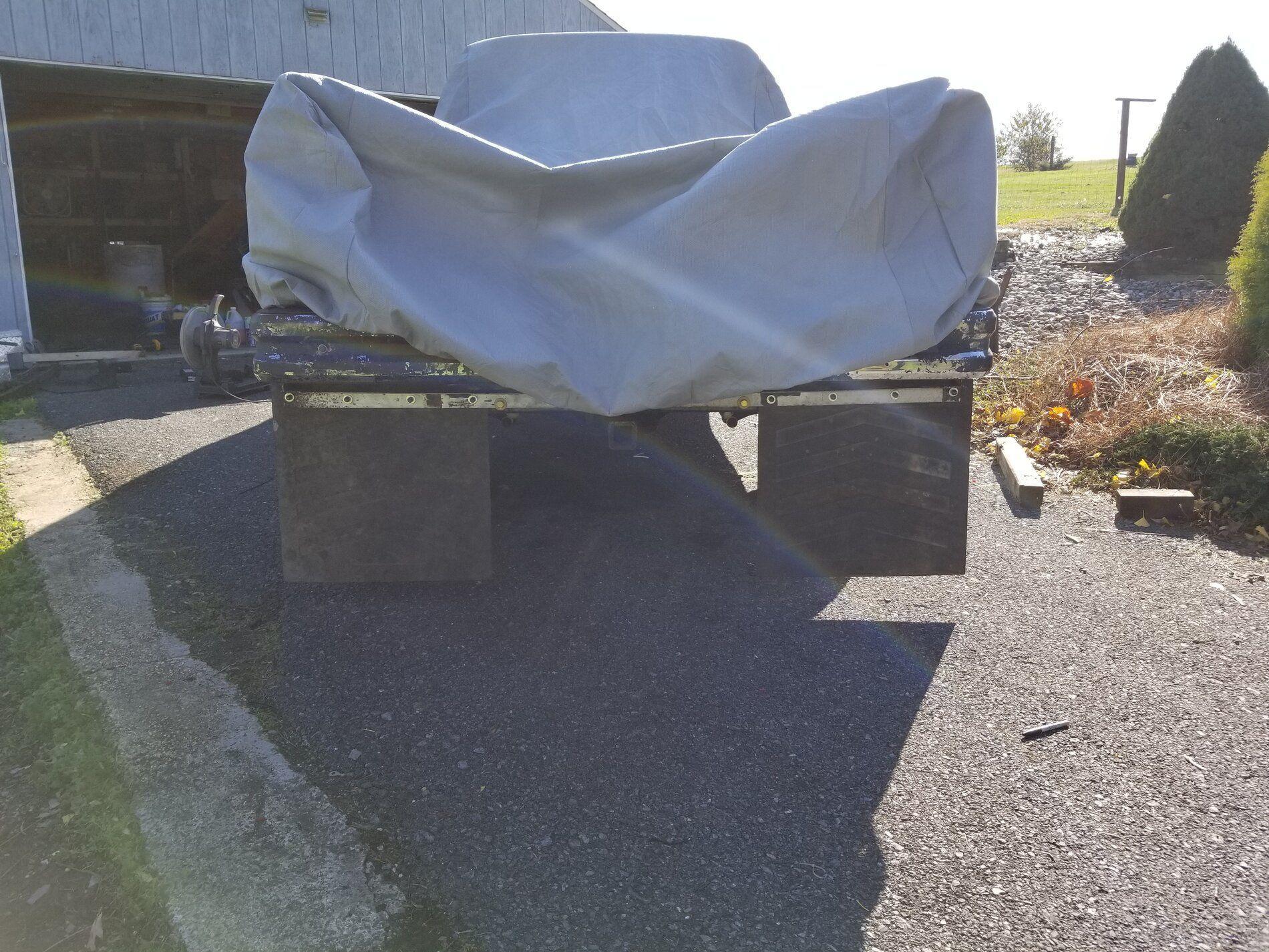

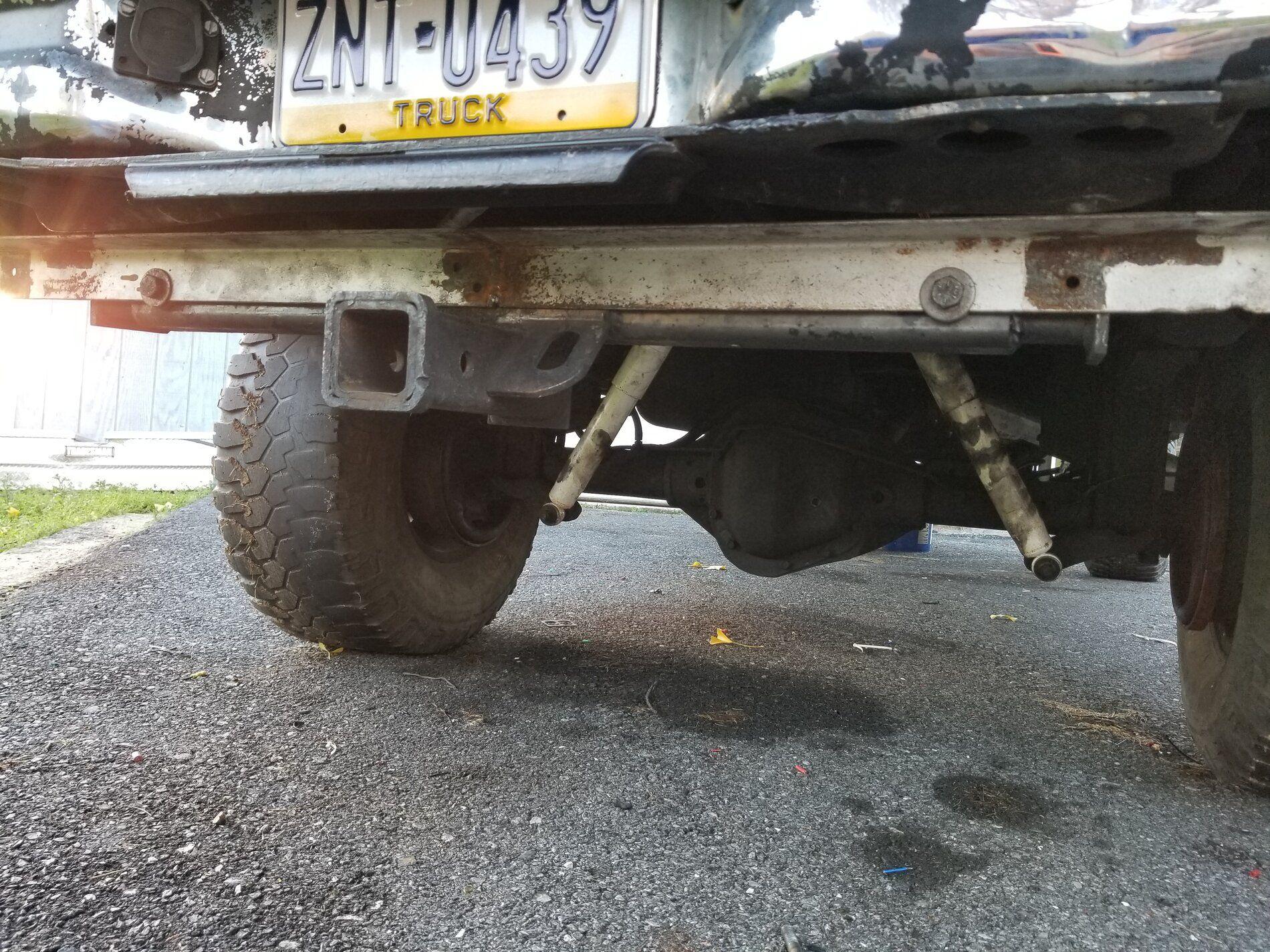

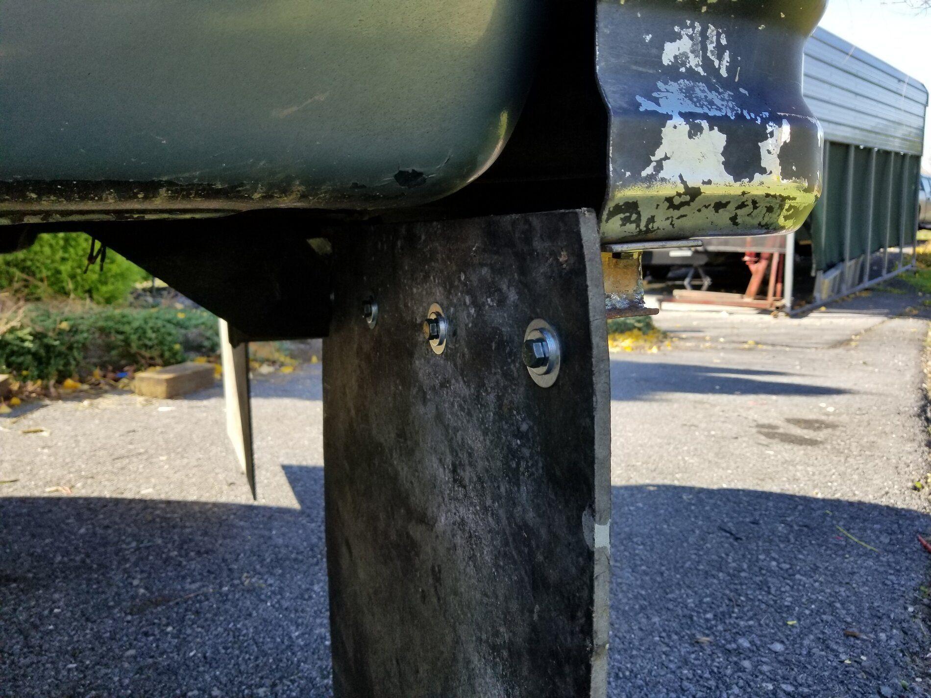

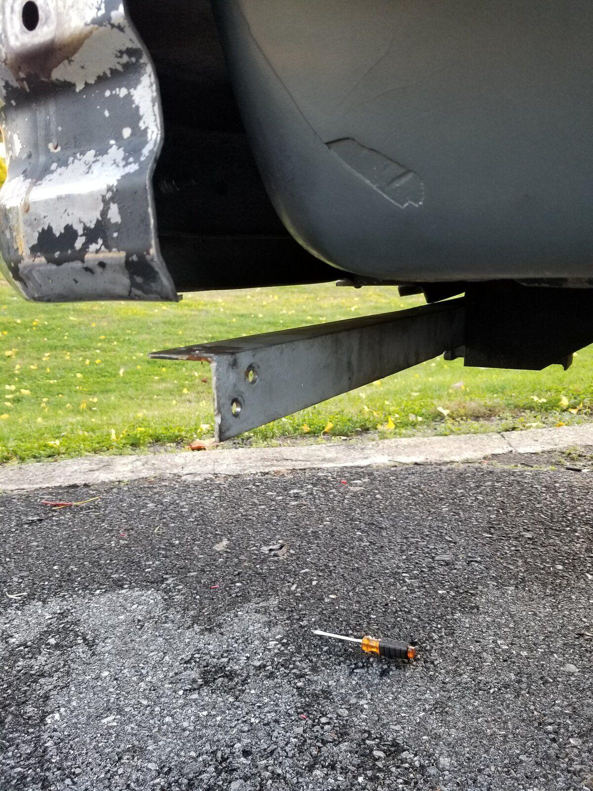

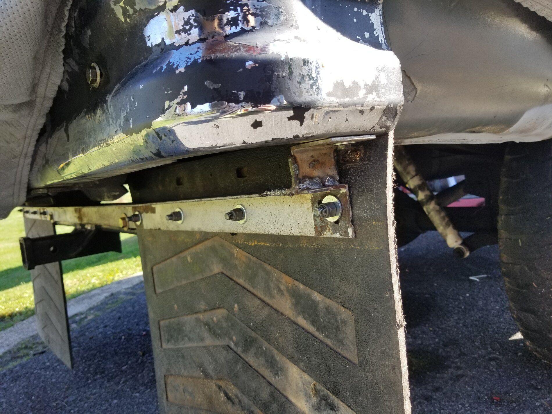

Well I did mudflaps, like the big truck flaps. The PO had some brackets welded off the rear hitch, one was missing...so I made my own. Completely bolt on, no welding to the truck.

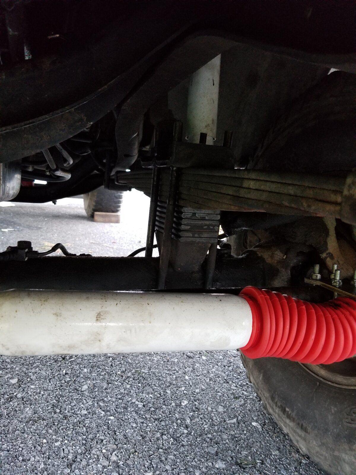

I also took the lift blocks out of the front axle, replaced for the time being with zero-rate springs.
Got to check the rears tomorrow, make sure they didn't stack blocks, add another leaf to their zero-rate pack, and replace my Helwig overloads.

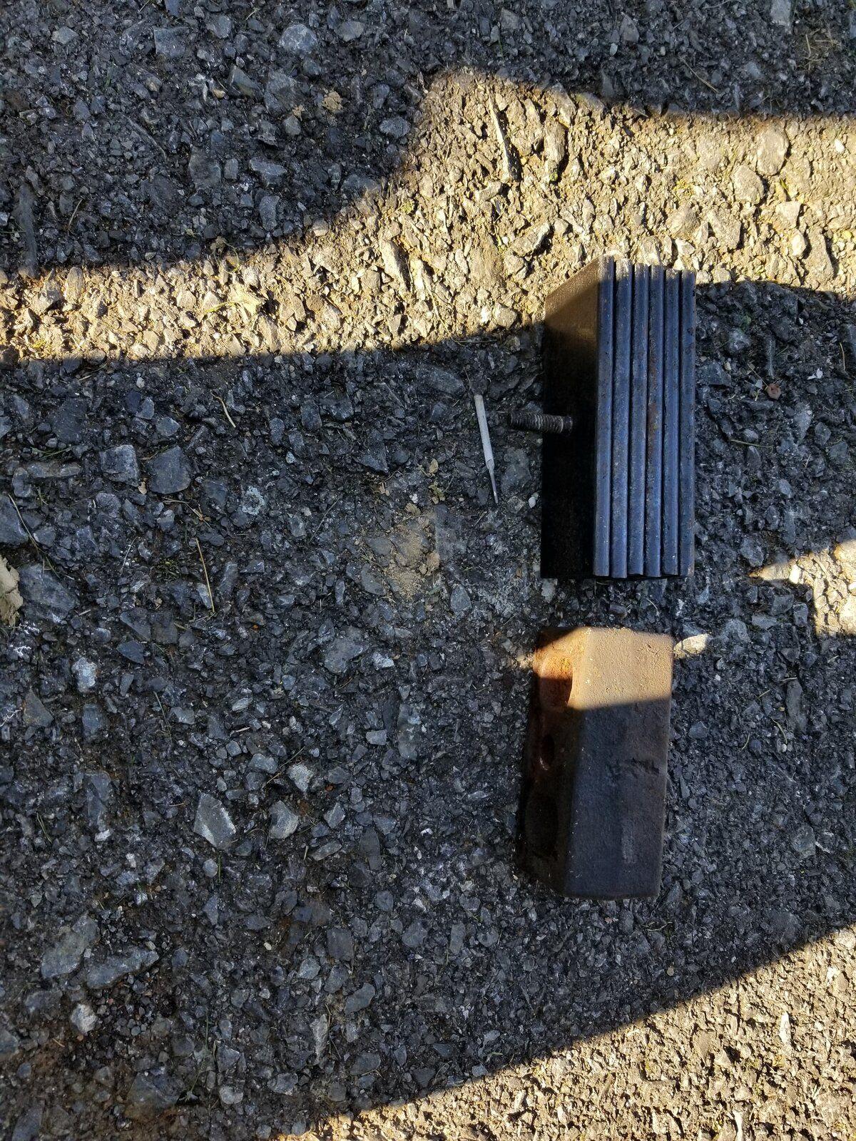

Well, tore the rear apart...stacked blocks.
Luckily the block was fabricated from mild steel plate that was welded together, and I was able to drill a hole through it and get it bolted to the spring pack.
So the rear is done...did these trucks really come with 7/8" ubolts? The bolts seem huge?

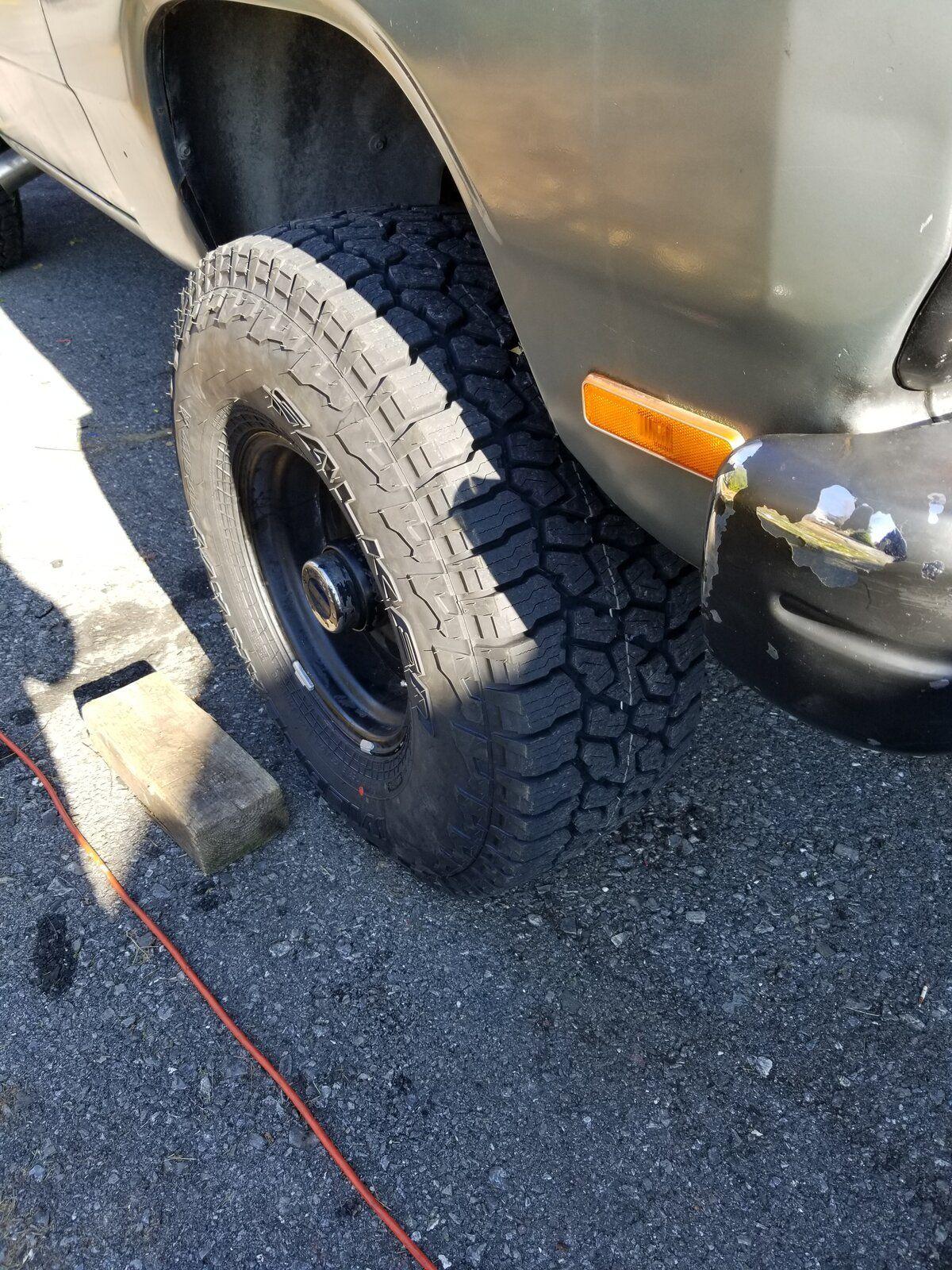

Tires Wednesday and a single tierod. Then inspection.

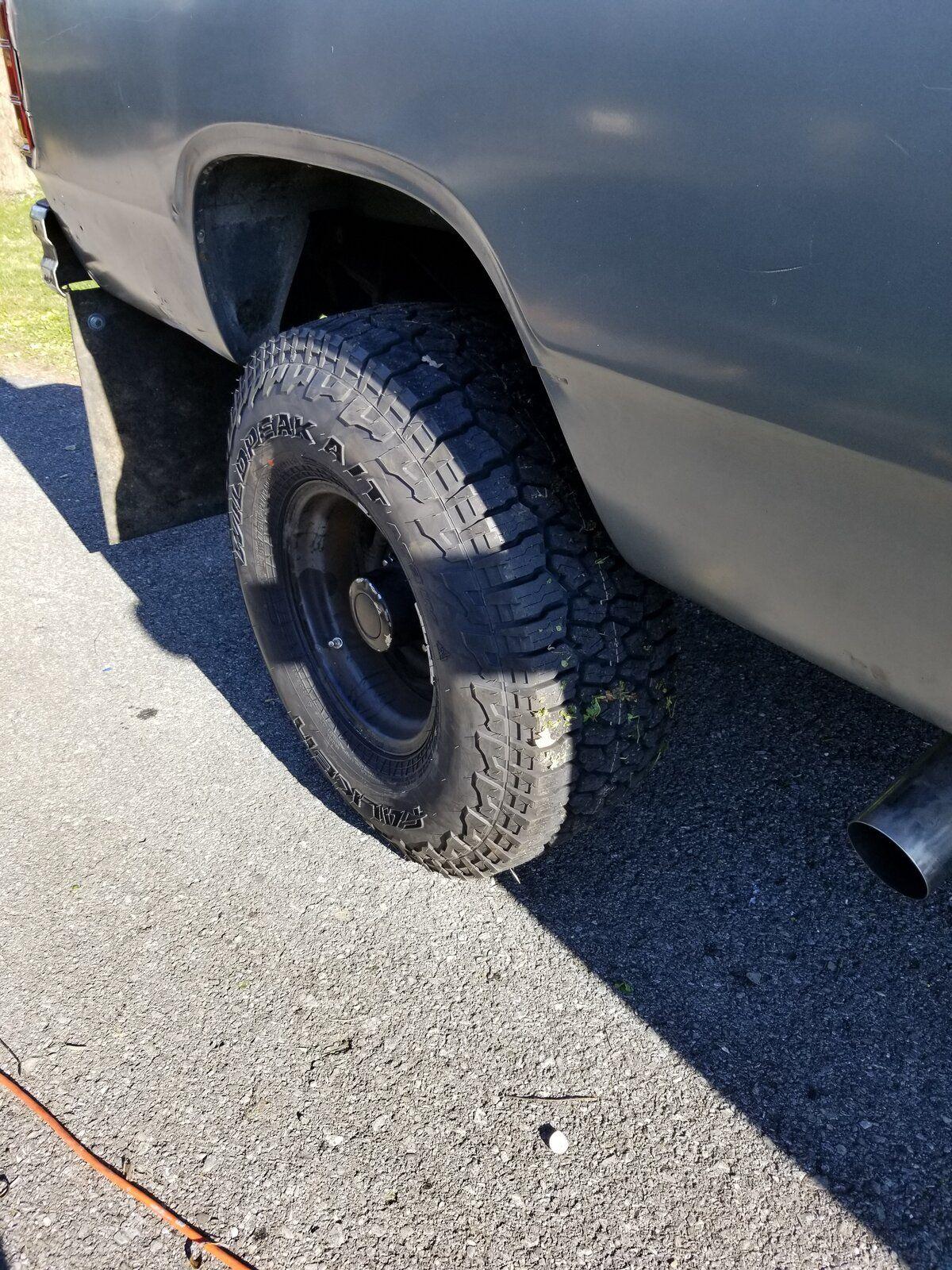

Tires today...going to pull the steering box off tonight and replace it and the drag link, and tierod end if I get that far...
Steering is better, but still feels very disconnected on a straight road...leaning into a turn feels good, straight feels disconnected. Flat road is ok, uneven road is constant correction. I mean, it will try to change lanes at times...
It has to be the steering gear box, nothing else is that loose.

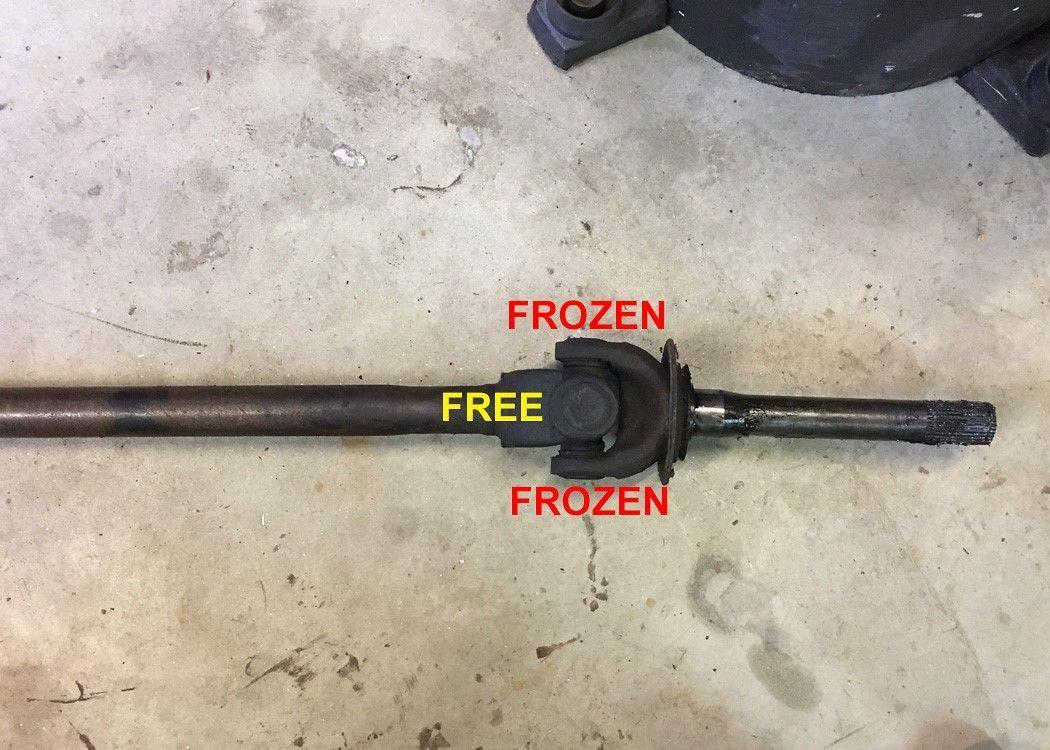

Your case doesn't sound quite as severe as mine...at least not yet... Mine did start the same way however. I initially blamed my steering gear as well, but I was wrong. The problem turned out to be one side of a universal on the axle shaft that started tightening up and eventually froze up entirely. Talk about dancing around on a bumpy road, it got down right dangerous after a while. Couldn't find anything wrong on the ground or on the lift, but once I decided to start breaking things down, the issue became readily apparent.
