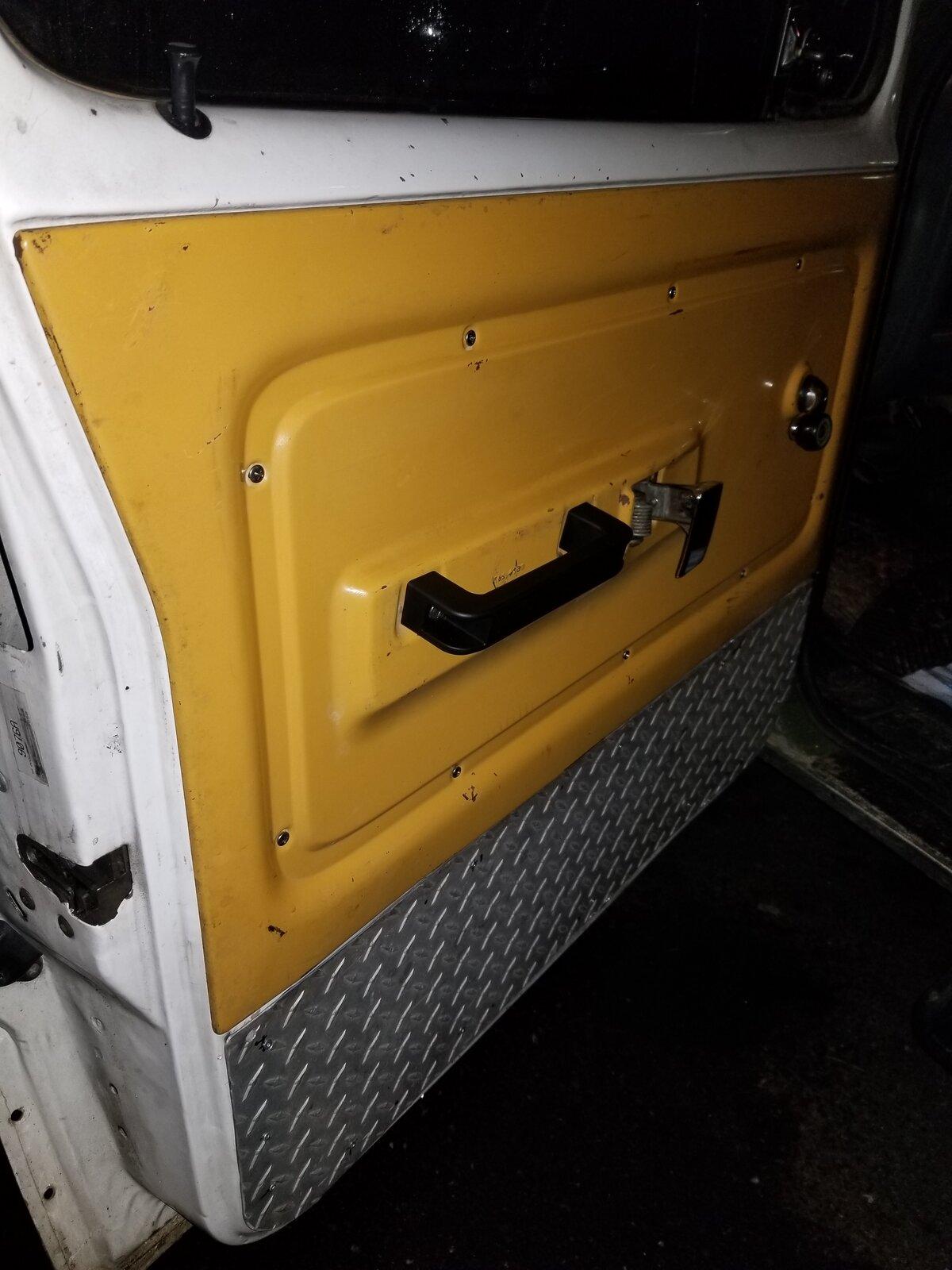

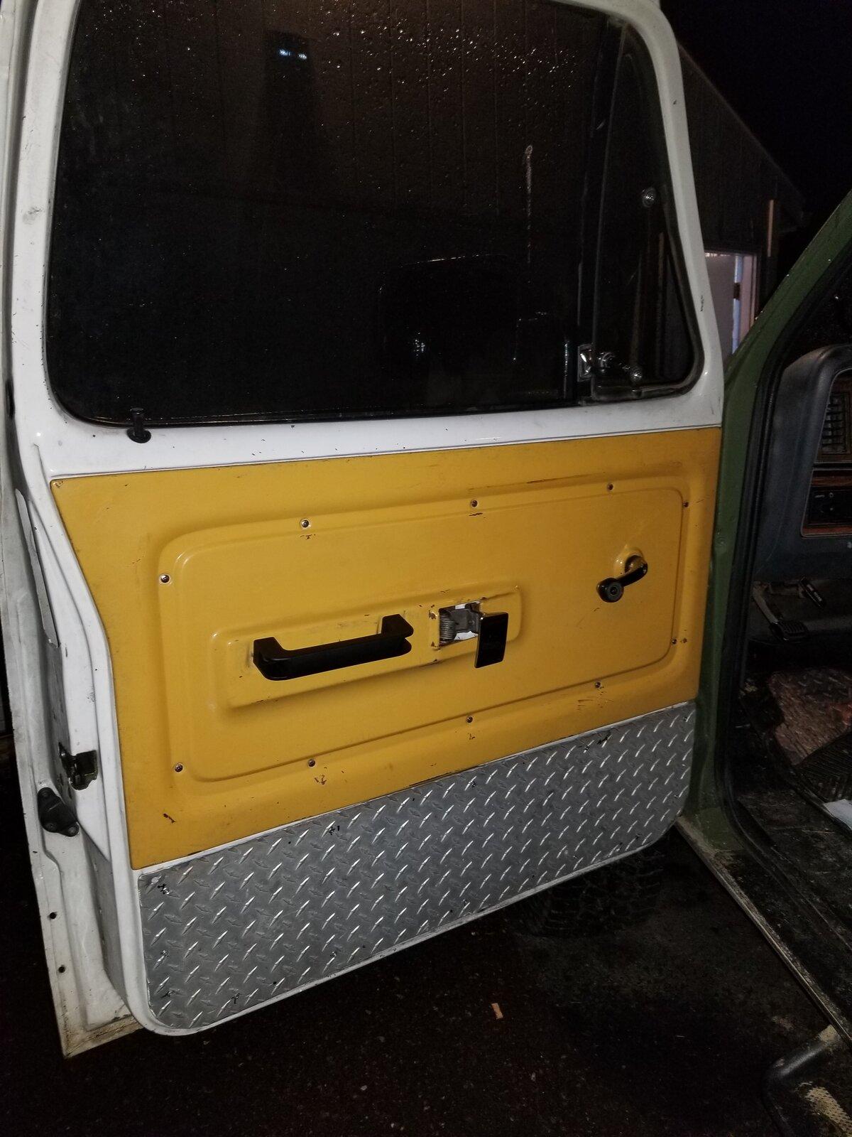

I like the door panels by the way... Clean and simple.

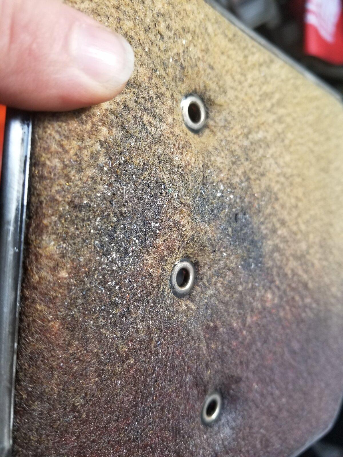

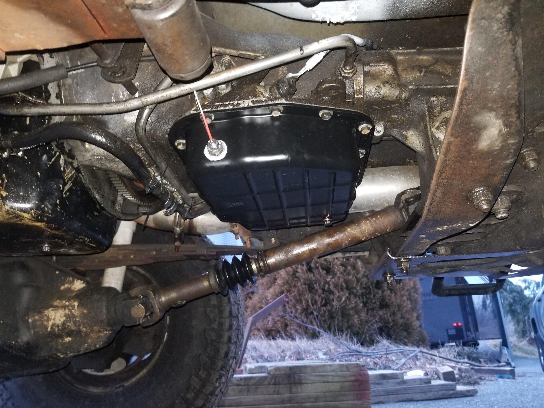

I dropped the trans pan, and found a lot of stuff...magnet had a lot of fuzz, a lot of sludge, a few flakes of aluminum, but no brass. This is bad enough, except that the filter had been crushed when the trans was set/dropped on the pan at some point and that in turn caused the filter to come apart...the PO had told me he just changed the fluid to Royal Purple, but clearly the pan hadn't been off in a LONG time. The fluid wasn't that bad...
I did adjustments, found the front band took five turns to get snug and the rear band took four turns to get snug...so they were loose, worn, or incorrectly adjusted. Both those were snugged to spec and backed off 2 turns.
I adjusted the kickdown adjustment (got it down to that 1-5/16" spec from the FSM, took about 3 turns) and the put about 1-1/2 turns on the line pressure.

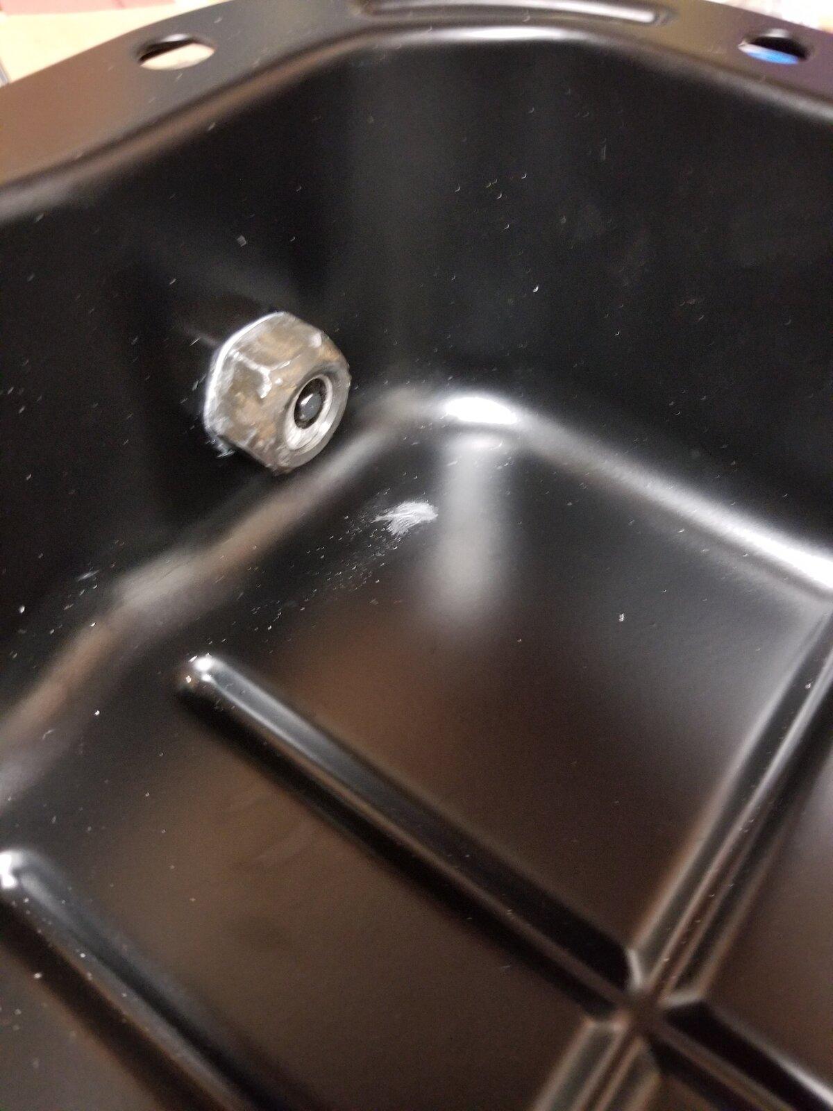

I used a new Dorman pan for a 48RE, which gave about an inch more depth, installed a new filter, filled the pan with Schaeffer's SAT, and done. I made a removable plug for a temperature sensor...took a 9/16" bolt left over from my steering box brace install, drilled, tapped, and cut it to length.
I can't really see any difference, it's not any better but it's not really worse. I was hoping to raise the shift points about 10mph and make it a little more driveable. I might play with the kickdown linkage and see if I can make a difference.

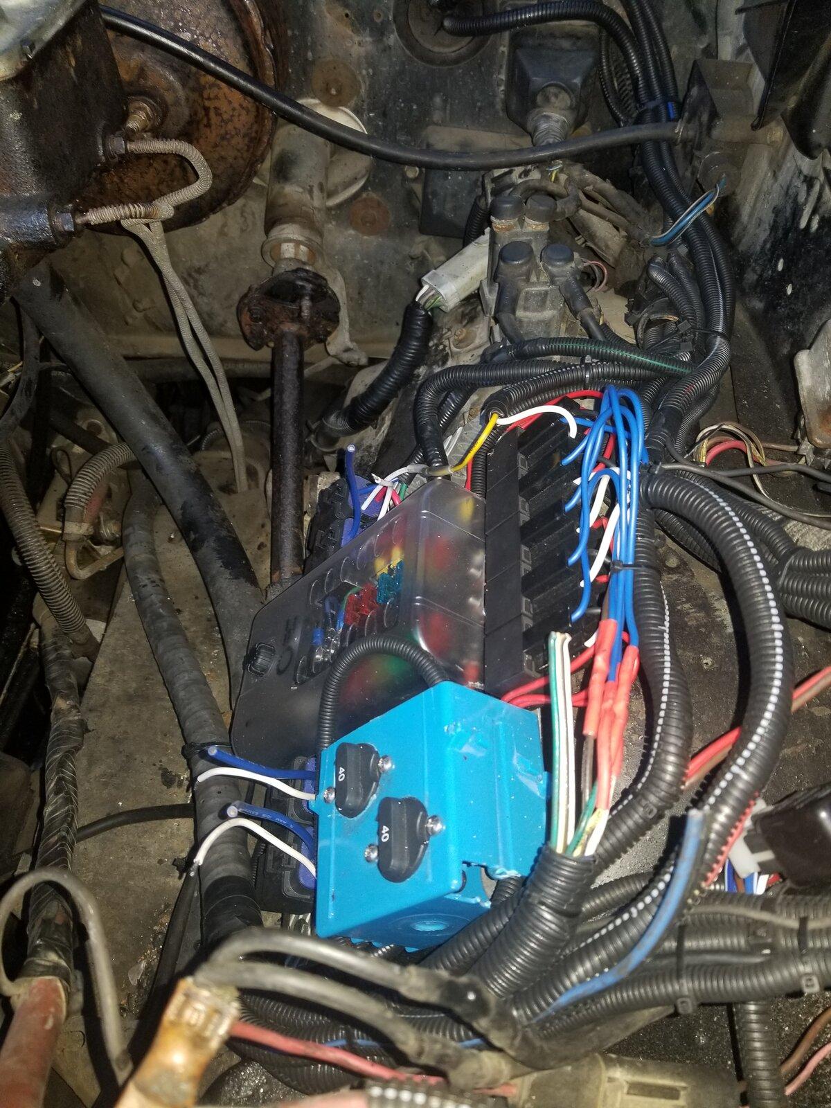

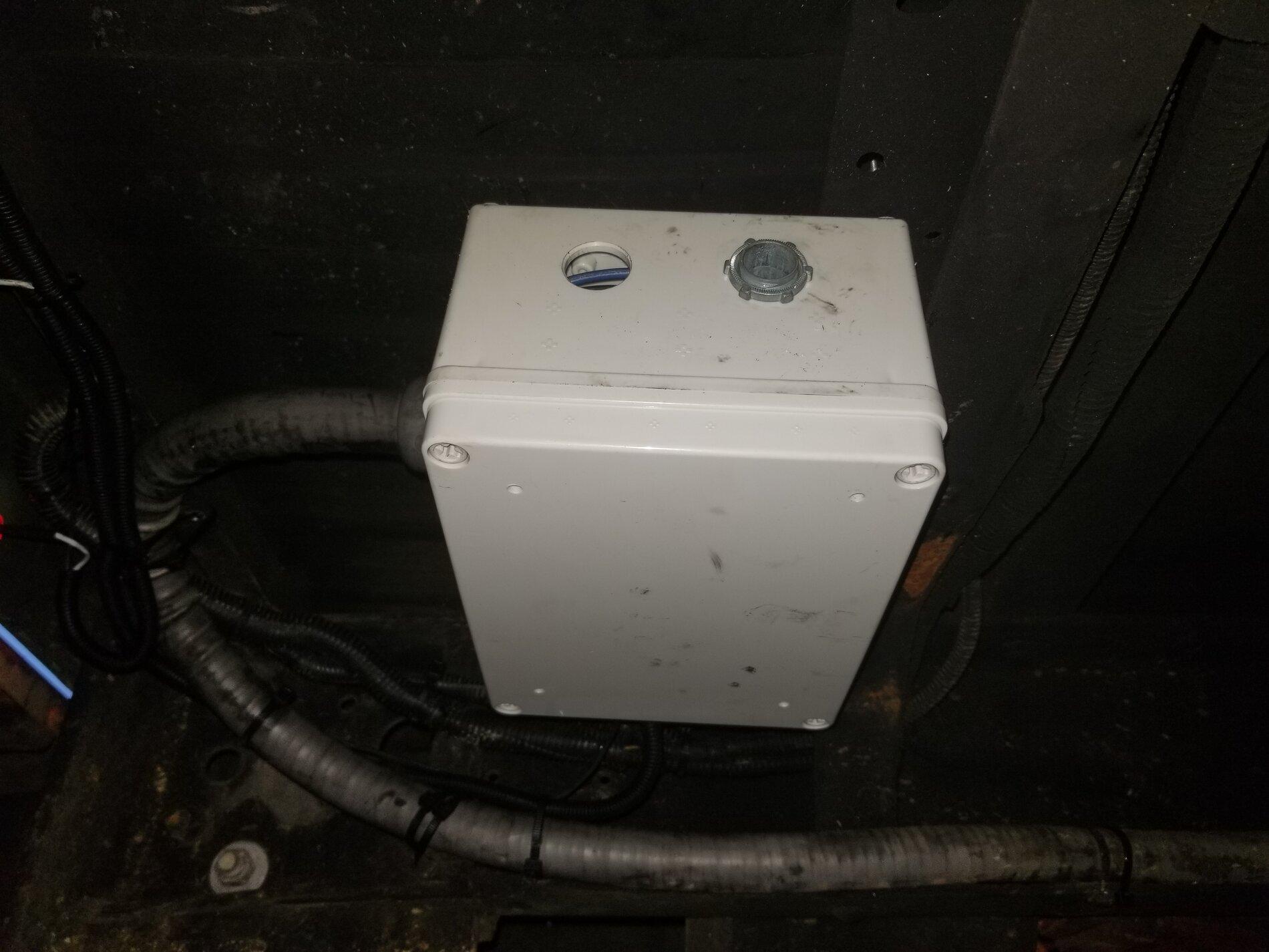

I did a little electrical work...installed a fuse block last summer when I popped a fusible link, the block was never meant to be used for the fusible links, but you do what you need to get back running. It was never complete because the fusible link failing wasn't in the plans ....relays for accessories and trailer lights were unused.
I had ran a 1-inch conduit from the engine compartment to the rear, filled that with various wire with the thought of running a trigger to the fuse panel and returning a trailer light circuit through a relay.
I installed a box at the rear to make all the tie-ins, I had previously installed pigtails on the truck's wiring when I was cleaning up the cobbled mess from the PO.

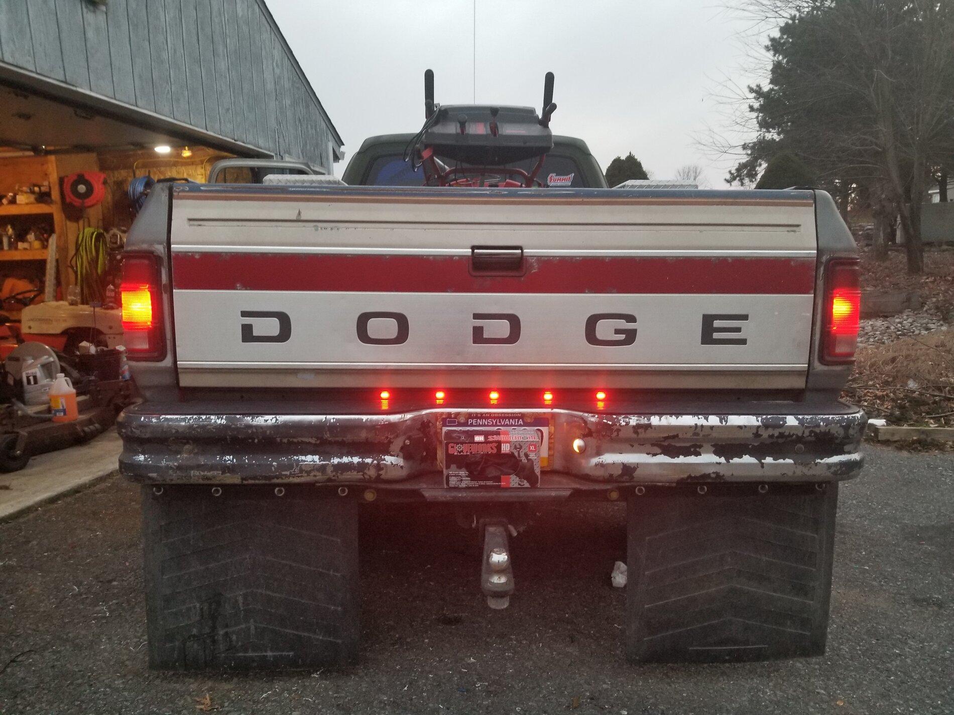

So all the wiring to the box is done, and I started installing some lights under the tailgate...I have plans of a headache rack and 7-way RV plug soon (got to build the headache rack).

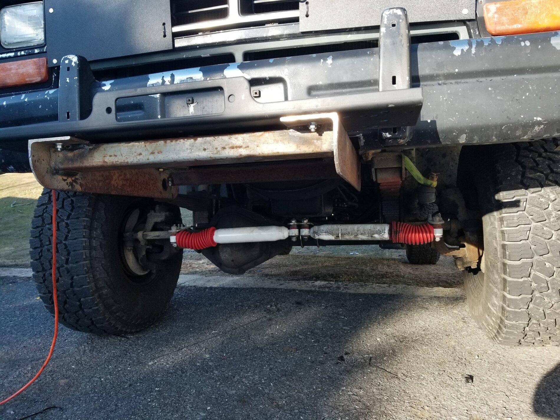

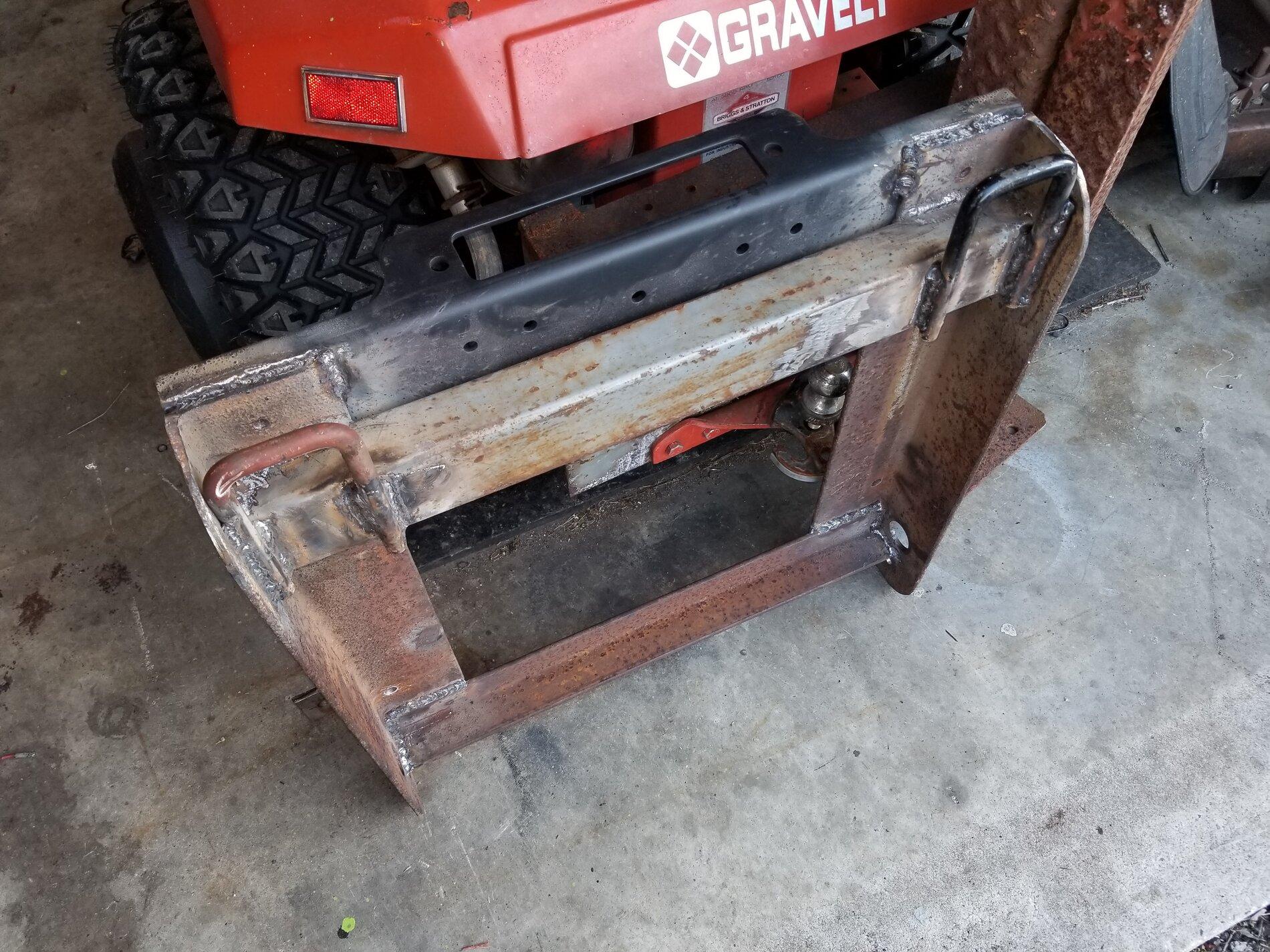

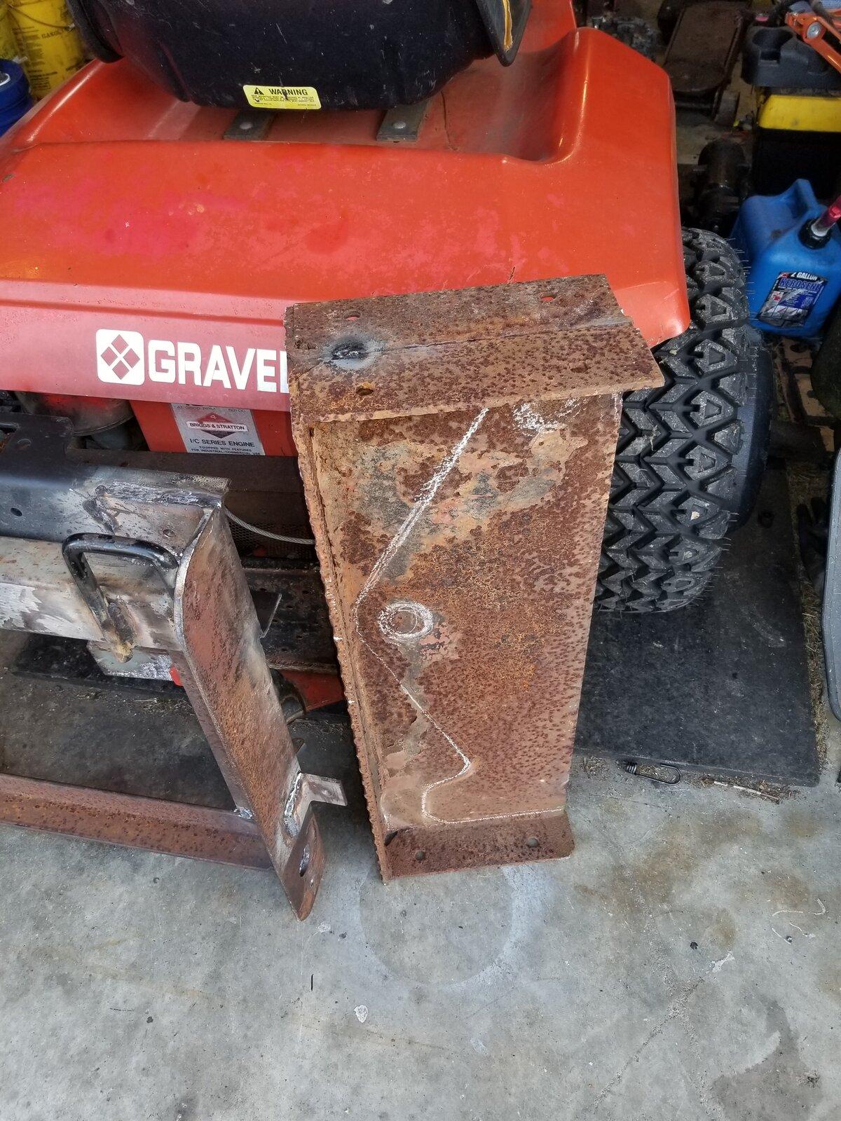

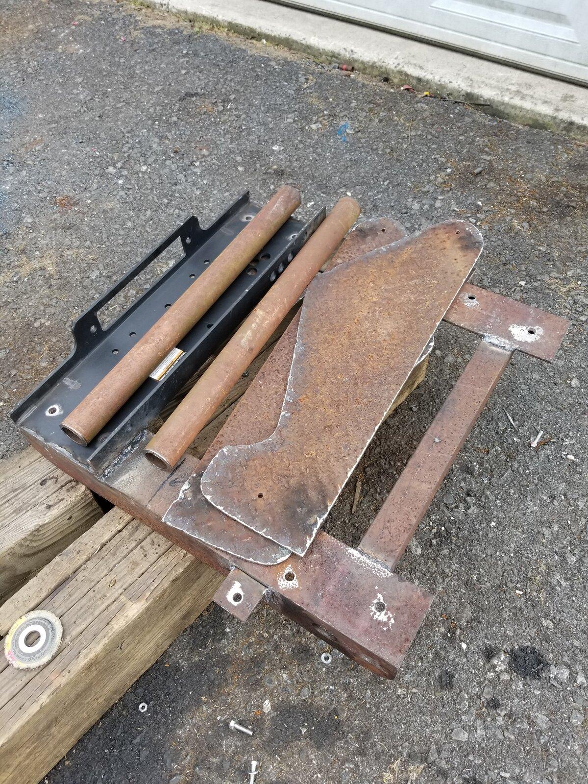

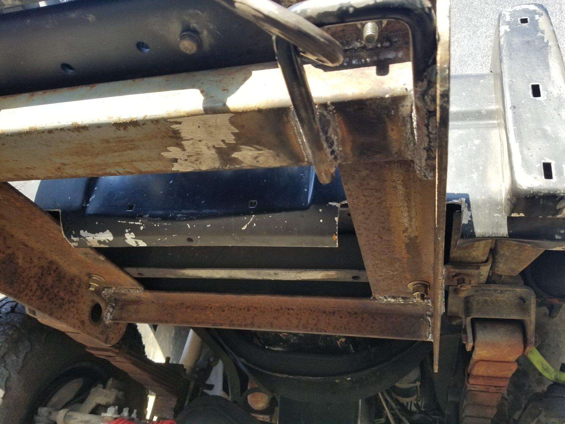

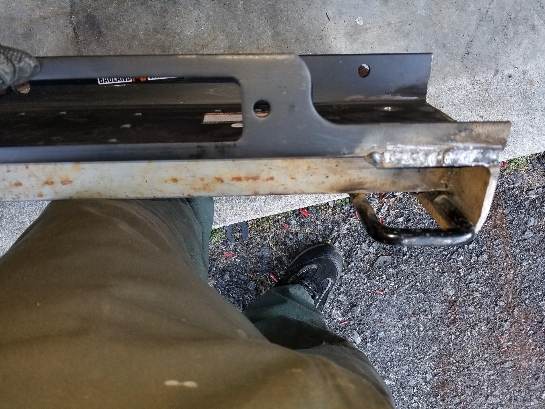

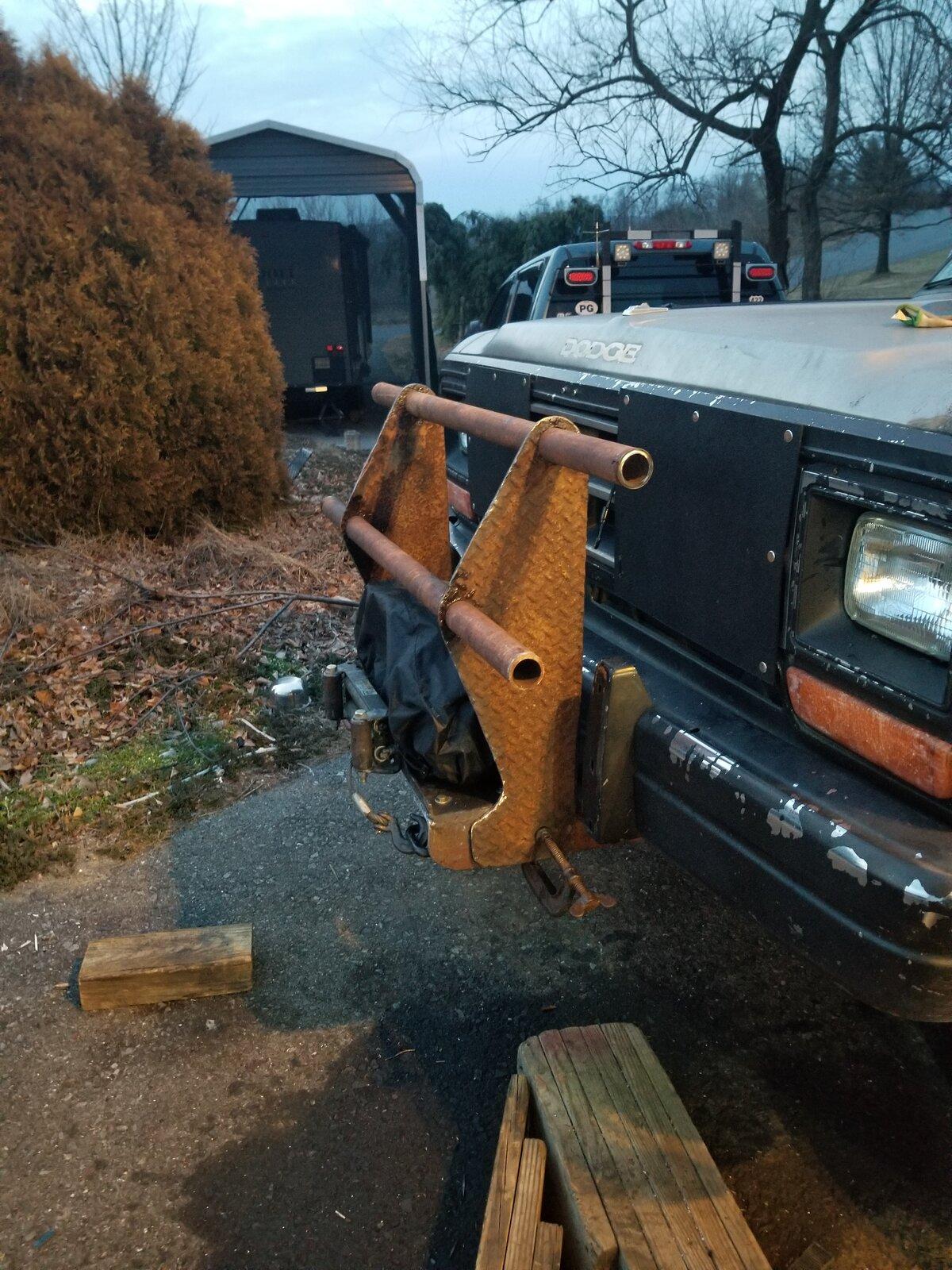

Started a winch mount and brush guard combo...go the main base done and the winch plate. I still have to cut the winch plate to width (it's only temporarily on with some 1/4" bolts) and cut side plates for the brush guard. And I have a couple tabs to fit and a couple struts to add for more strength...work in progress, not bad for an afternoon.
Got the winch plate cut down to width and welded onto the base, installed a couple tow loops, got the side plates drawn out (ran out of acetylene before I could cut them out).

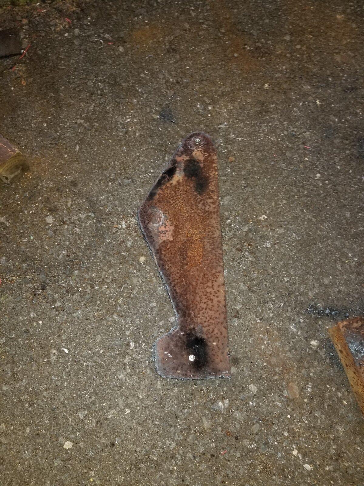

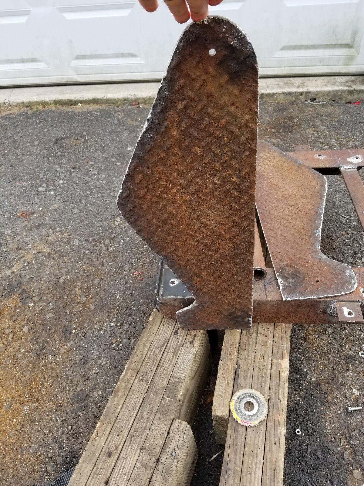

Side plates cut out...I need a new torch head, this one is about worn out.

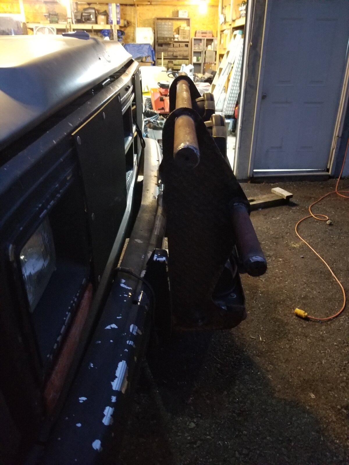

Just need a couple hours to grind it to final shape. Notice they are bolted and tack welded in place so that I can make them more/less identical.

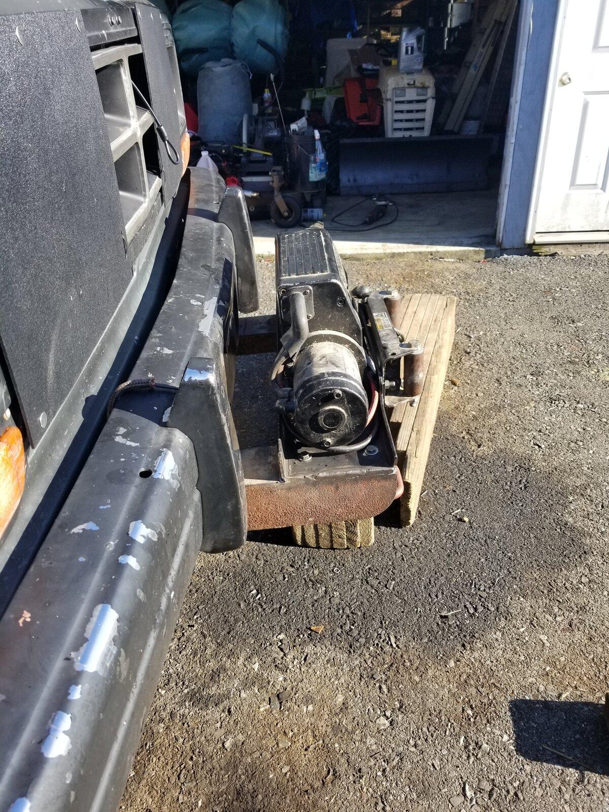

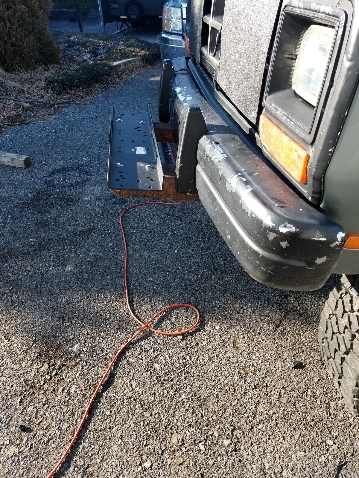

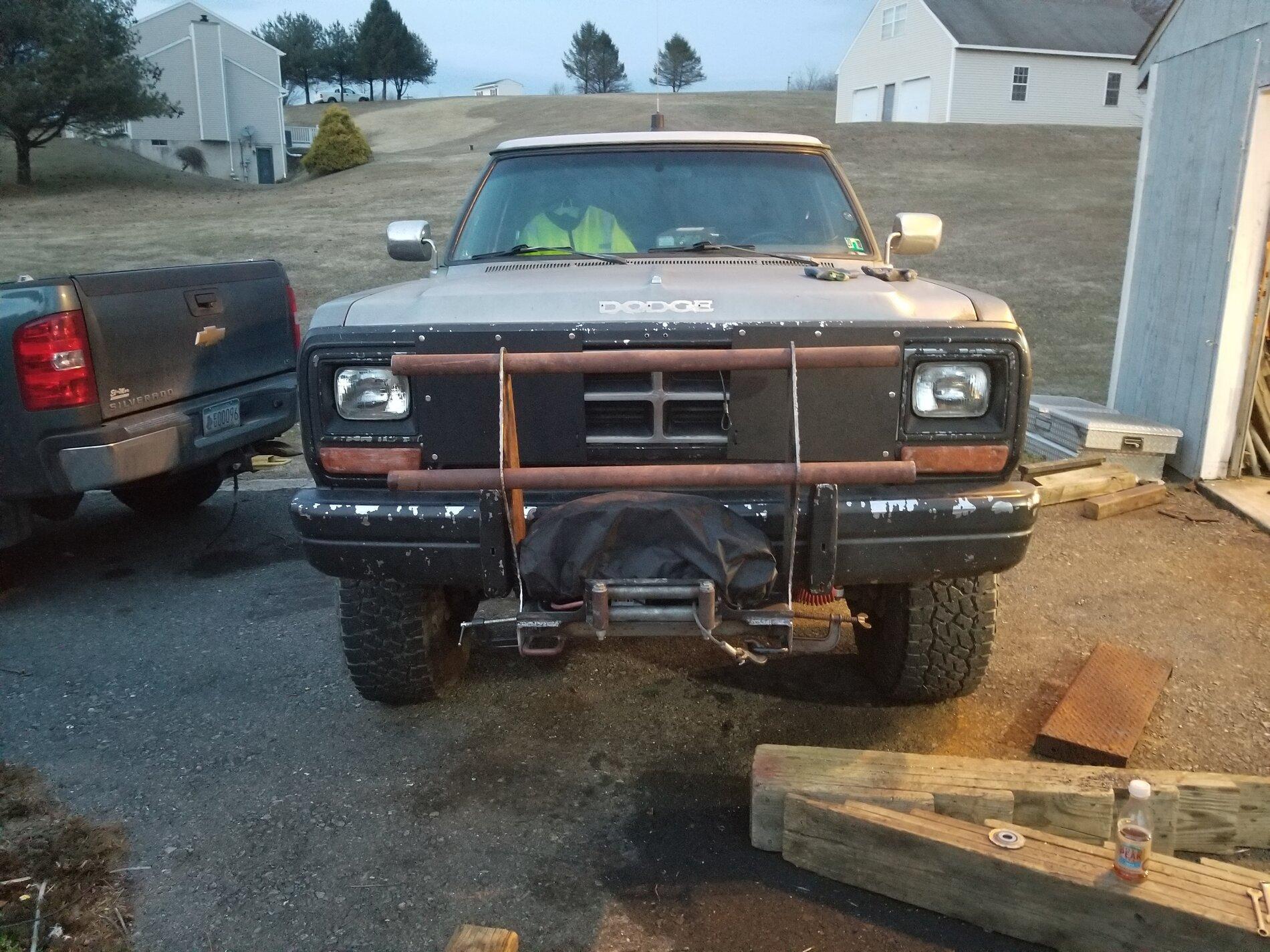

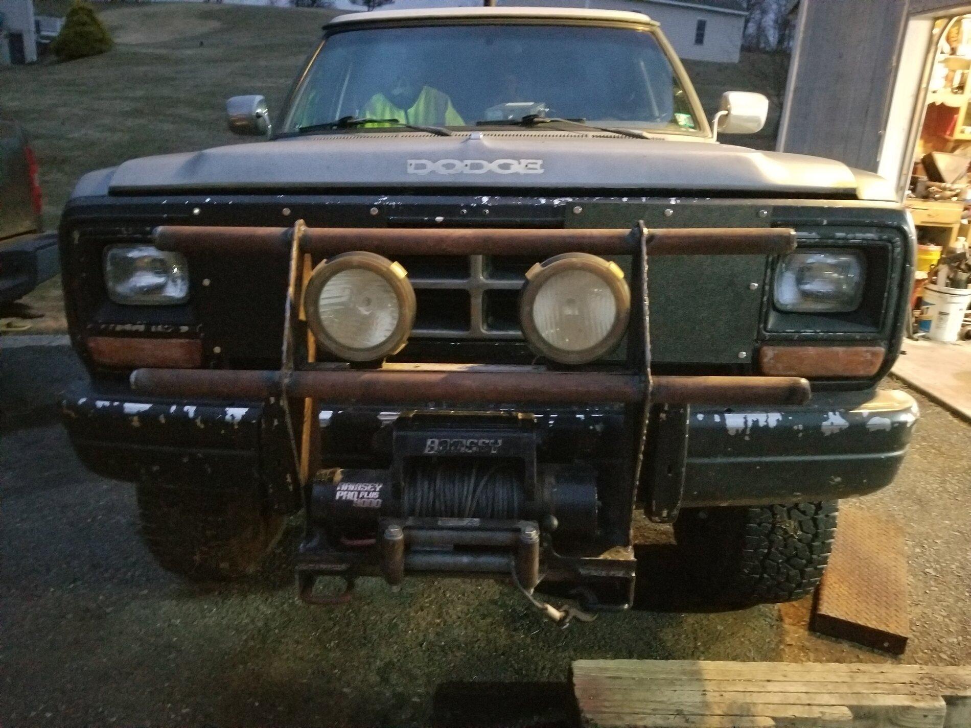

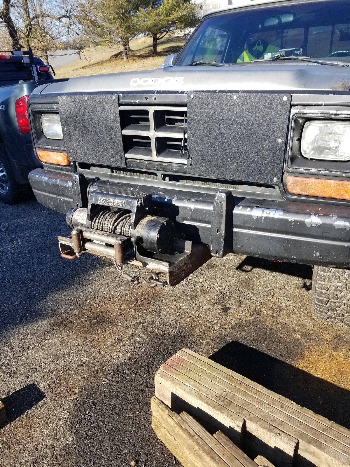

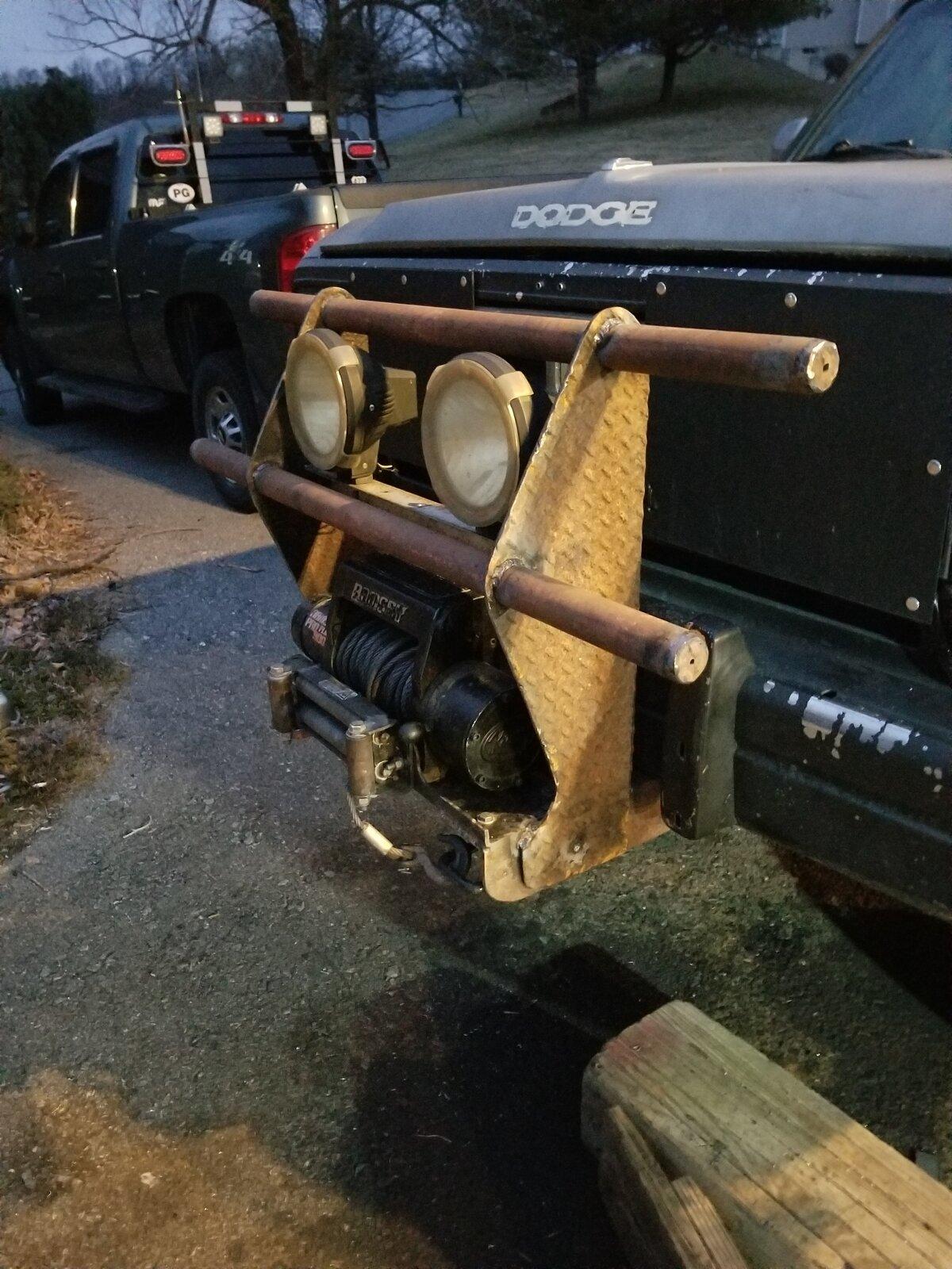

Mounted the base and winch...once it's all bolted together to show function, I'll take it off and have it blasted and painted (I'll do the body mounts at the same time)...
