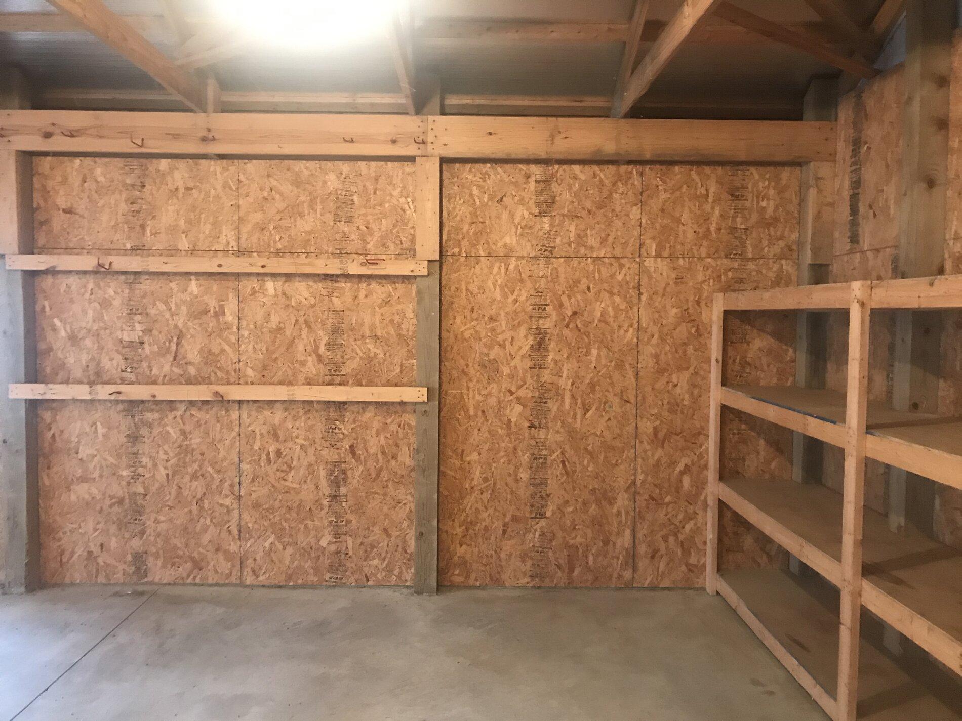

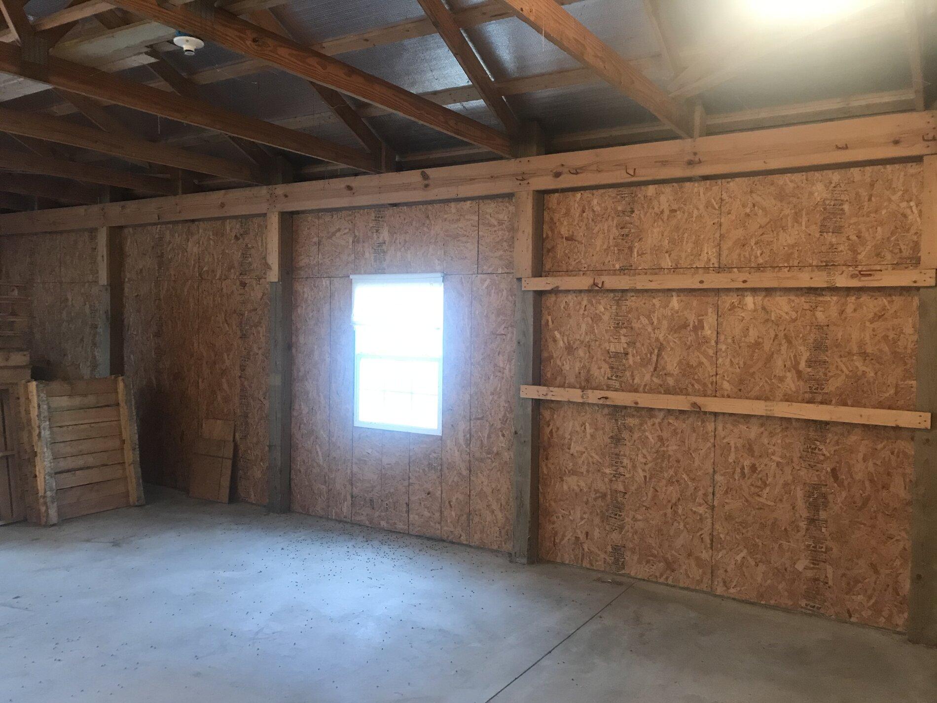

Here are a few pics of how it is now.
Good question - I think they are 2x6 spanned 36' wide. But... that is a "think".

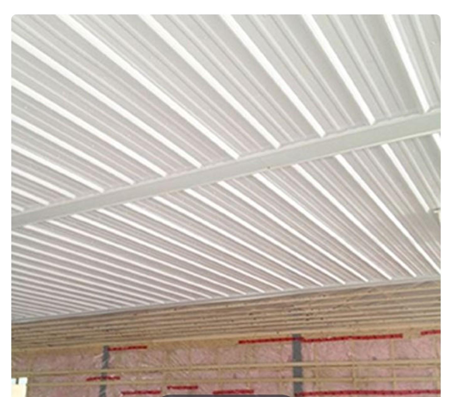

I like the PVC panel idea - easy, light, and reflective. I wonder how that would compare to a corrugated metal, which one would span 4' and not sag...hmmm.
Angling an I-joist between the existing 4' trusses with give you around 2" on the 36" span. So when in place they would sit on a little over 1/2 of the upper wall plate. However looking at the pictures you might be able to place them up there on their side, center them and stand them up, as it appears the roof overhangs the walls a little.
