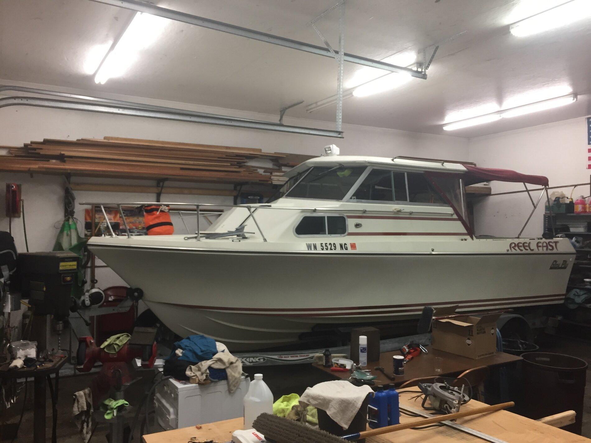

I just re-read your original post, and I would sheetrock the walls as well instead of using the OSB whoofie board ....I hate that stuff on an interior wall...nails bounce back at you, splinters, harder to paint, etc...

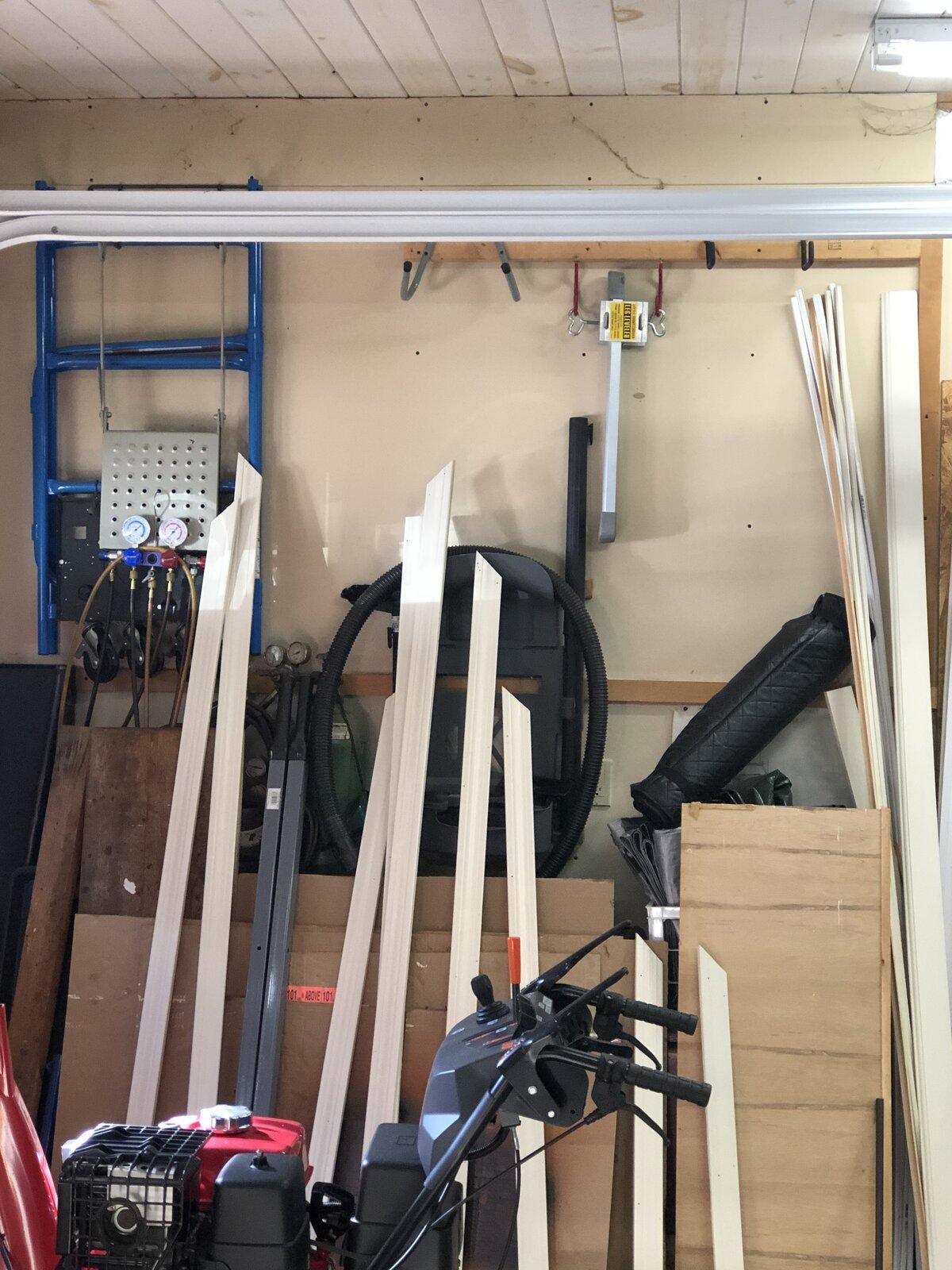

Forgive the project mess but my walls are sheetrock with boards over the seams.
Garage is kept at 50° all winter unless I have a project. Overhead door is insulated as well.
I use a Monitor heater, was going to add a zone for the house furnace to heat it but really not necessary.
Also don't know how much headroom you would have between O/H door opening and ceiling but I use low clearance doors to get the track closer to the ceiling...

I really like the pine board strip idea to not be concerned about cracks in the drywall seams and I HATE mudding a ceiling!

I primed OSB with Kilz and painted one coat gloss white paint then installed with drywall screws then hit with another coat of paint. Surface ran air lines and electrical.
