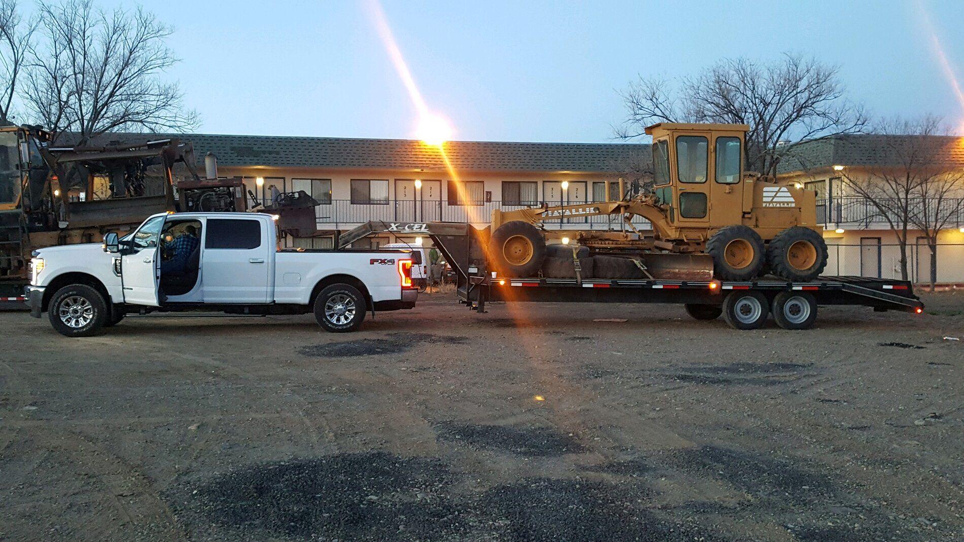

My brother bought a new F-250 this year with 3.55's the lowest offered. He didn't think he would like it but after towing this from Raton, NM. to Ashland, Mt. (700 miles) he thinks he will keep it:) He said he stayed in 5th all the way, with 4th gear on the big hills. He said he did drop to 3rd right at the top of Raton pass because the temp reached 225* this was at 50 mph. He got 6.9 mpg on 640 miles. We towed it to Raton from Snowflake with a new F-350 dually w/4.10's. It was like it wasn't there. The steep hill into Santa Fe was 5th at 58 mph. We got 7.22 mpg in a 300 mile test.

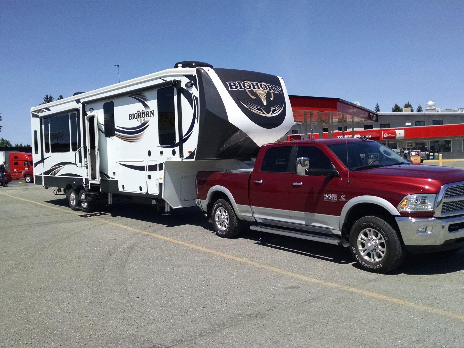

I will run a little faster than 62 with my camper, but definitely not 80. There's just nowhere I'm in that big of a hurry getting to risk running that speed with a top heavy wind sail like a 5er.

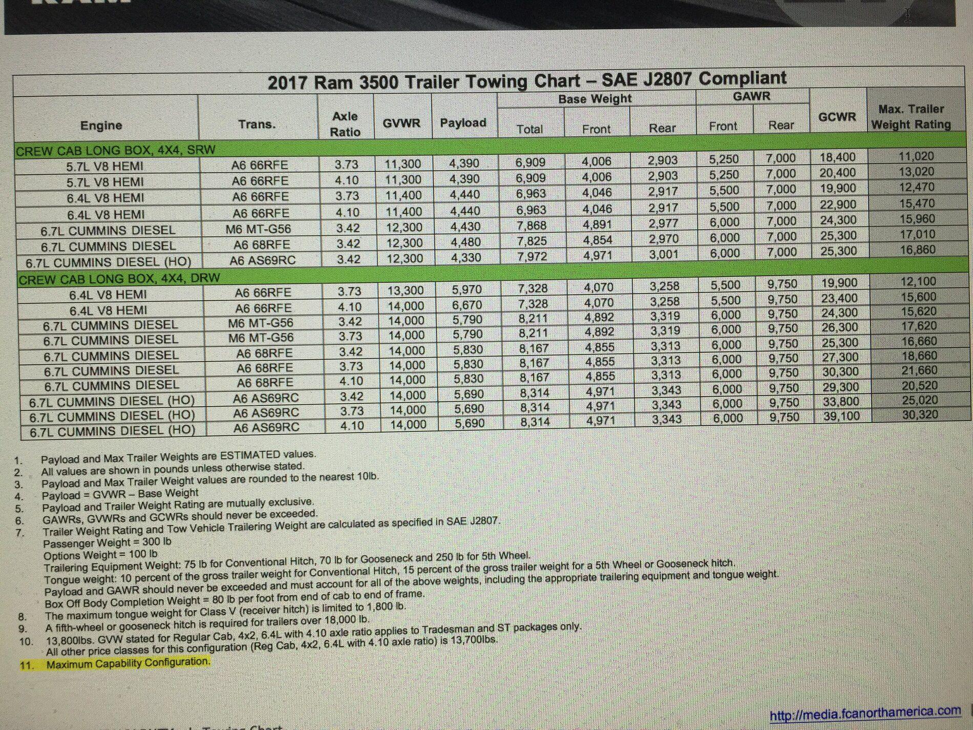

Anyone want to take a gander at my window sticker and tell me which gear ratio my truck actually has? It lists 3.73, 4.10 and 3.42. I'm guessing since it's a max tow package it's actually the 4.10 (I was reading another thread about Aisin optioned trucks and it lists max tow package as 4.10 only) not the 3.42? I'll pop the hood when I get home later tonight.
