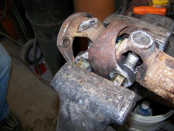

I always just use a vise.
Same here.
Vise, big MF hammer and good aim.
If you are not comfortable using the hammer method you can use a hollow spacer (or socket) and a deep nut and make the vise the press.
Like this...
Mike. :)
