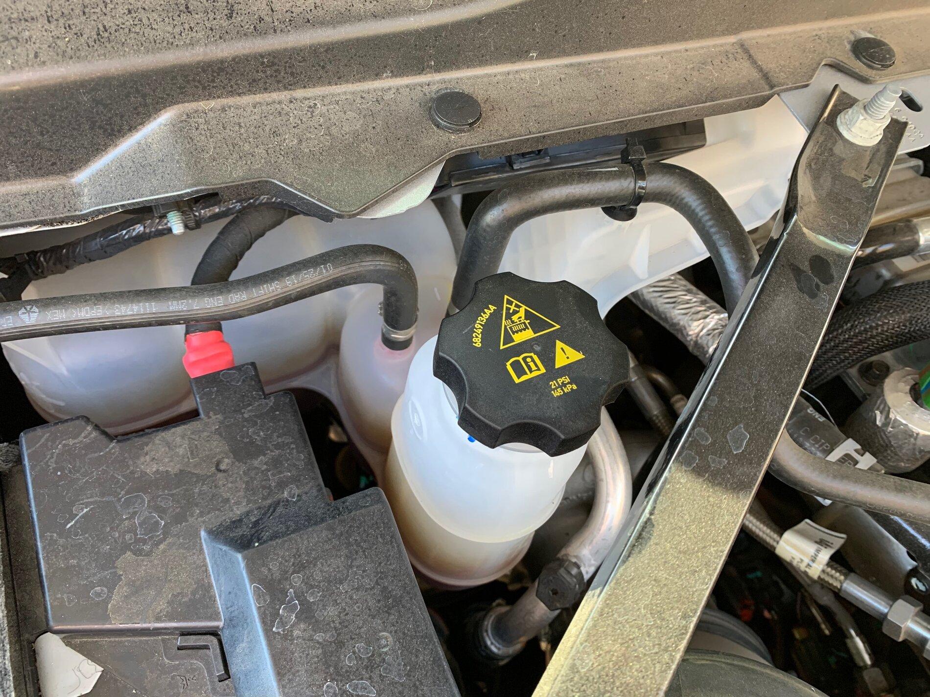

I was taking a picture for another thread and got to looking. I have no clue what this is or what it does. Can someone clue me in? I am thinking it has something to do with the pollution control.

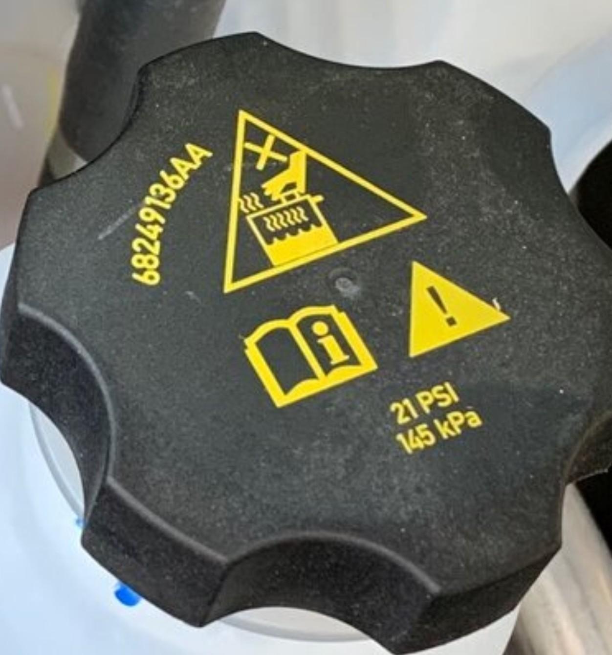

Yes sir. If you look at the picture on the cap, it shows a crude picture of a hand about to open a hot radiator.
It is under pressure when hot, unlike the older "overflow bottles".
21 psi cap.
If you open up the coolant system, drain the coolant, how do you refill it? Vent the entrapped air? They removed the traditional radiator cap. The owners manual indicates a dealer service issue. Just asking for a friend.
When I replaced the actuator on my 14 I ended up replacing roughly 4 gallons of coolant. I simply removed the upper radiator hose from the engine side and filled the radiator until full. Installed hose, topped off overflow bottle and started truck. From there it's a matter of topping off the bottle as the thermostat cycles.
Well I hope a Mod comes up in the next 5 years to be able to refill the system because I am NOT having a stealership do it.

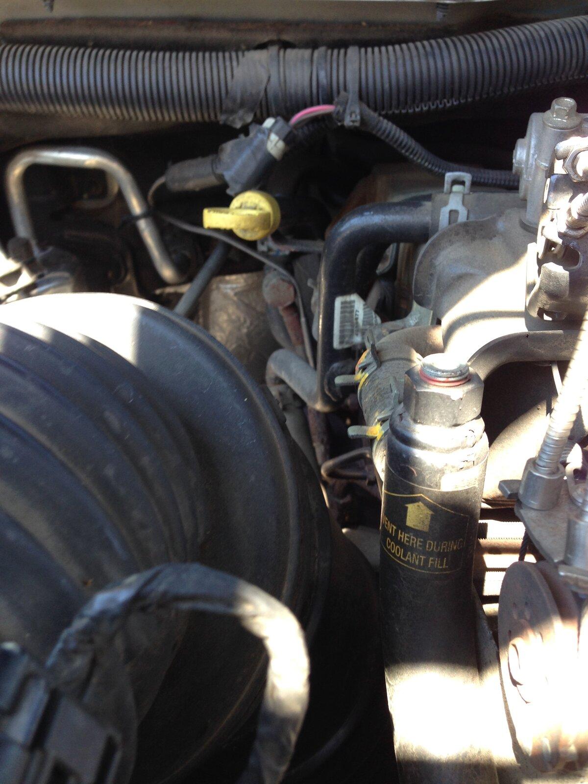

Isn't there a bleed tube on the passenger side of the engine about mid-point? I know there is on my 6.7L engine that is used to let air out of the coolant system. You would need to remove the plug in the tube to let air out. See pic
