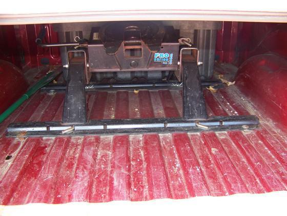

The only thing I would like to add to the above is the Mega, due to it's long wheelbase, does not turn as short or as quickly get one into trouble like a quad cab shorty will.
It can still be done without a doubt, just harder to do.

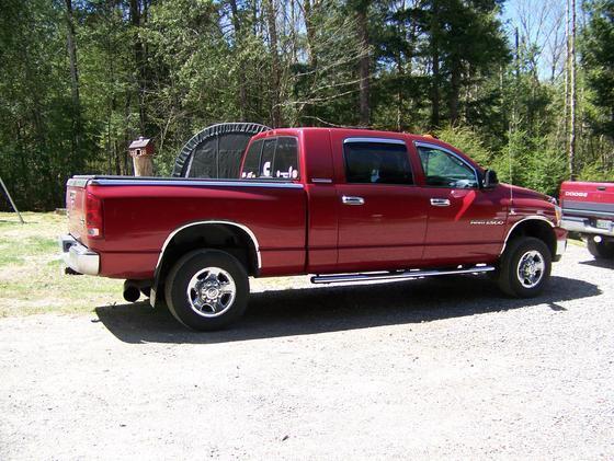

No slider hitch on mine. I will buy one the day that I can't put the trailer down front for the winter anymore without damaging the cab.
This truck
using this hitch

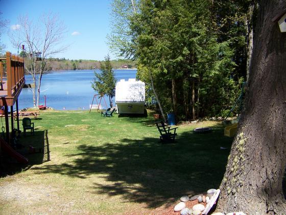

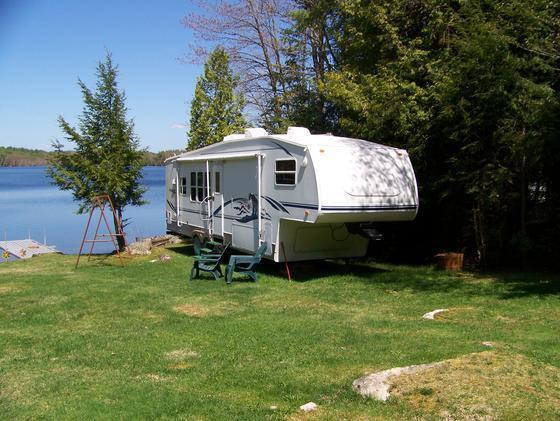

puts this trailer
down here for the winter
Mike.

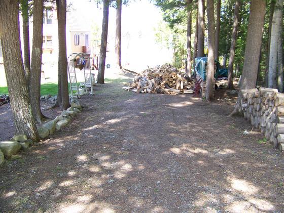

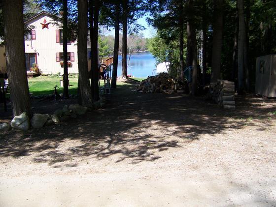

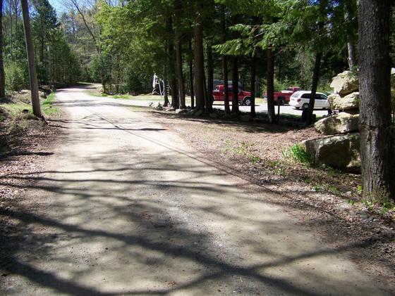

around this corner to the right just beyond the rocks
through here

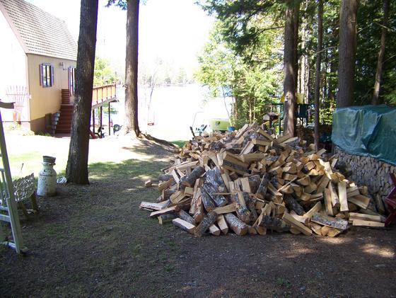

and here
and here (Firewood just showed up, gotta' pile it before the trailer will come out)... ...
So you can do quite a bit without a slider on a Mega... IMHO
