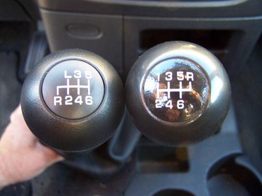

Kevin,
Agreed, and possibly easier to ID by looking at the stick. G56 REV is a knee knocker. When I bought my '05 I wanted the G56, it was new and I just wanted it. Checked with the Dodge salesman, oh yes sir it will have the new transmission you bet. Came in NV5600.
It's nice having reverse close by in case you need to rock the truck when stuck. Never hit my knee and I'm 6'4". If it just had an iron case...
I want one of the G56 gear knobs for my NV 5600, so when somebody trys to steal my truck and look at the shifter for the gears, they can't find the correct geat for reverse. What ya think?
6speed,
I think the best one I saw was a 1st Gen 4X4 with a custom twin stick gearbox. Not sure what its formal name was. We had a dyno day on '07 and Dave D. owned the dyno, that twin stick 1st Gen around the world twice survivor truck with 3 sticks had Dave in a what stick is next quandry. the video shows him hunting for the next gear.
But why did Dodge change the markings from 1-6 to L-1-5? Acknowledging the ratio change?

Correct, 05. 5 was the changeover from the NV5600 to the G56 as well as the plastic end-capped IC to a all metal one.
Kevin,
Thank your lucky stars you did get the NV5600. IMO it's a better, stronger and more reliable transmission and it doesn't have the DMF.
george
215K on mine with the AMSOIL, coolers and over fill. Been towing heavy 25. 5-27K for about 4 years now and no problem with the NV5600. Runs about 185 when towing in 5th over. In 6th over it might get up to 205 on a hot (90's) day.
2005 late July they started to go into the trucks. I had an 05 that was built in July it was delayed due to the transmission change. It didn't make it to the dealer until Sept. As for reverse being close I found it way too easy to drop it into reverse rather than 2nd. It makes the guy behind you at the light all that happy... .
