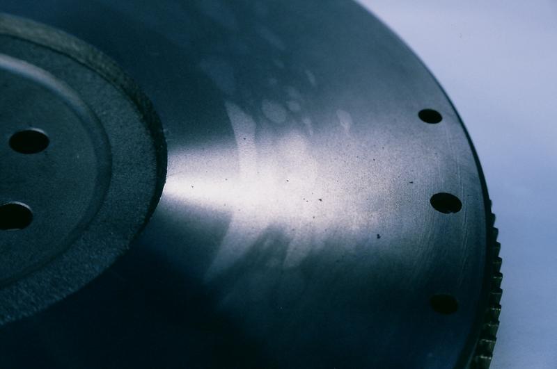

One of the clutch mfgr's actually printed a bulletin years ago describing the WHY behind the concave castings. At first it don't make sense but it actually can help because if the castings are slightly concave the contact to the disc starts at the friction material OD, starts the disc rotating and then as it continues the clamping process compressing the lining springs you wind up with a fully clamped disc that saw very little RPM differential when the ID finally clamped. This often looks like the ID wasn't making as much of a contribution to the clutch as it shows less heat marks or apparent wear. The other benifit is that as the castings get real hot and try to expand its claimed that the casting goes flat from heat and still operates well. The BIG thing to inspect a reground F/W for is never accept a convex (center higher ) surfaced F/W this is a reciepe for a slipper. The other concern is deeply imbedded hot spots. The surface looks good, but the hot spot became Martensite and that is some bad stuff. Harder and actually expands upon higher heating and forms high spots. Major contributor to chatter after several months of no chatter service then it shows up. Bad stuff.
This GM F/W has been resurfaced and you can see the shadows of the hard hot spots clearly in this pic. If you're bored sometime and have an old F/W with hot spots try drilling into the cold outer area, no problem, now CAREFULLY using the same drill, try drilling into the hard hot spot. Be carefull and be prepared to fail if you truly hit the hot spot.

We had a lot of help with the Martensite from one of our sister compaines, Webb Wheel and their casting guru.
