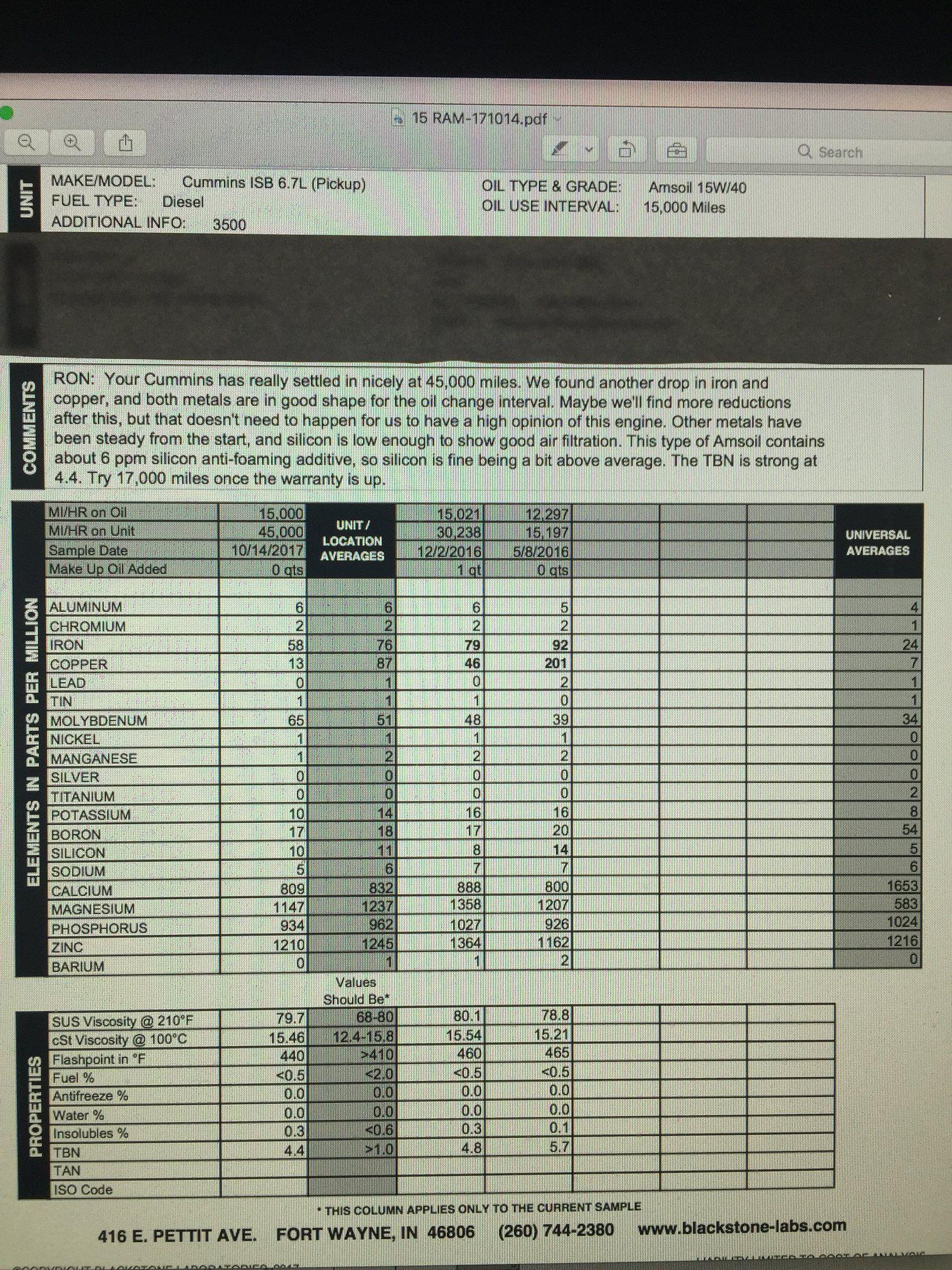

Original fill was Synthetic. I think I was about 5k when I went to AMZ/OIL 15-40 and since changed right at 15k with excellent results from Blackstone. I will be testing again October at 60k.

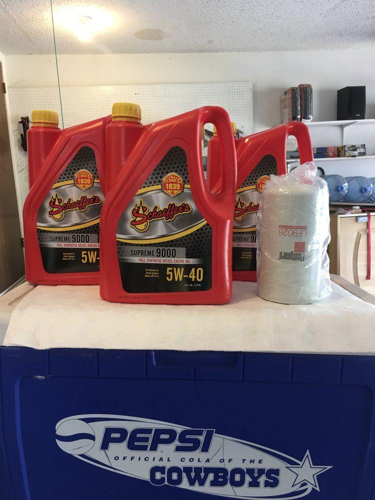

Thanks Newsa: For your thoughts & opinions.
The truth is during my visit He (Steve) took me back into the service dept and showed me the pallet of T6 they used to service the 6.7L that actually show up for their free oil changes.
He also recommended: Since I live 3 1/2 hours away and would be doing my own oil changes to use either of these 2 oil filters.
1. Fleetguard ES LF9028
2. Fleetguard Stratapore
I have 3 of each in my garage cabinet.
Thanks again.
This is the combo I have in the crankcase now!
As long as the jobber will keep HIS prices down I will continue to use Schaeffers.

View attachment 108241 Thanks Newsa: For your thoughts & opinions.
Thanks again.
Was looking at Schaeffers, interesting product. Did you do any research or comparisons? Or do have history with their products?
